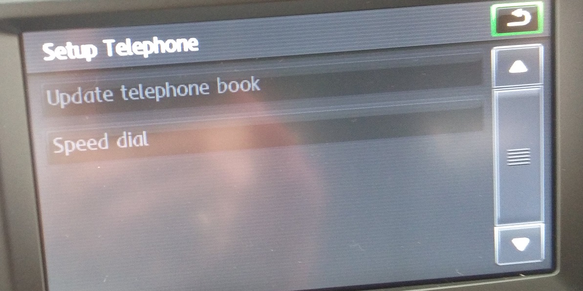

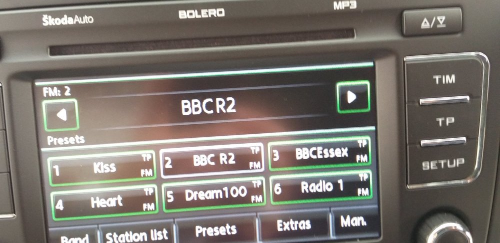

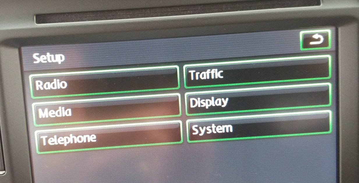

Ok, had another look at this last night.. Its a Samsung Galaxy S5. It  goes through the pairing process , gives code to pair with the head unit, but fails to connect every time.. Have attached screens of the head unit and you can see that when in set up telephone mode, the other bits are "greyed out"? Is there a simple fix for this, or is the phone not compatible, or is it a trip to Skoda to sort?

Try from the steering wheel controls. Press the right hand button and use the scroll wheel to select telephone on the Maxidot display in the centre of the speedo / tach dials. Is there an option to setup New User?
If not, I suggest talking to a dealer. It may need a reset of the head unit to get rid of the current user and I don't know how to do that. Anybody?
Doesn't it appear on the maxidot to sync
All sorted now.. It was to do with the Maxidot display.. The destructions in the user guide are not particularly user friendly but now sorted.. Thanks Freedie!!
