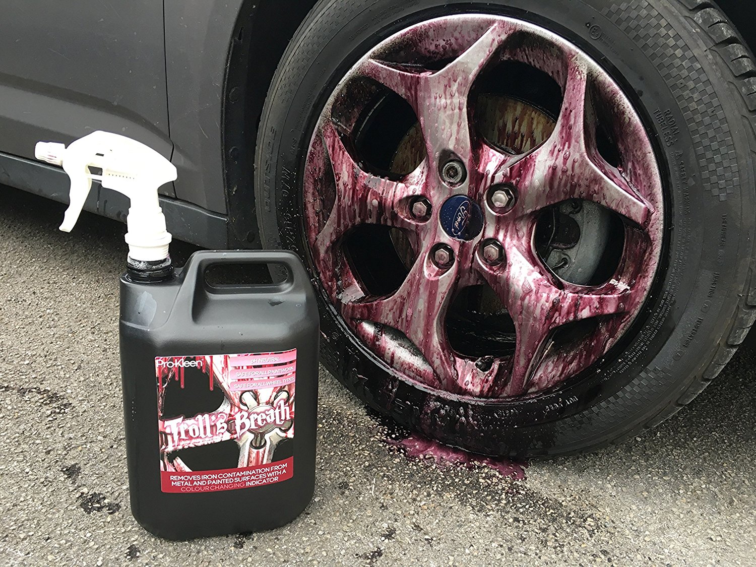

This stuff stinks (hence its name I presume) but works really well, and more importantly for me isn't expensive...
