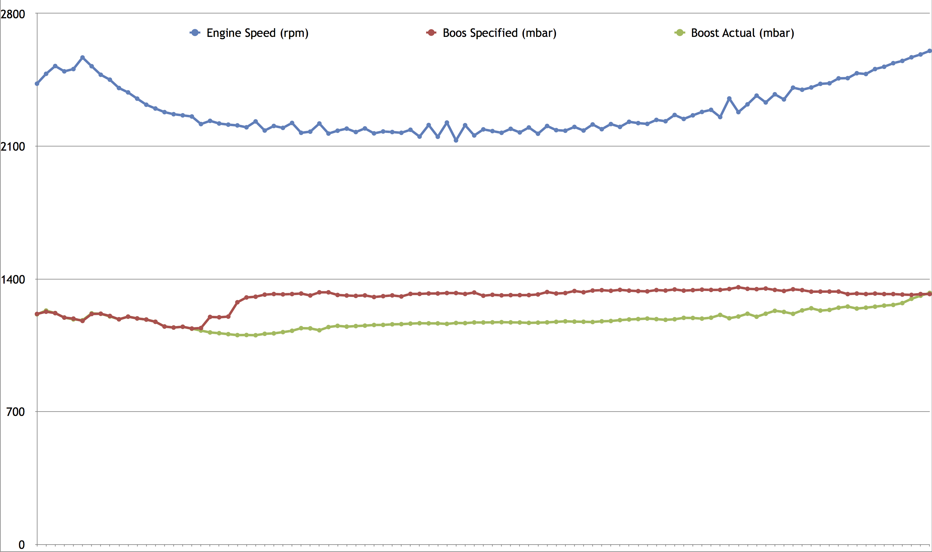

When driving it jerks around, it's hard to describe but its like a new driver kangarooing when pulling off, but only this happens at around 2,000 rpm.
It's a PD170 with the DPF removed and remapped.
Below is a graph of a log I done in VCDS showing rpm, specified boost and actual boost. You can see the erratic rpm but at the same time the specified and actual boost migrate from each other.
My initial thoughts are a sticky actuator, there aren't any fault codes and we haven't experienced limp mode.
Any help or advice appreciated.

Dodgy remap?  Did the car come with a warranty for the remap?

No, we bought it privately too. It mainly happens when it's cold, which is why I thought it may be something physical.
Hello, have you had the fuel filter replaced recently? Mine's a CR vRS as opposed to a PD and is non-mapped with a DPF but I experienced a bit of hesitation under load recently and the garage told me that the fuel filter can often be a culprit. Changing the filter seems to have sorted it.
Might be worth a look ..?

Good luck with it - the other thing it might be conceivably is the airflow meter, anyway, I'm sure they'll be able to suss it for you.
