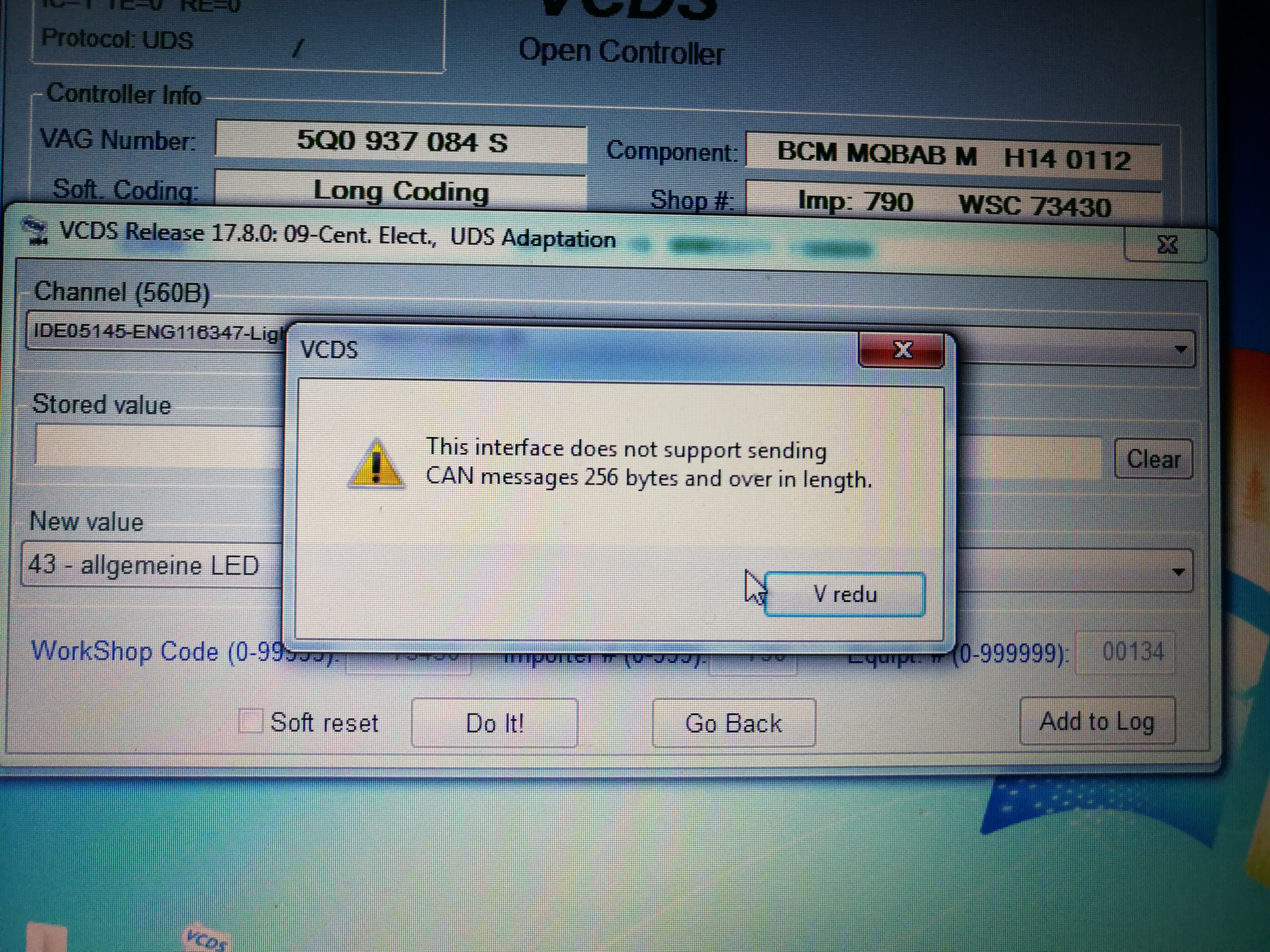

i have Octavia 5e 2013 model, and when i try to set number plate lights to LED, i got this error using HEX-V2 Dual-K & CAN cable. I am using VCDS Release 17.8. Is maybe problem with VCDS version? Should i upgrade to newer one VCDS 18?

Here i uploaded image. I have tried to update to a newer version but still the same problem.

That's because you're using a HEX-USB+CAN lead - which has run out of code space to be able to deal with the longer CAN messages on newer cars.
The only cure is to upgrade to a HEX-V2 or HEX-NET lead - taking advantage of the Ross-Tech trade-in deal.

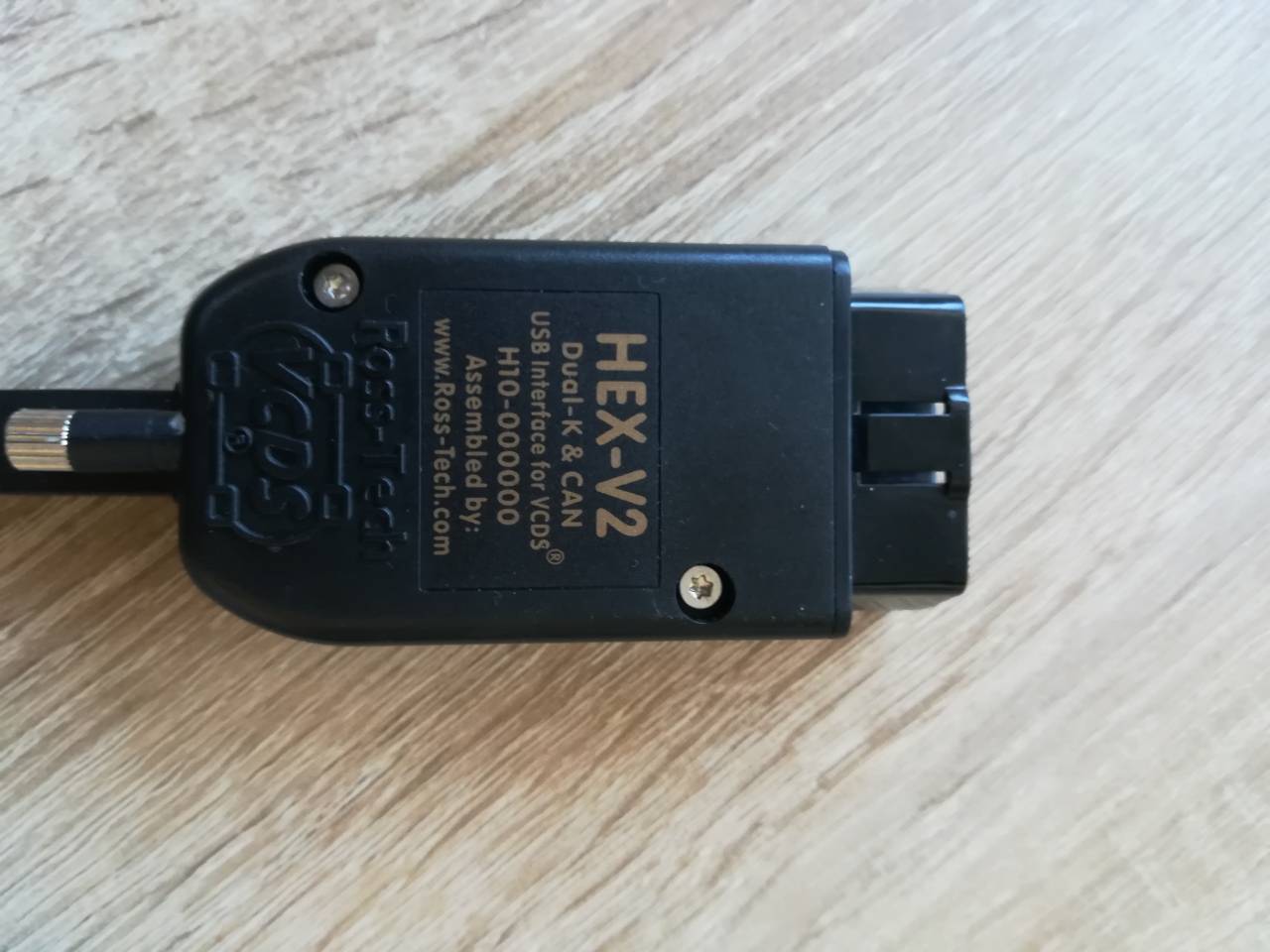

But in cable says HEX-V2.. or the seller sell me fake.. cause i bought it already usable..

Check with Ross-Tech (the manufacturers of VCDS and genuine cables), they will tell you if it's a rip-off copy or genuine.
Email them at [email protected]
