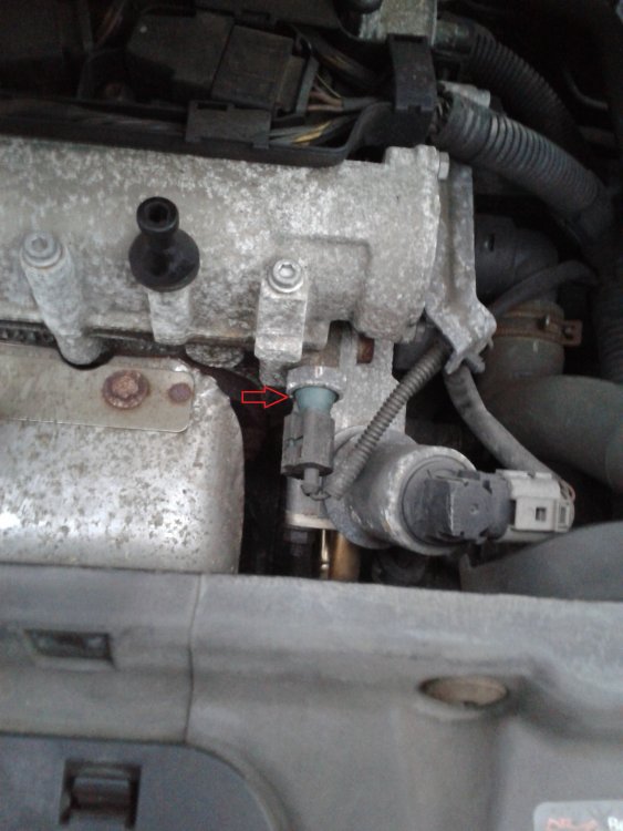

Not sure which of our cars/engines this shot is of, but it's pretty much in the same spot on both.
Many thanks - tho' that looks like the 1.4MPI engine but I'll check. The workshop manual drawing makes it appear to be on one end of the engine - this one in the picture actually faces forward.
Could be that I haven't seen the wood for the trees!
Now the rain has stopped I can have another look!
  • Sponsor
No, it's definitely not MPI, it's my 16v 1.4, I just looked.
