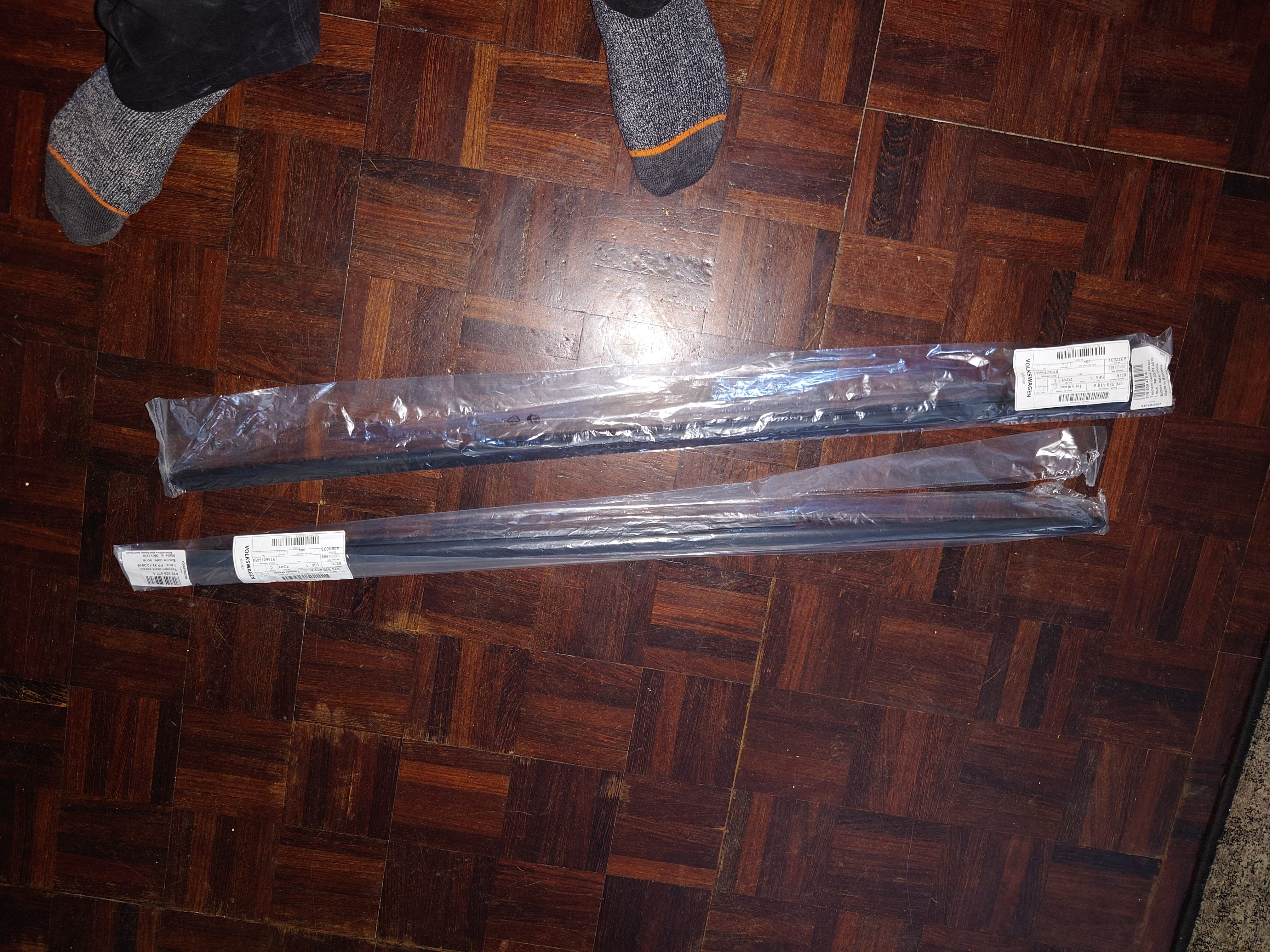

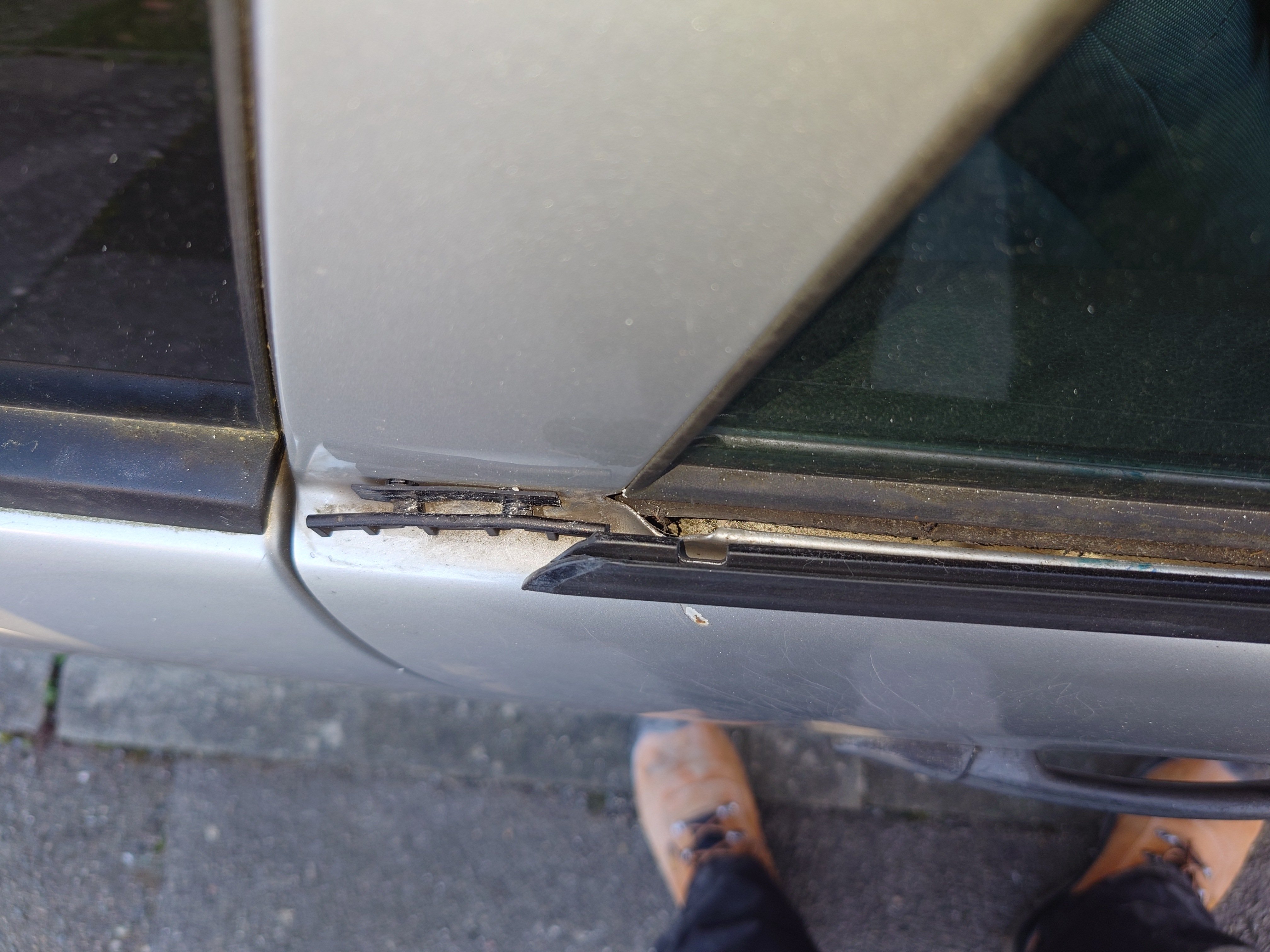

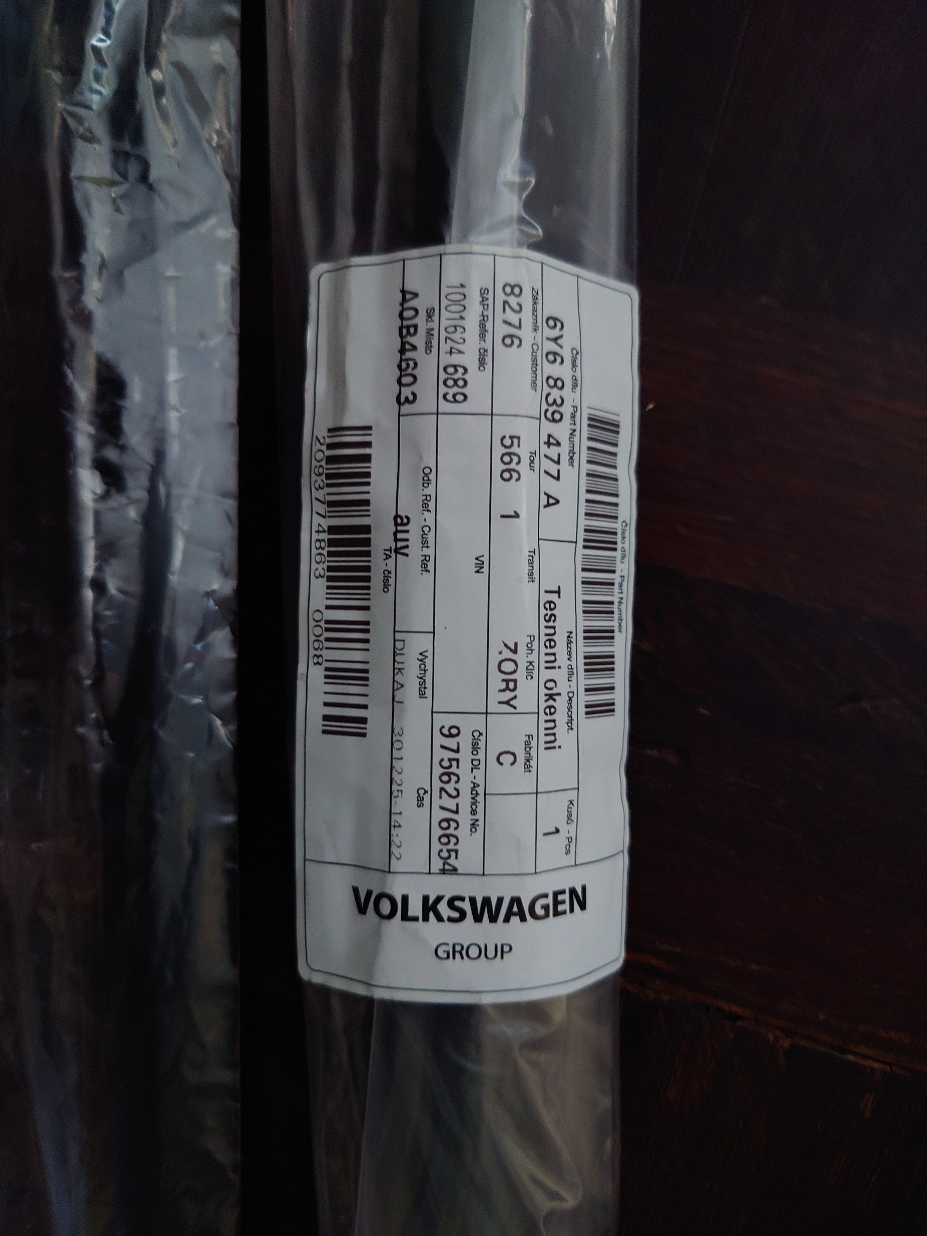

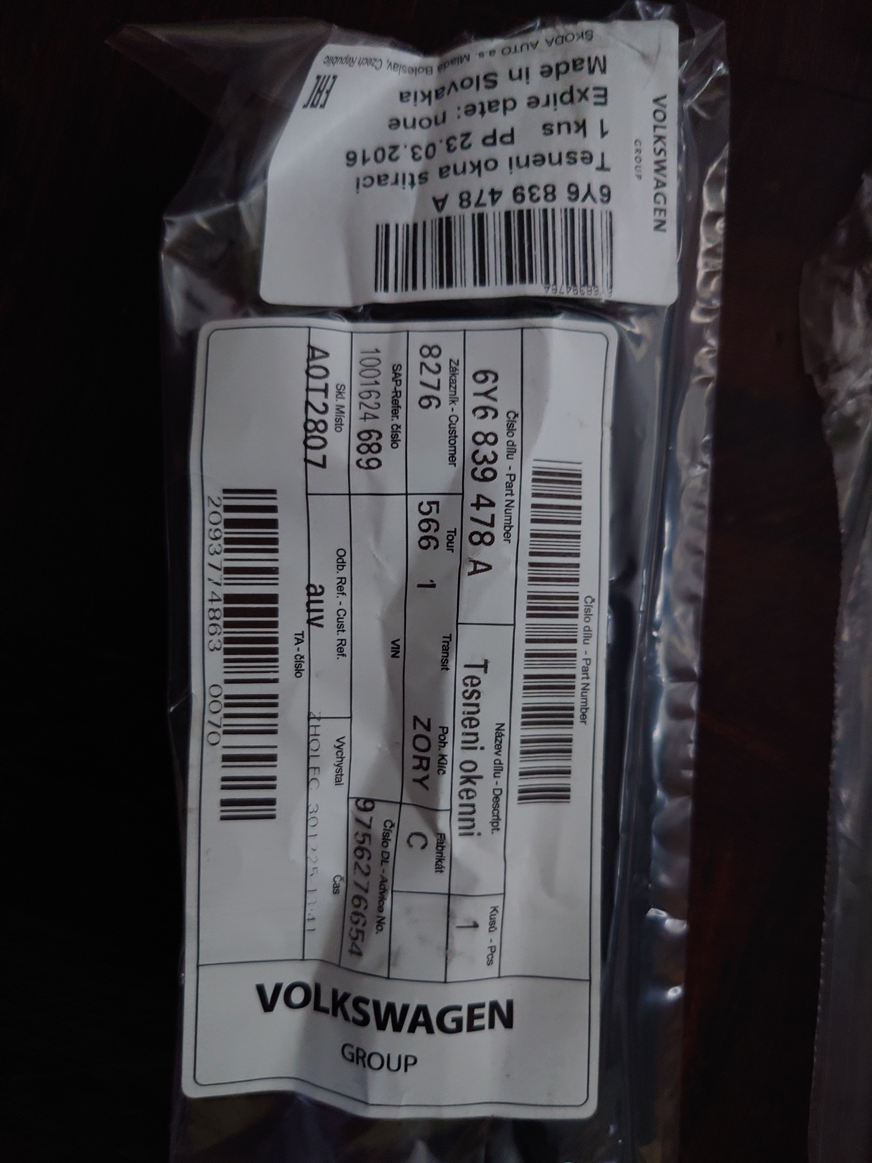

  3. I recently bought two rear door outer window trims for my partner's MK1 Fabia estate and they arent long enough! By about an inch or so. Part No. 6Y9 839 478 A 6Y9 839 478 B How can this be? Are estate rear door windows different to normal hatchback??! I've seen slightly different numbers listed but no obvious differenciation for estate/hatchback 6Y9 839 477 A 6Y9 839 477 B Can anyone solve this for me please, I'm stumped. Pic shows a lefthand trim against a right-hand door, but the length is the important bit!

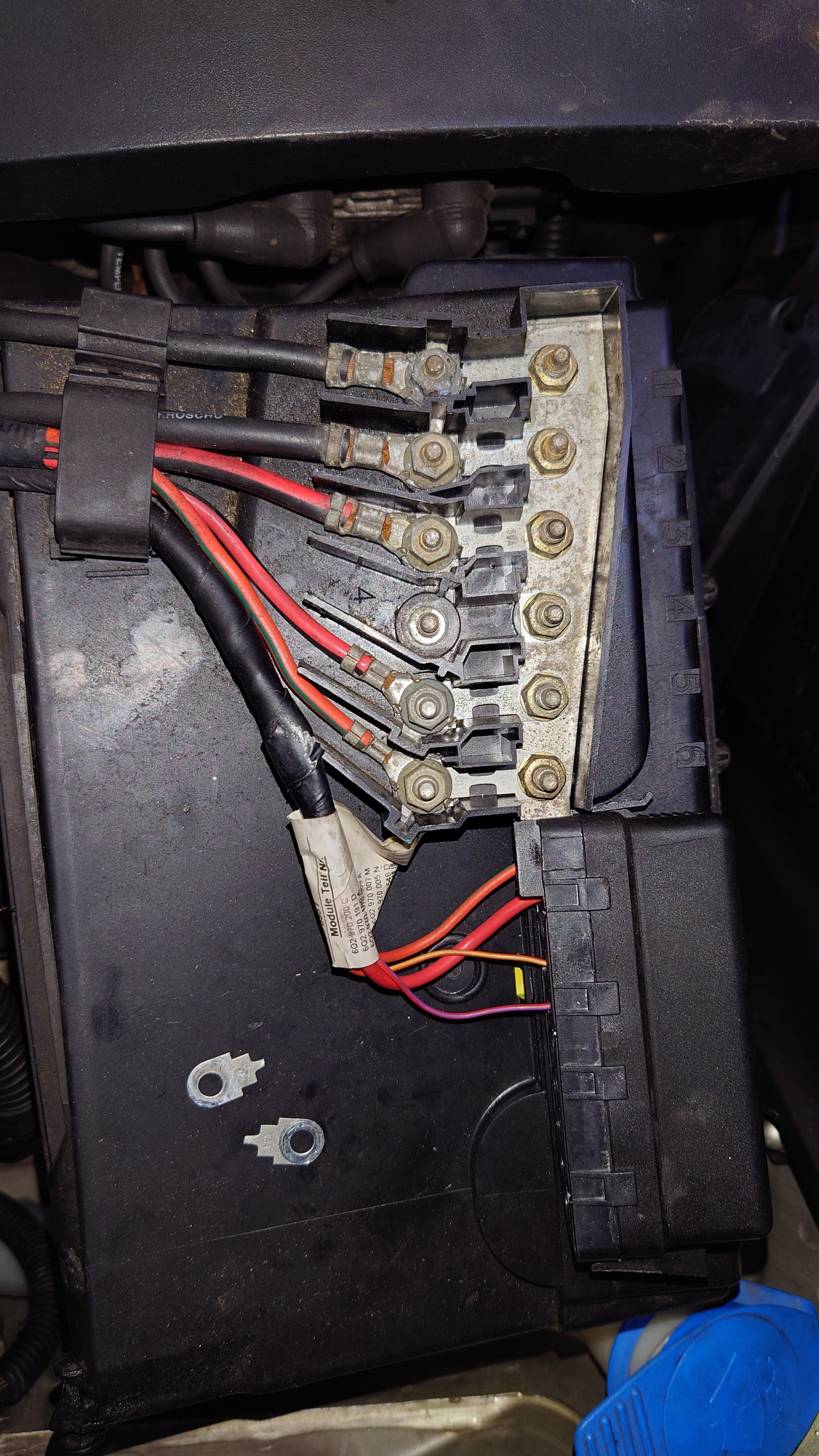

  4. Thanks chaps, my other half overheated up in London yesterday evening and on the phone I worked out there was no fan running. She got home okay after the traffic cleared and she could do 30mph unimpeded. I had a look after work today and found the link fuse above the battery had continuity but a very faint looking crack, removed the nut and it fell apart, quick swap with the adjacent spare and job's done๐Ÿ˜Ž๐Ÿ‘Œ

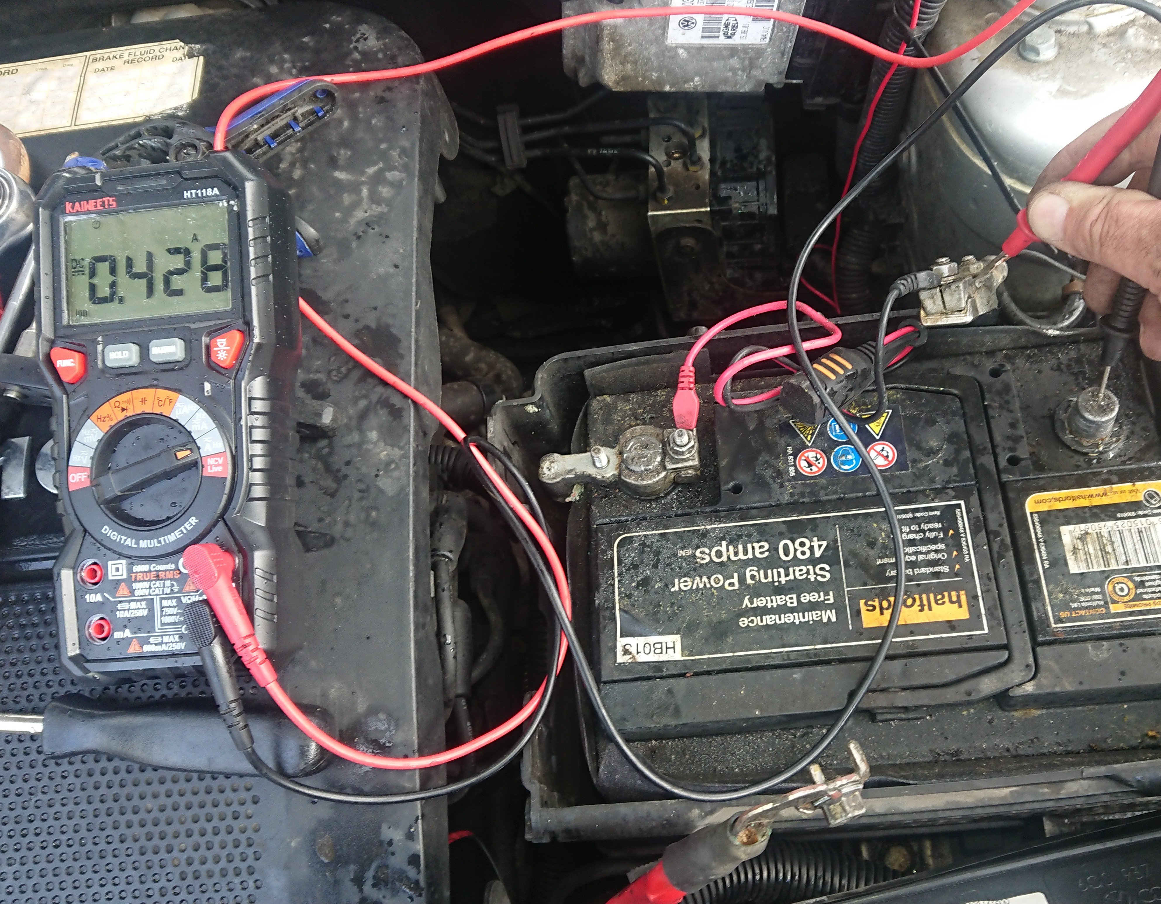

  10. So finally got to check for parasitic drain using the multimeter CORRECTLY and look at that... No drain ๐Ÿคฃ๐Ÿคฃ Battery on 12.35v, turn key to illuminate dash lights and voltage plummets by more than 2v. Ain't starting anything like that! New battery it is, cheers for the Tanya link nta16 I'm aware of them ta. We have a great place in Tovil/Maidstone, SE Auto Electricals which have always be very reasonably priced. I'll be popping in this afternoon I think! Cheers for all the comments/help, if nrw battery doesnt sort it I'll be back ๐Ÿ’ช๐Ÿ˜Ž๐Ÿ‘

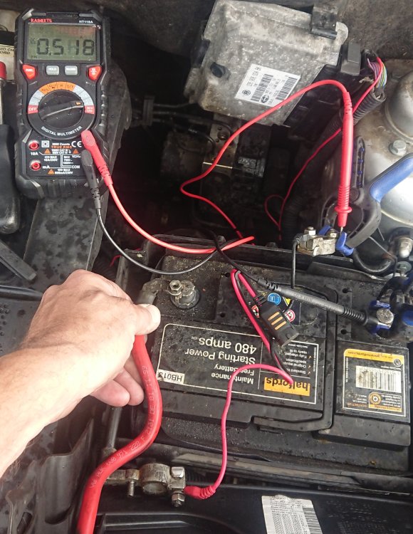

  13. All that said and done when I removed the main cable to the panel on top of the battery and keep starter connected there's 0.428a drain... I then removed the STARTER cable/terminal and reconnected the top panel cable and I still got a 0.518a drain so I've still got a massive drain with either cable separately connected!?!?! It makes no sense to me.... Especially with a fried brain at the mo!! ๐Ÿ˜‚ N. B. The 2 thin red and black wires are just to a CTEK Charger plug

  15. Well this is doing my head in a bit. Battery @12.55v a) everything connected = 0.51a drain b) ALL the strip fuses and blade fuses in the battery case disconnected = 0.44a drain c) main +ve cable from battery to rest of car disconnected, alternator cable connected to battery but removed from alternator = 0.44a drain d) alternator cable reconnected to alternator but cable/+ve terminal removed from battery and main car +ve cable reconnected drain = 0.51a I was thinking there was a short somewhere along the alternator cable from the battery as it doesn't look like a diode issue (?) but the drain goes back up with everything else connected instead of that cable!?!?! Am I missing something obvious? Its not helping today's general malaise, I should have had my feet up watching TV with warming drinks all day not messing about in and out of the rain chasing this in bloody circles ๐Ÿฅด๐Ÿ™„๐Ÿฅด
