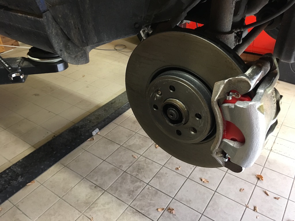

Un update on things - dragging my heels a bit due to a few other things going on, but have now plated the rear arches which were not as bad as I first thought. I have strengthened the plating around the turrets in case I end up using coil-overs although my thoughts are to go with the standard suspension now. All nice and tidy with a good coat of Hercul Liner polyurethane paint.
A reputable tuning shop near me thinks he hs found a little used 1.9tdi with box, ecu and wiring loom etc which he reckons he can easily install and
 map to get 190bhp. Owner is holding out to sell apparantly so the price is currently pretty high!
Have been playing around with brakes and think I might go down the Scenic disc route - in fact I think I have to due to all the parts I have bought now! As you say, it certainly fills my 15" wheels - after some judicious metal removal though, it sits inside quite snugly now with maybe a quarter inch gap... wish I had got 16" in hindsight!
To mount the Mondeo calipers, I did not have to drill out the Skoda mounting holes - they were already 12mm - was this a change maybe in later models (mine is 2001)? I had to mill spacers to extend the carrier brackets - 4.6mm (although I am sure I could have used quality washers instead) and all tightened up with new 10.9 bolts, a tidy set-up! Thanks very much for getting me started!
