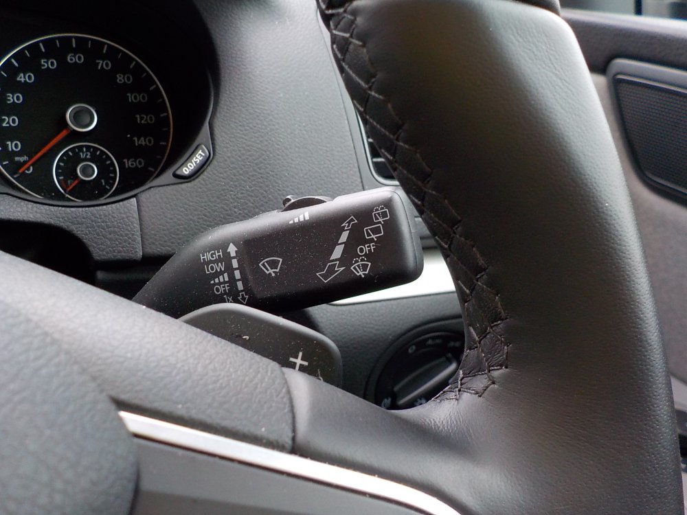

The wiper switch has 4 positions. Off, intermittent/auto, normal, high speed. When in the second position (auto/intermittent) you can alter the sensitivity of the auto by the rocker switch on the top surface of the lever.

If its anything like mine and falls asleep in auto mode, bump the sensitivity up a notch till it wakes up and then down a notch again

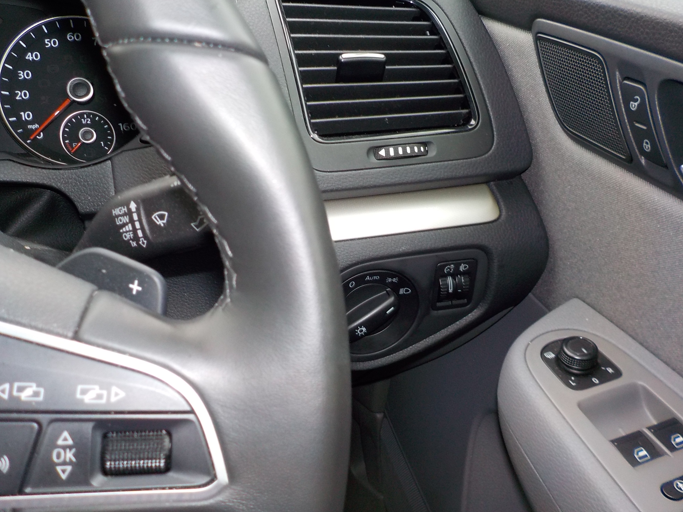

In the Seat, you'll need to turn the knob near your right knee away from "A" or "Auto" to turn off auto lights. Can't understand why you wouldn't want it though. It's a very useful safety feature.

LOL,surprisingly i know the knob, the one i turn the headlights on to Side and Dip so that i am not running with DRL's to the front and nothing to the rear, and that i turn on because i know when lights are needed rather than needing the car to decide as so many do leaving them running around with DRL's only on when visibility can be poor.
