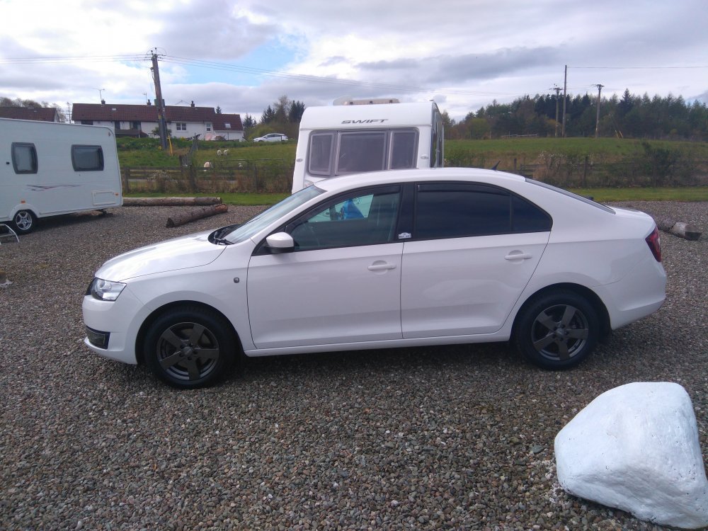

This is my old Rapid on 185/60R15 tyres. I'm sure at the time Skoda recommended both 185/60 & 195/55. I had Goodyear Efficientgrip tyres and they stuck to the road like glue but slightly worse fuel economy compared to the factory fitted Continental Eco somethings that were on it originally.
I still think that it looks pretty good with 15"s
