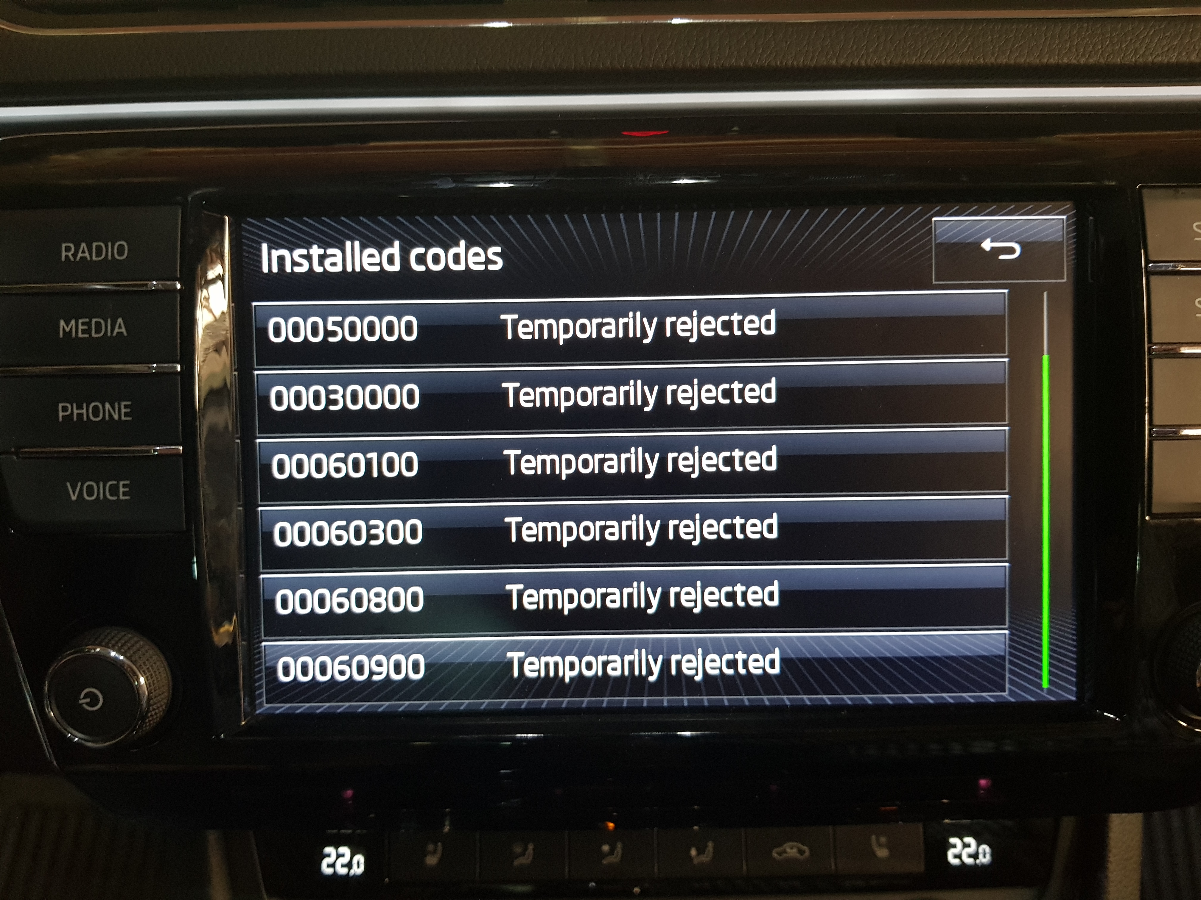

I removed my bolero infotaiment to update to columbus and returned back to origional
I made component protection removal in the dealer shop

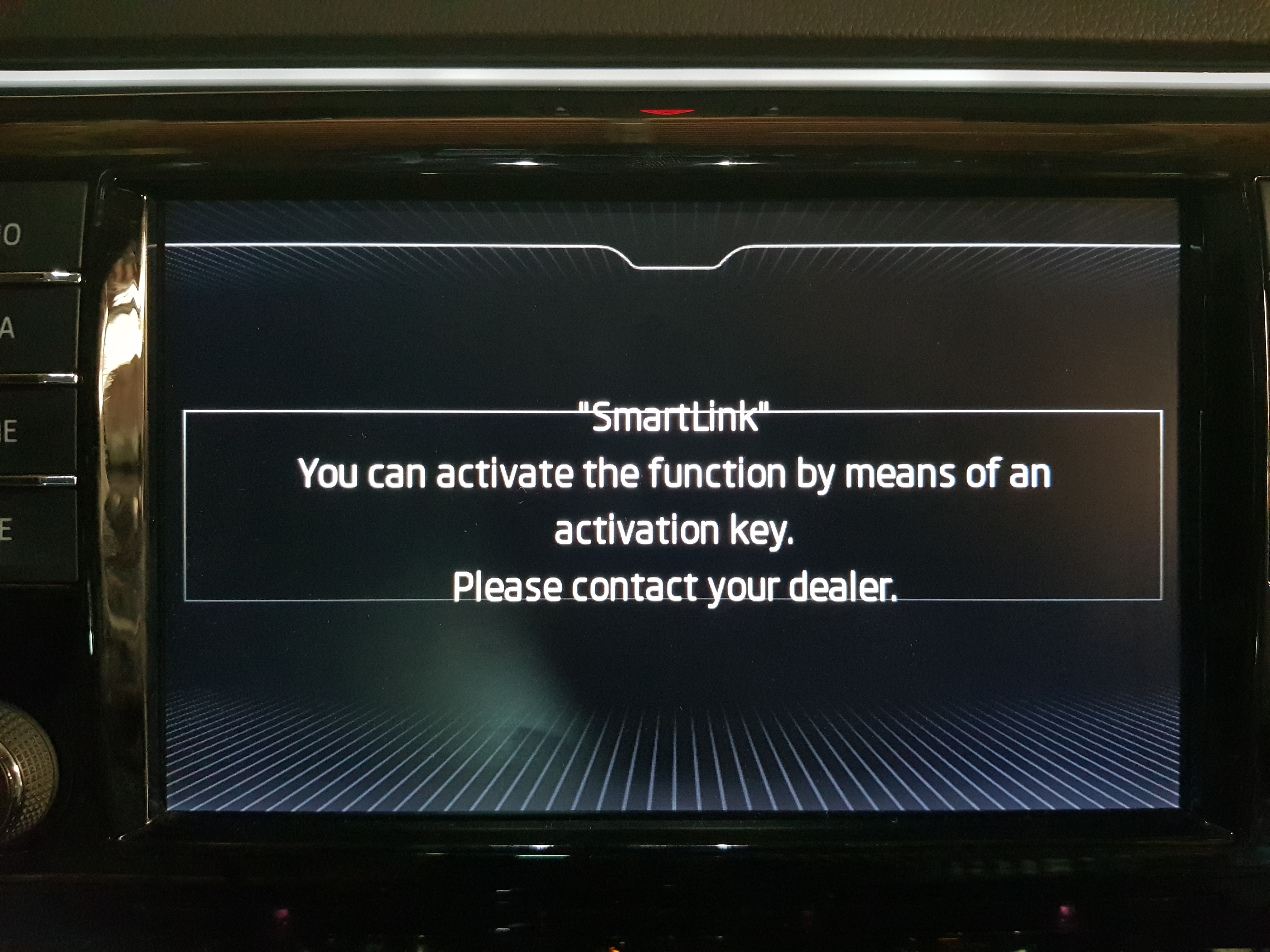

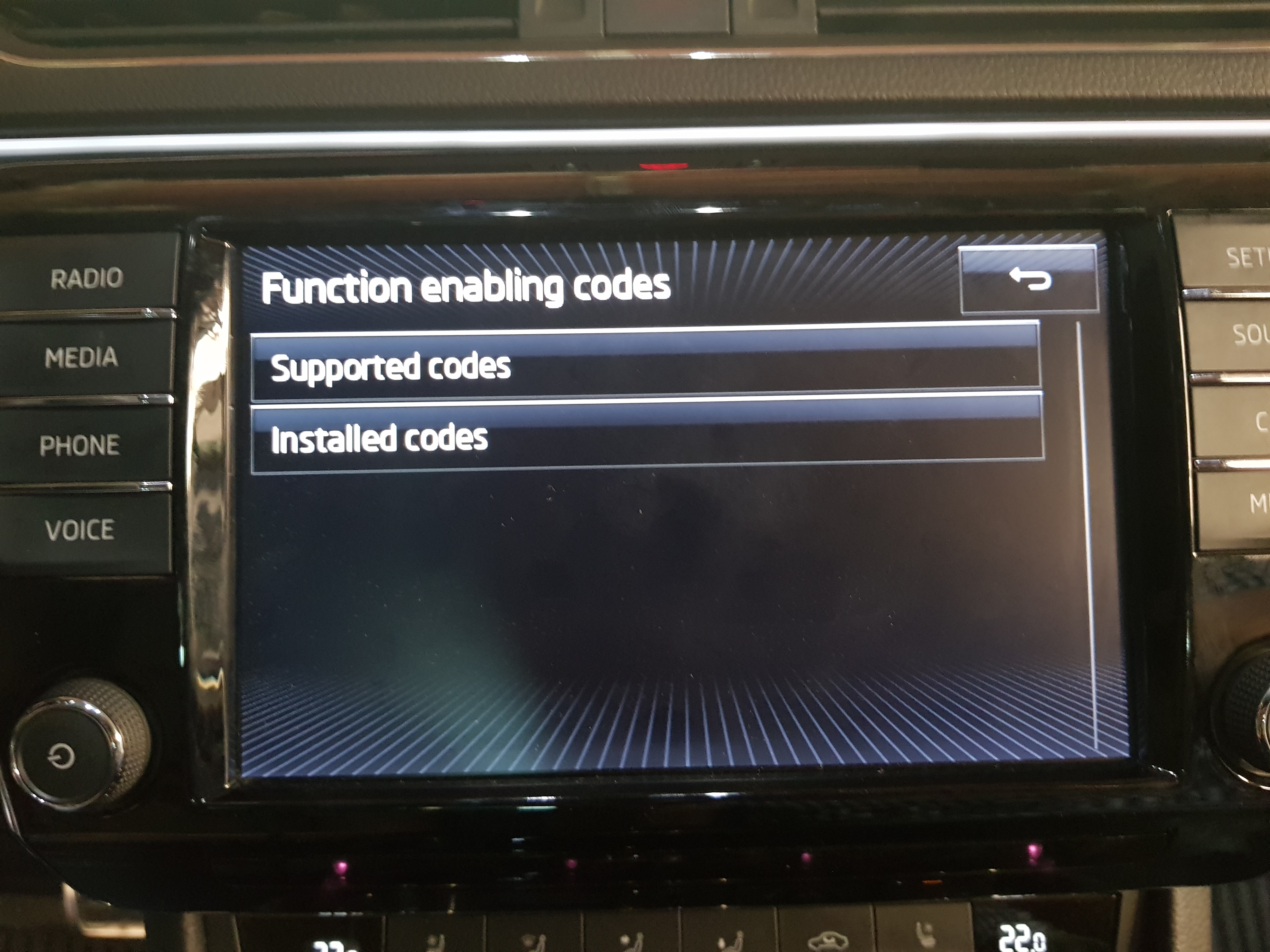

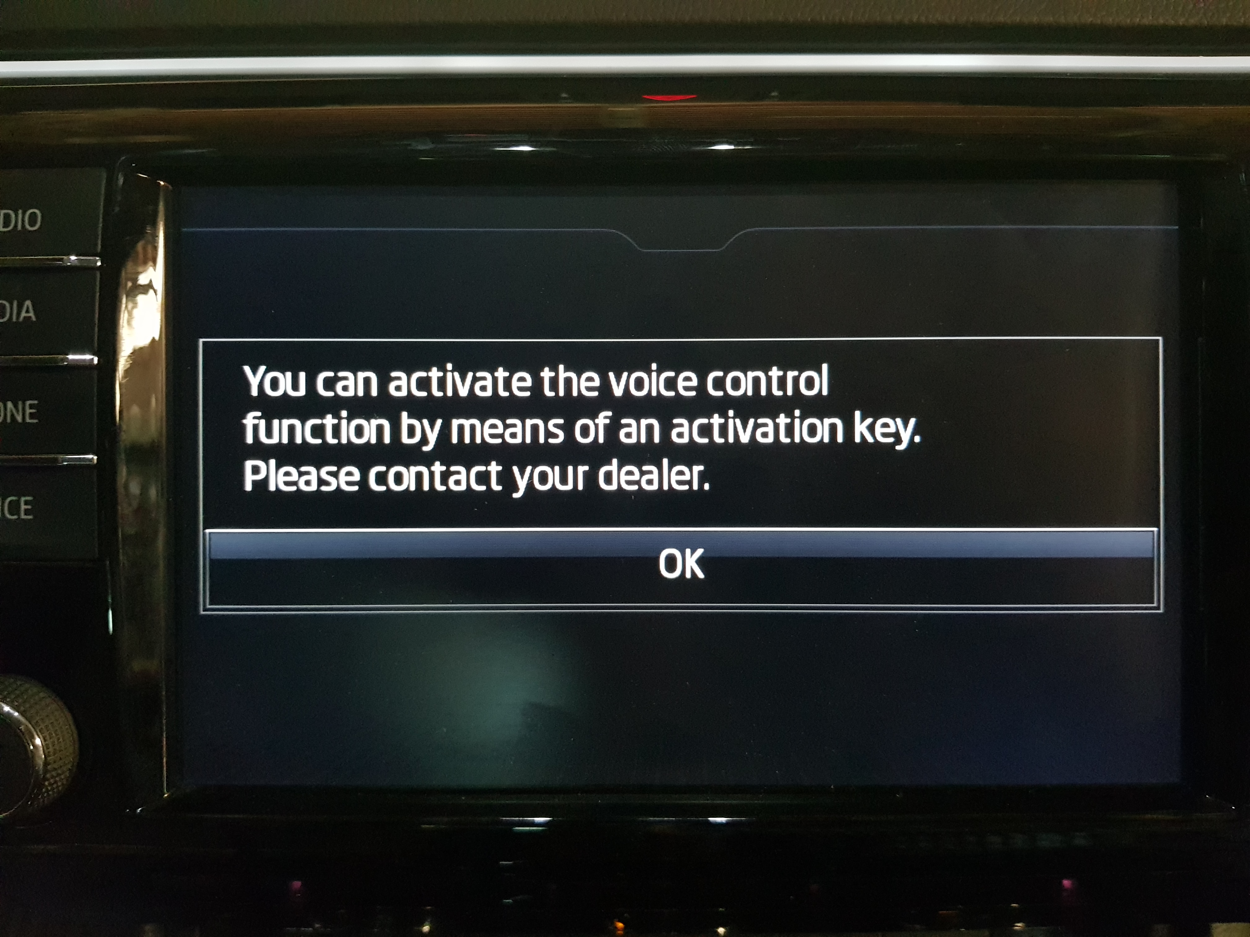

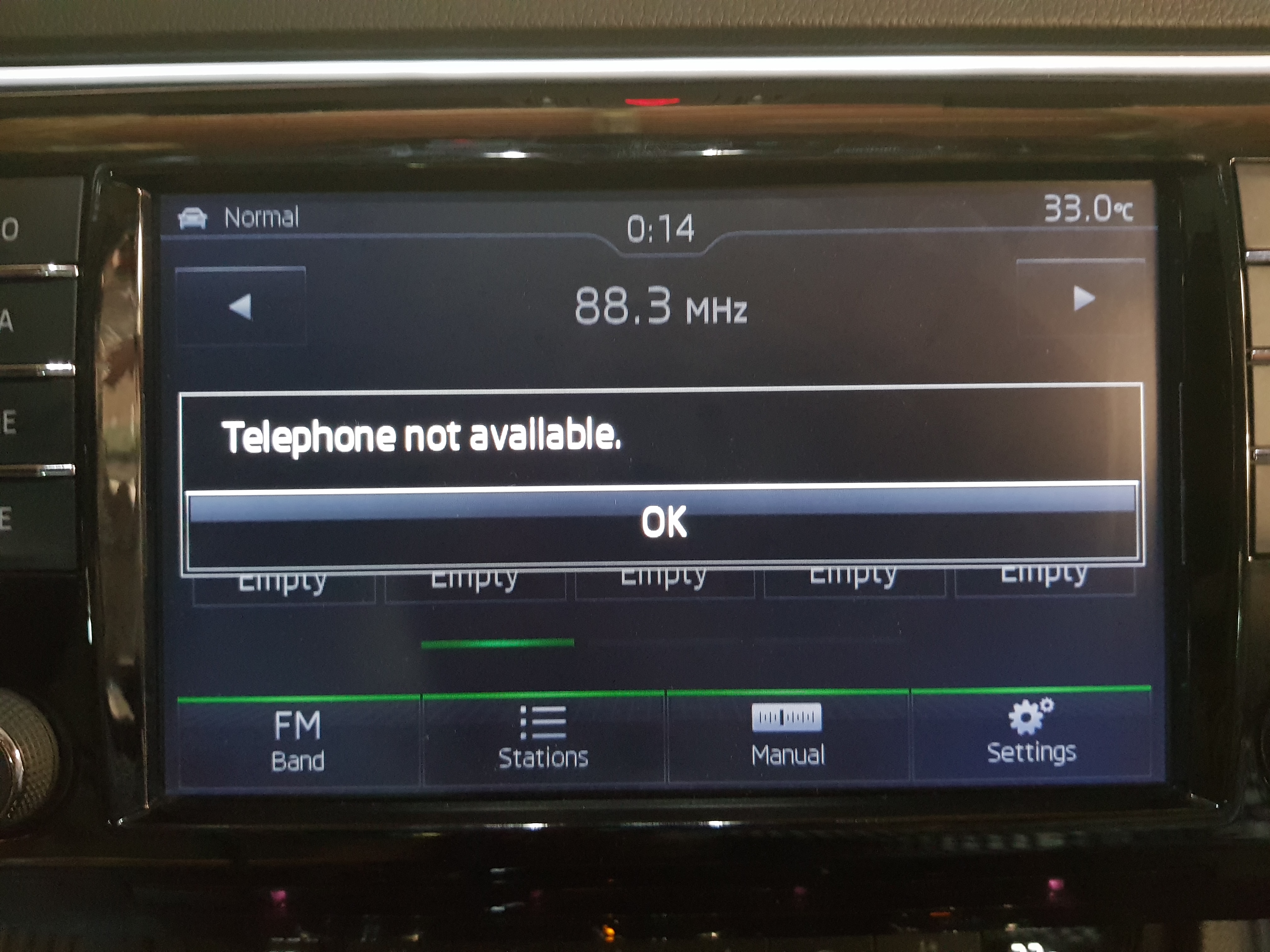

After i returned home i found these errors
Please help me to get these functions back
"I told you so" probably doesn't help you much. Removing Component Protection isn't enough, it needs to be reenabled with your VIN and only a Škoda approved workshop can do that legitimately.
The workshop needs to connect your car to the Škoda server where it will check that the unit hasn't been reported stolen. It will then provide a SWAP code to unlock the device.
Until then it's very much a brick with a screen.
