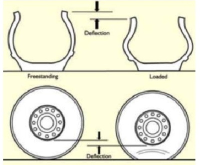

At high speed you are putting an exceptional strain on the tyre, particularly the side wall, which leads to increased deflection. This results in the tread having a larger footprint and contrary to popular belief that is not a good thing - it adversely affects steering/handling (increased slip angle), rolling resistance (more energy needed to rotate the tyre) and grip in the wet (the blocks and sipes can't compress to expel water as efficiently, increasing the risk of aquaplaning). High speed has the same effect on a road tyre as hauling a heavy load. By increasing the tyre pressure you add support to the sidewall to help reduce the deflection and thus maintain an efficient footprint.
There's an article about it here if you want to read more.
In a nutshell - for high speed driving, reducing tyre pressures is the wrong thing to do.
