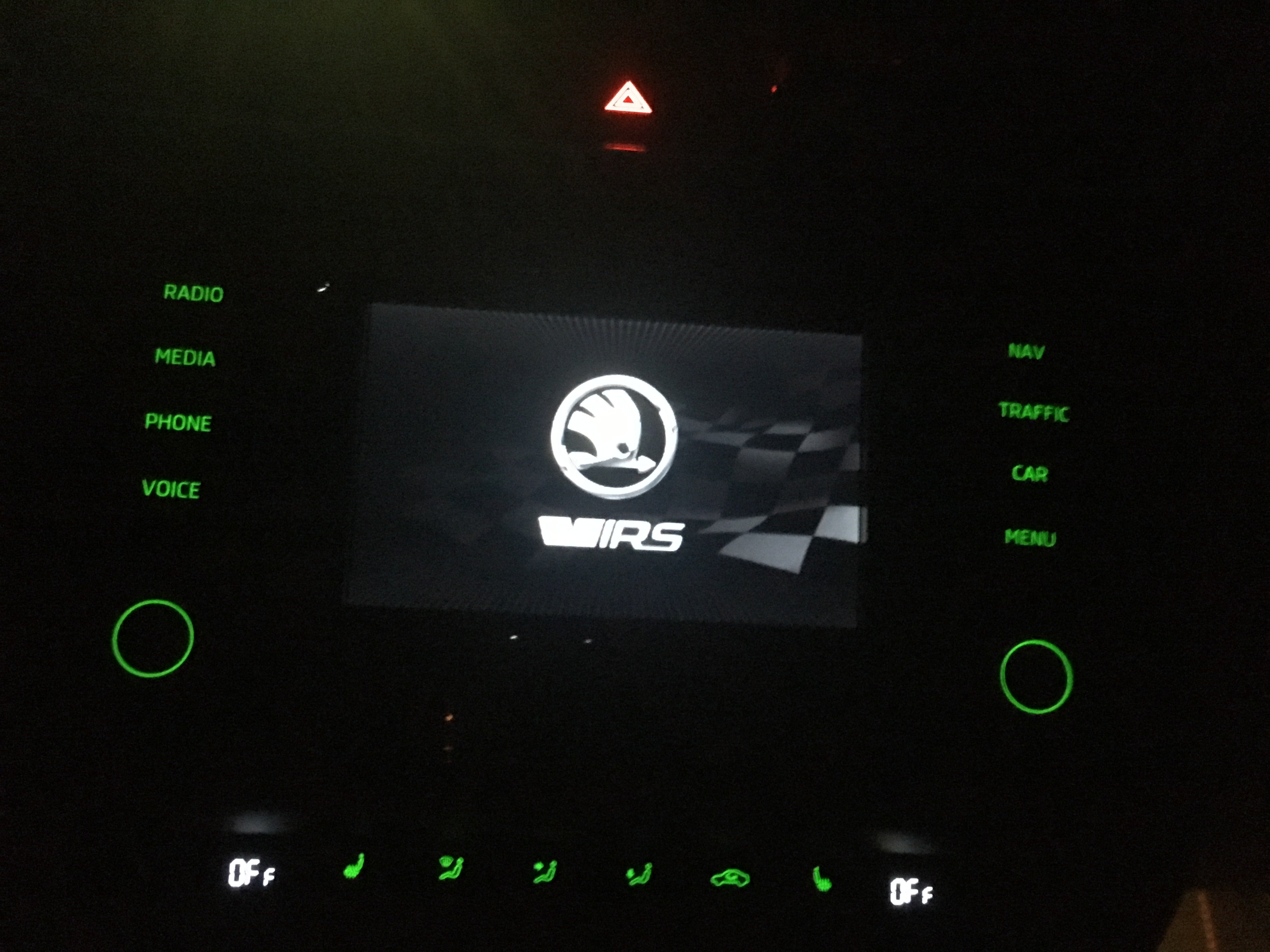

Hello i need your help, i was digging something with VCDs try to change from USB functionality to USB  and Iphone functionalyty but then wasnt reading USB. Today i try to change back like it was but radio does not work. Nothing is working and black screen sometimes with vrs logo, if i plug usb its playing usb but thats all only Volume button works , and black screen.
can anyone take a picture of VCDS programing code or where could i find it? I have 2015 2.0 tdi vrs with start/stop without driving mode. Please if anyone can help.
i also try Soft resset but its the same. I also attached pictures

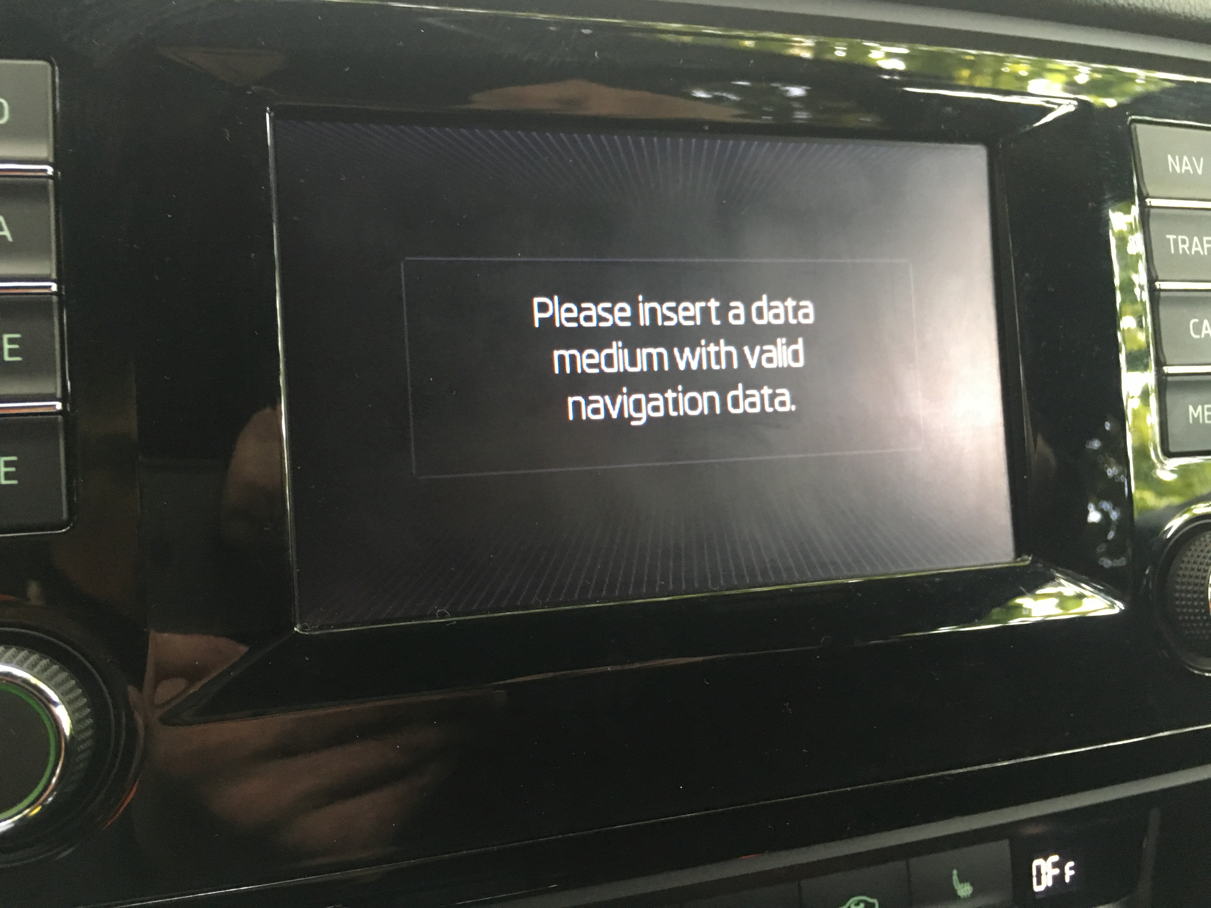

Guys thanks i try to manage so it works now like it shoul, the only problem is that i cannot use navigation it does not read SD card see picture:
I assume you have the SD card in slot one. You could try any 32GB card with the maps downloaded from the update web site
