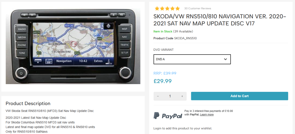

My Skoda has a ‘Navigation System Columbus’ which works perfectly, but the maps are a bit out of date. I have a vague recollection of it having version 16 installed some years ago. I’d like to update the maps as much as I can, but it would appear that this isn’t something still supported by Skoda. I’ve found this advertisement online that would seem to be right for my car:
SatNaviShop
No image preview
Skoda Sat Nav Update Discs | Sat Nav DVD 2025
SKODA Sat Nav Map Update Discs V17 for All SKODA RNS510/810 Navigation's. Get the latest 2024-2025 sat nav Disc for your SKODA Skoda Roomster, Octavia, Yeti, Superb from satnavishop
The unit looks just like the one in this picture, but before I order it I have a few questions:
A. Does anyone have any experience of SatNaviShop - is it a reputable supplier?
B. How do I know whether my unit is a RNS? The manual just says Columbus and doesn’t specify RNS?
C. Is this a sensible thing to do?
Alan
The last map version for Columbus RNS510 family was V17 so I beleive what they offer is scam... When you click the link it changes a lot:

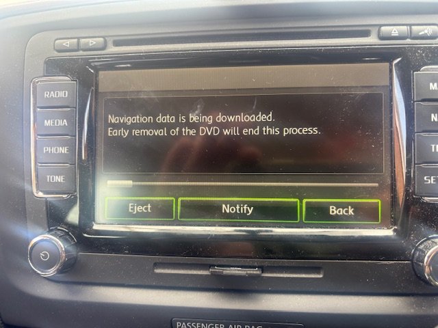

The postie delivered the v.17 map CD this morning. I understand this dates from 2021 and is the last update available for my Columbus unit.
There aren’t any instructions with the CD, but it is pretty obvious. Turn on the car (no need to start the motor), insert the CD, press ‘continue’ a couple of times and eventually get to a screen asking whether the maps on the HD should be replaced, or run from the inserted CD. I chose to replace the maps… then wait an hour or so (which is what I’m doing this whilst typing this, and listening to Smooth Radio).
There is a comfort screen, activated by touching the ‘eject’ button (this was about 5 minutes into the update):
I’ll let you all know whether the process worked in about another 30 minutes.

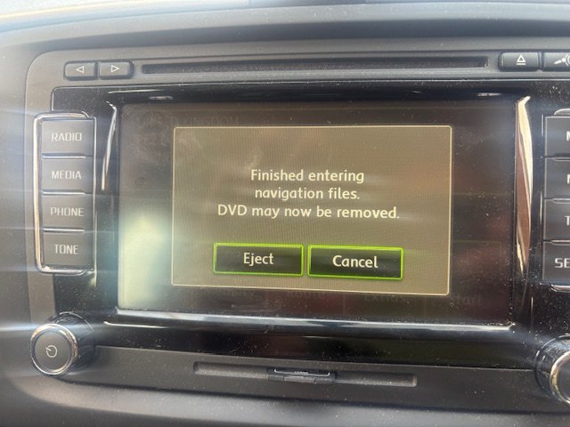

This will probably be the final post in this thread. After 55 minutes this message appeared telling me the process was done:
Everything seems to have worked fine, the map version has changed from 8536 to 8557. I don’t know how much of an improvement in detail that will give me.
