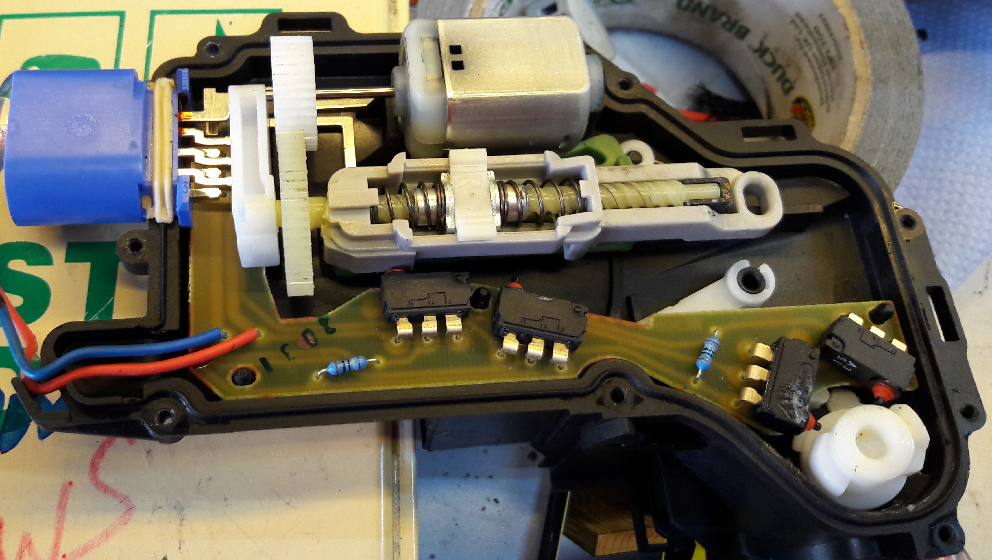

For what it's worth, these locks have little d.c. motors and gears in them, not solenoids. Two microswitches right in the middle of the pic detect the position of the gear-driven shaft, the ones in the bottom right signal the key being turned anti/clockwise. Red and blue wires on the left go off to the 'door open' microswitch.
Suitably corrected. Motor not solenoid.
So the microswitches. The one out of the picture left is out of the equation. Plays no part in the unlocking although it will report door handle movement to the module .
The two bottom right work fine as the door unlocks normally with the key so also out of the picture.
Leaving the two in the middle as the only possible culprits. But VCDS is correctly reporting conditions of 'safe', 'locked' and 'unlocked'. Suggesting that they too are correctly reporting lock position to the control module.
I wonder if those conclusions are correct and this is down to a confused control module?
Don't know the job of the second white plastic bit on the right or the green bit behind the motor.
