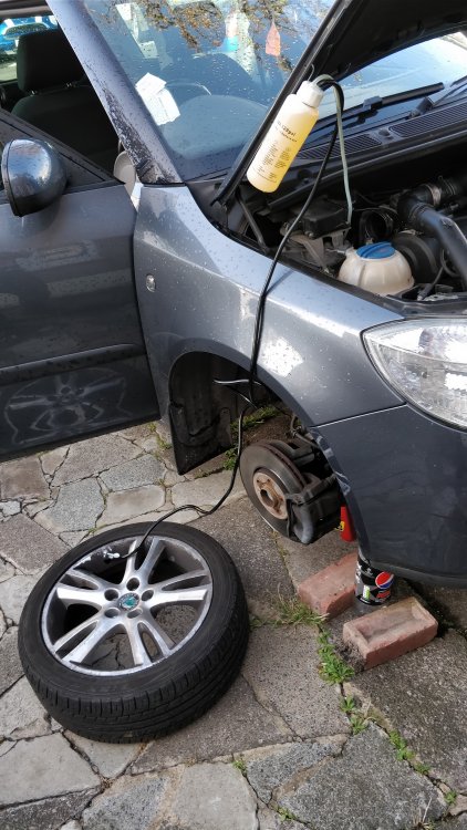

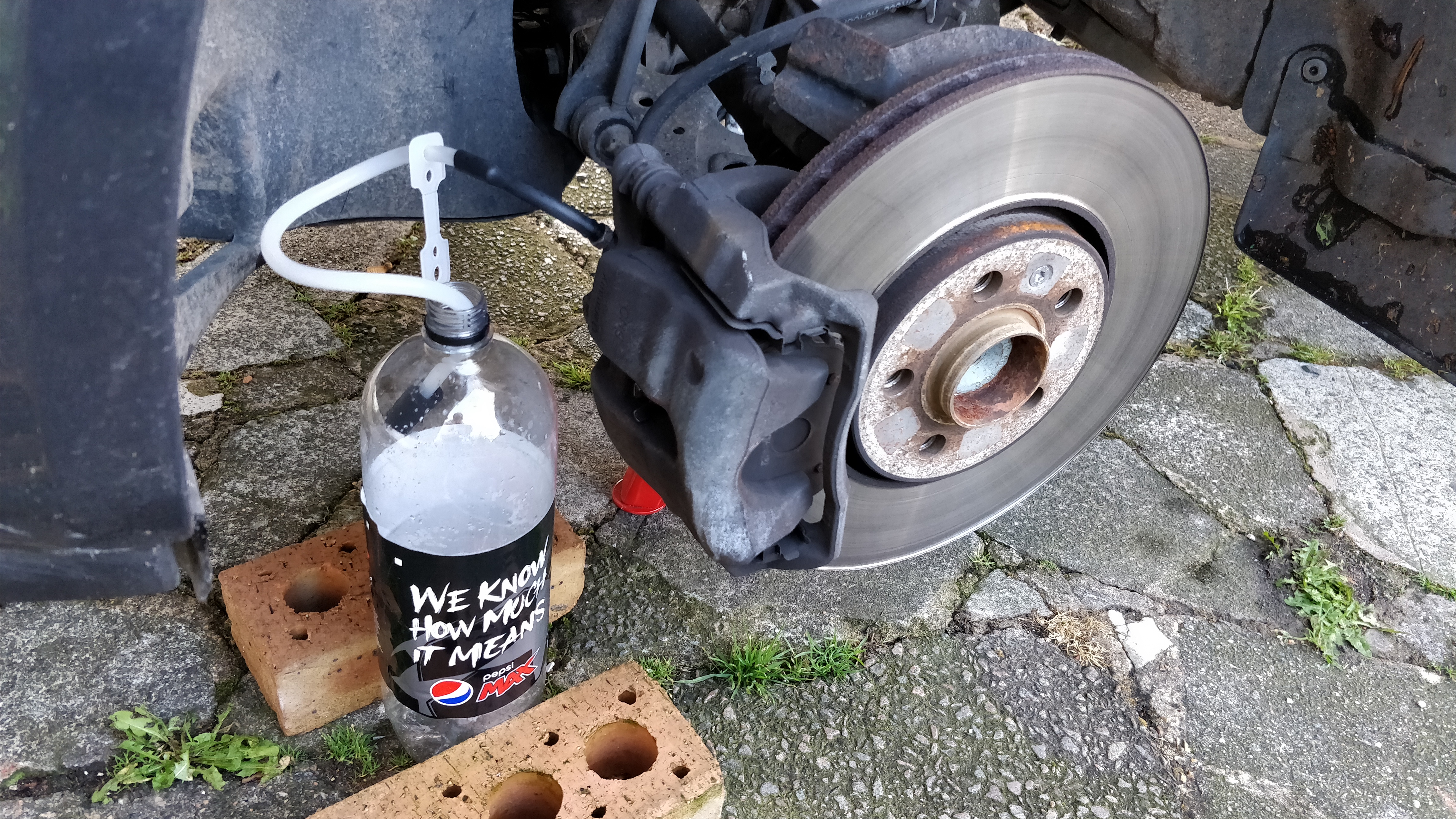

After more digging I have now successfully completed this procedure. So for info to others to perform a full ABS Bleed on my 57 1.9tdi Roomster with Bosch 8.0 ABS using VCDS, it is Open Controller ABS (3) - Basic Settings - Group 10 and Go.
You need to have All 4 bleed nipples accessable because the procedure requests Open and Close RL+RR as well as Open and Close FL+FR. So not as loads of other guides that state the ABS bleed is only front nipples. So to make it simple I had all 4 wheels off and the car on axel stands, with a one way bleeder tube going into a big bottle at every wheel. I also used my easybleed to ensure I kept an eye on fluid level too. Difficult for just me, If you can I would recommend a few helpers. Perhaps 1 on fluid watch/top up, another for front nipples and a 3rd for the rears. I must of gone front to back to front etc about 4 times. I'm not actually sure if I completed the full procedure as VCDS said partial bleed complete and then seemed to time out in the end and I just had N/A repeated in the 3 boxes. But my pedal is much firmer and it has just sailed through the MOT, so that will have to do.
