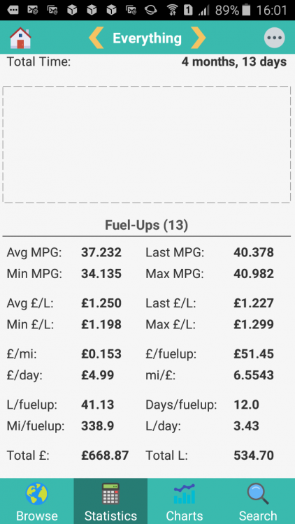

My girlfriend recently bough a brand new Yeti SEL Drive 1.2 TSi with DSG. The car has done over 3000 miles so can be considered run-in. She is happy with the car apart from the fuel consumption which is terrible. We have been measuring the fuel economy since new using Fuelly and it's averaging 28-30mpg. The car has been run on regular 95 unleaded from the supermarket, and we are trying a couple of tankfuls of Super to see if it makes any difference.
As I see it the car seems to change down unnecessarily and never takes advantage of the torque that this engine has  -using cruise control at 70 in 7th gear and as soon as it hits a hill, the car changes down to 4th. I'd be interested to hear other people's experiences

  • Update on fuel consumption in 17 plate 1.2tsi dsg with 5000 miles. Lifetime average is 39.5, most recent fill to fill was 41, and mfd shows 41.5. As a lot of my journeys are 5 miles in and out to the

A full tank (50l of fuel used I reckon) gets me about 320 miles.
It changes up like so - 4th gear at 20mph, 5th at 25 (going downhill) or 29 on a flat road (RPM would be at about 1400 at this point and the car would feel okay) 6th at 32mph (car would feel to me like it is labouring, the engine note is much lower and the car vibrates upon acceleration) and then 7th at 39/41mph. However, the car will hold 7th gear until 35mph and it feels like it is really struggling.
