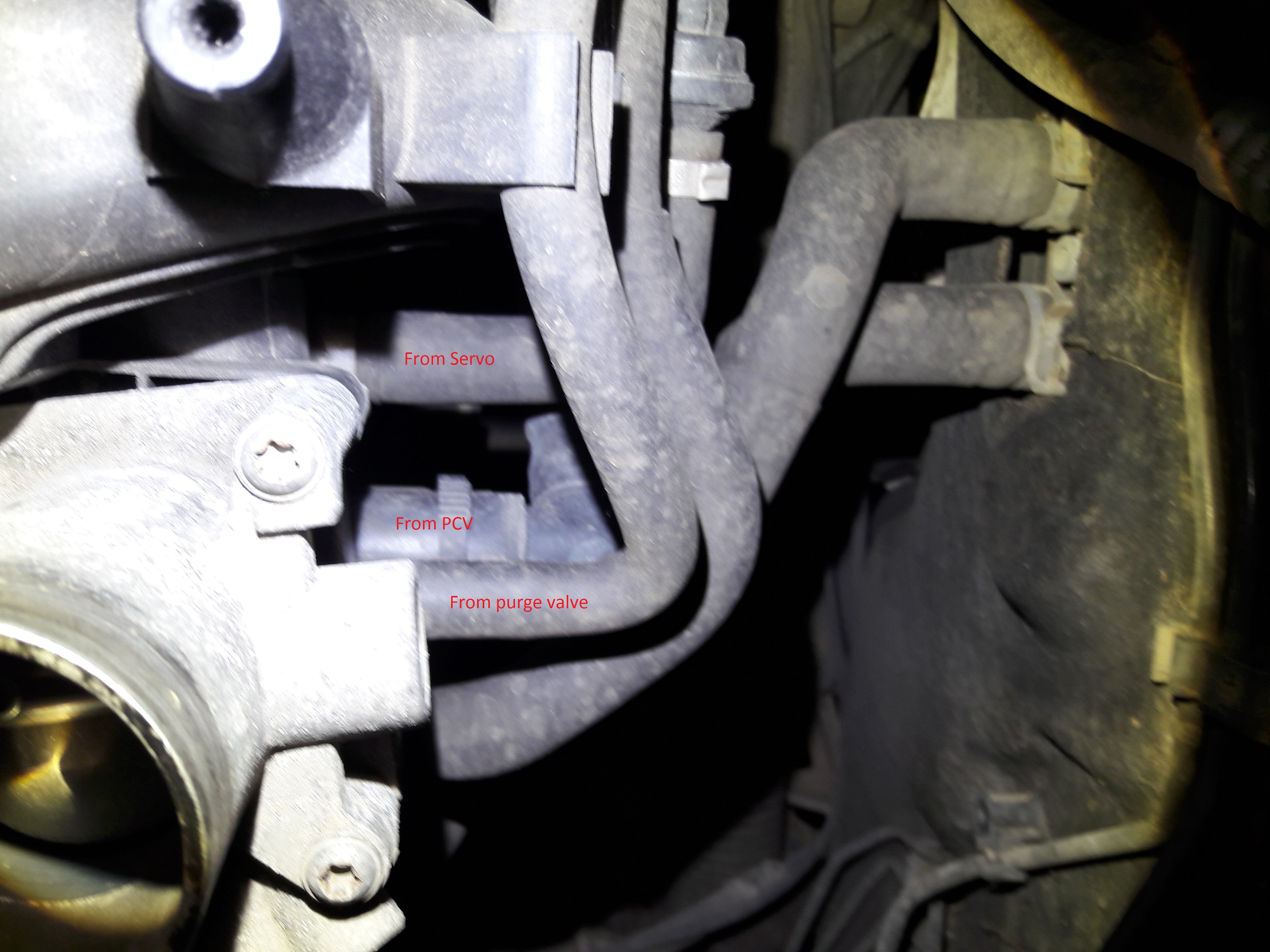

EGR, PCV, purge valve and servo line all feed in below throttle on my BBY, I'd imagine BBZ would be same?
Hehe, just noticed my servo line has split, just servo side of the non-return valve, top edge of the picture. Thanks!
Edited by Wino
Mine was split in exactly the same position but has been repaired. See previous pic in my EGR thread.

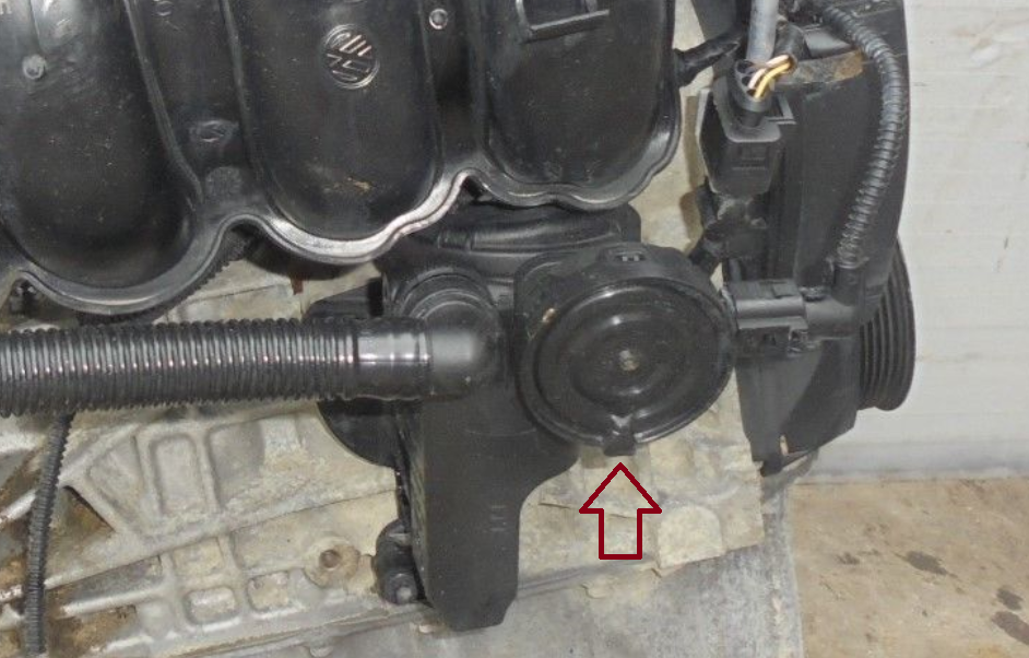

I wonder if your PCV diaphragm is bust. Awkward place to check on these though. Try sticking your finger over the little rectangular port where the arrow is pointing, if you can reach it, while engine is idling, minding aux belt!
It shouldn't be sucking.
Edited by Wino

Right,Wino. The hole in the PCV doesn't seem to suck. My finger couldn't detect any definite vacuum.
