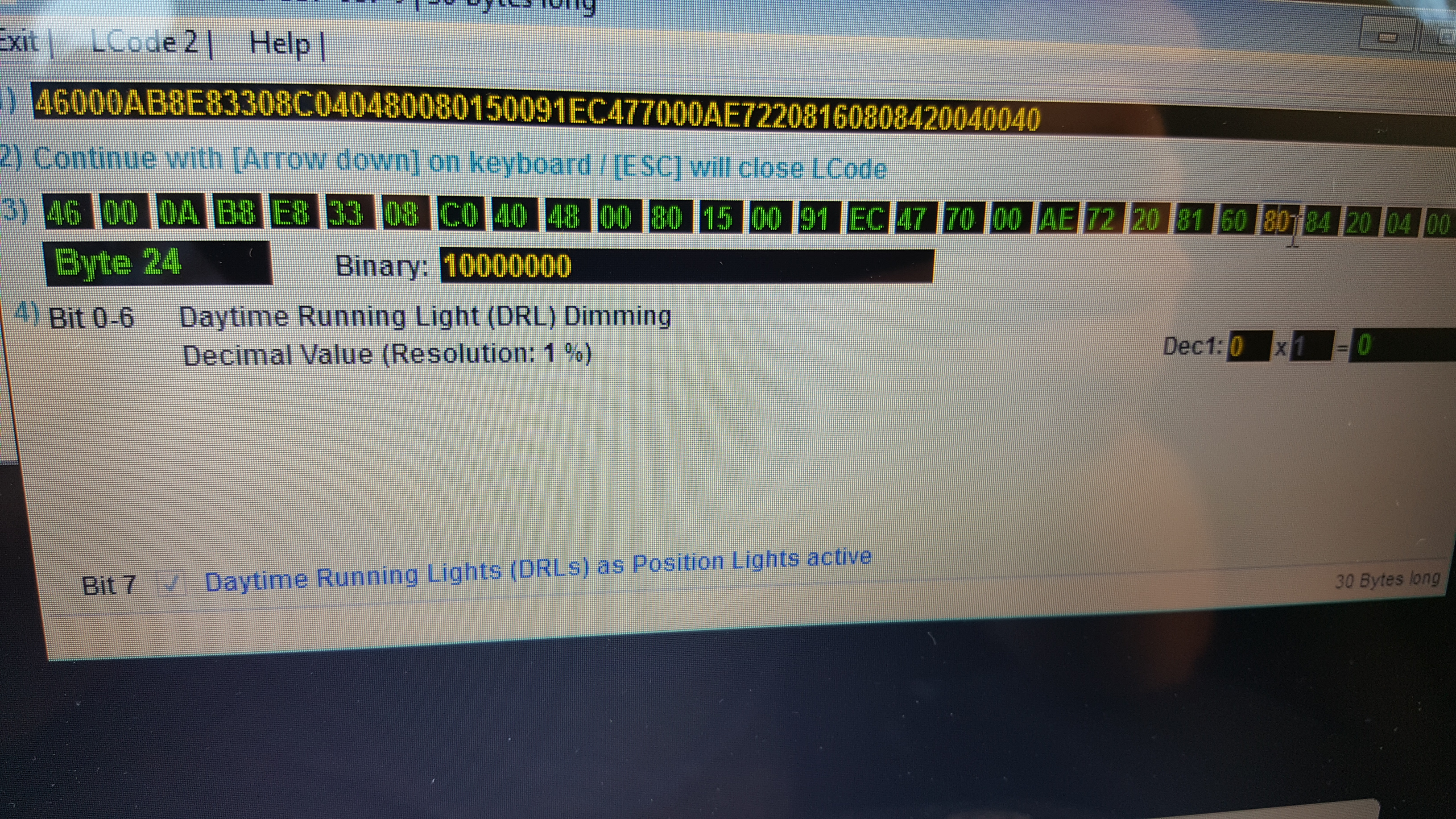

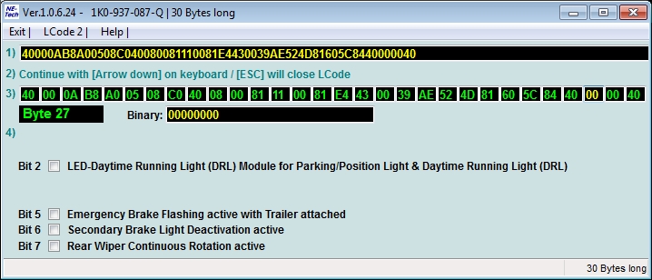

I'm trying to make my factory led DRLs run all the time , even when I manually turn light switch full right ( low beam on ) I want them to stay on. At the moment I made my low beam run all the time so at the daytime I have them both on but as soon as it gets dark or I turn the switch full right way , my low beam xenons come on and DRLs turn completely off. I read other have them dimm or stay on , but my go full off. Greetings , forgive typing errors if you come across any.

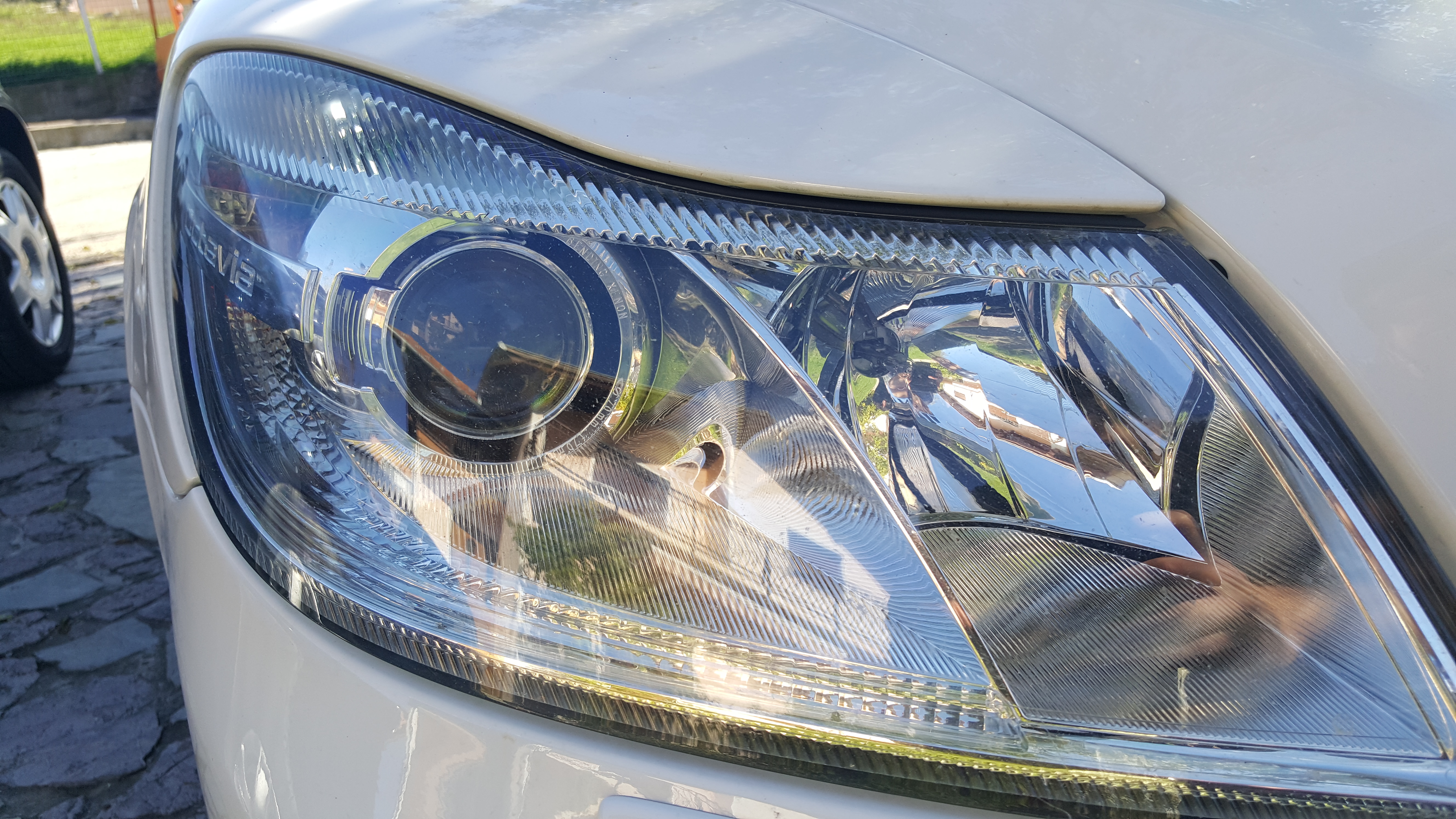

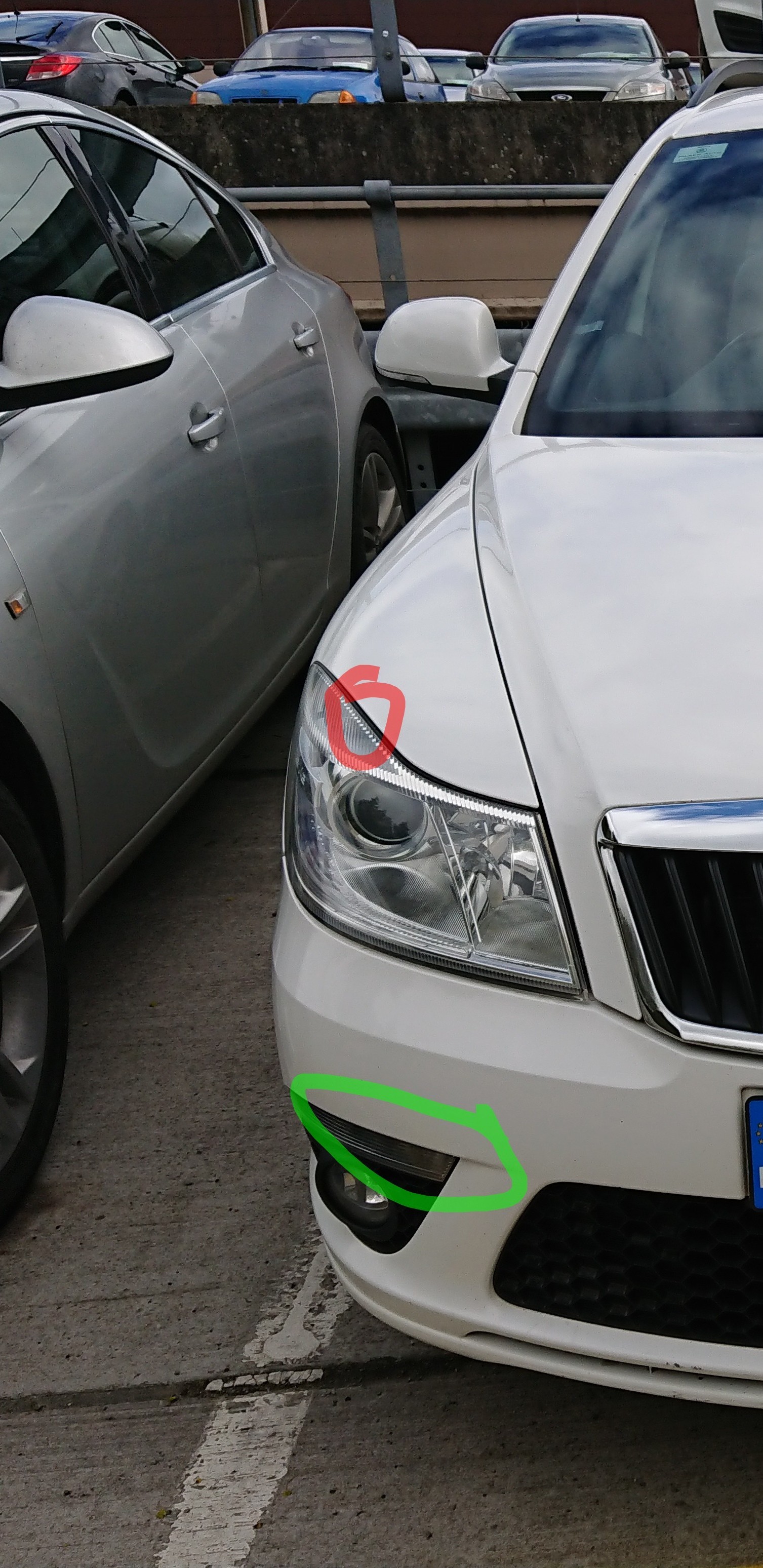

Not sure if this is a trick of the light or not... Do you have sidelights fitted?
If you mean those lights under side mirrors which light up when I unlock the car , yes I do and one just burned out 5 days ago :D . I own vcds and cable so I could post auto scan maybe 3 hours from now or so .I have spent around 5 hours trying make working combination in VCDS but seem unable... Thanks for reply
The ones under the mirrors are puddle lights :)
The sidelights are in the headlights above the low beams and indicator, normally a W5W bulb.
It looks like yours are on but they aren't normally fitted to a vRS, at least on the UK spec.
Live pic (hard to see , sunny afternoon overhere)
Yup, that looks like the sidelight is on.
Normally, on a vRS that bulb isn't wired up... Might be worth taking a headlight out and checking if the wiring looks stock or modified.
Ofc they arent working all the time , when car is off :D ...It lights up when I turn switch to parking lights or when it gets dark and car turns lights on automatically. I bought this car new so I'm only owner and it hasnt anything done to it pretty sure about that. I'll post auto scan in few minutes
Edited by zolic
better explanation
The spec in Bosnia must be different to the UK.
You could also look to see how many wires attach to the rear of the LED DRL.
If it's 3 wires then it should be possible, if it's only 2 wires then I doubt it'll support dimming for use as sidelights :)

Address 09: Cent. Elect. (J519)       Labels: 1K0-937-08x-09.clb
   Part No SW: 1K0 937 087 J    HW: 1K0 937 087 J
   Component: BCM PQ35  H   103 0615
   Revision: 00103 AD
   Coding: 46000AB8E83308C040480084150091EC477000AE72208160808420040040
   Shop #: WSC 31342 313 177557
   VCID: 387EABF18BAF938244-806C

I dont want to dimm , adjust brightness of my DRLs , I wonder if there is command to make them permanently on/off . So no matter full bright or dimmed ,  just want them on with low beams at night.
They are too bright to be used at night... They need to be dimmed to avoid causing glare to other road users.
Assuming you've just reused the existing DRL wiring, it is possible to have them on permanently but you'll need VCP/ODIS.
As far as I'm aware, VCDS won't be able to make the change needed.
Ahh...that pulled trigger for me getting vcds ... I guess I'll looking around for other tweaks to make use of it... Thanks for your time , you are very nice person to seek help from. :)
I see the option but not sure how to use it , if it even matters.
As far as I know you can modify the entry box right after Dec1: to set the percentage of the dimming. In my config it's 92x1=92, but Bit7 is unchecked, since I don't use DRL as position light.
Have you also checked Byte27, Bit2? I'm not sure, but I think this is also neccessary for drl if you want it active with low beam.
Edited by mucden

My apologies for unearthing an old thread. I'm having a similar issue to the above. My DRLs are running all the time lights on or off. Dim when I turn on the lights etc. Not an issue.
I bought a set of W5W LED's for mine. These bulbs don't work at all, never did. Put the new ones in and no joy either. The guy I bought it from said it was because the DRLs are on the car. I've seen the online with both working. The w5w's have wiring at the back of them. I was flicking through the thread and you's have some depth of knowledge RE: the software system on them.
I am wondering if I could get the w5w s bulbs to light up when I turn the switch on to the RHS of the steering wheel and keep the drl settings as they are. Can this be done? I would like to get them all running together if at all possible?
@briVRS - As you have a vRS, you'll probably find there isn't a wire from the BCM to sidelights to power them.
There will be wiring inside the headlight as they are the same headlight as non-vRS models.
