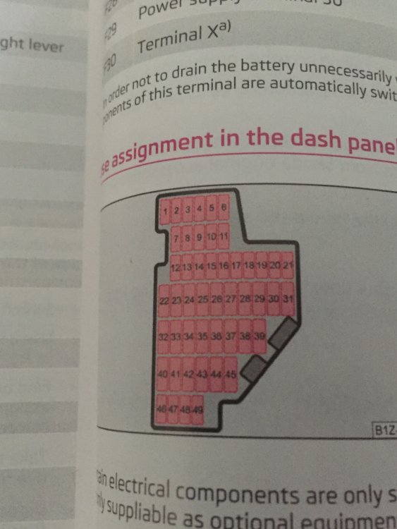

Alarm fuse HELP
Can someone please let me no witch one is my alarm fuse in the picture below because the skoda manual is rubbish
in the book says fuse 35 but I can’t work it out there fuse layout looks different to what I have.
Excuse the piggy back fuse that’s for my dash camera,
Edited by craigandrew
Its a mirror image of the fuse box illustrated in the hand book.
 i.e.  39 in the third row from the bottom read it as 32, 38 as 33 etc . I reckon 35 is no. 36
I scanned the handbook and reversed the image and re numbered it , not really worth the effort involved.
By my reckoning its the large orange 5A centre bottom of your photo.
It was a yellow 20amp,
i no the owners manual is useless and the more you look at the more you think your going mad

You can see the fuse numbering on the second row down, where there aren't any fuses.  Numbers are under each fuse when removed.
Edited by Wino
To tell you the I’ve never looked to see if there were any numbers printed into the plastic casing.but I will have a look now
many thanks
  • Sponsor
Actually the blade fuse sockets (as opposed to mini-blades) may not be numbered, there isn't the same flat area in the middle of the contacts to put numbers on.  If they are there at all, they're not apparent in your photo.
Well it goes to show your never to old to learn something new
the mini fuses are numbered but not the blade fuses,
