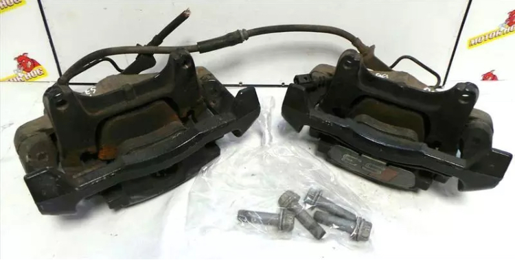

was hoping some one might have a definitive answer to which calipers and carries needed.
Are these the right calipers and kit for the MK2 then?
Audi A3 2.0
Audi A3 2.0
yes, they should fit on the 55mm strut hub.
