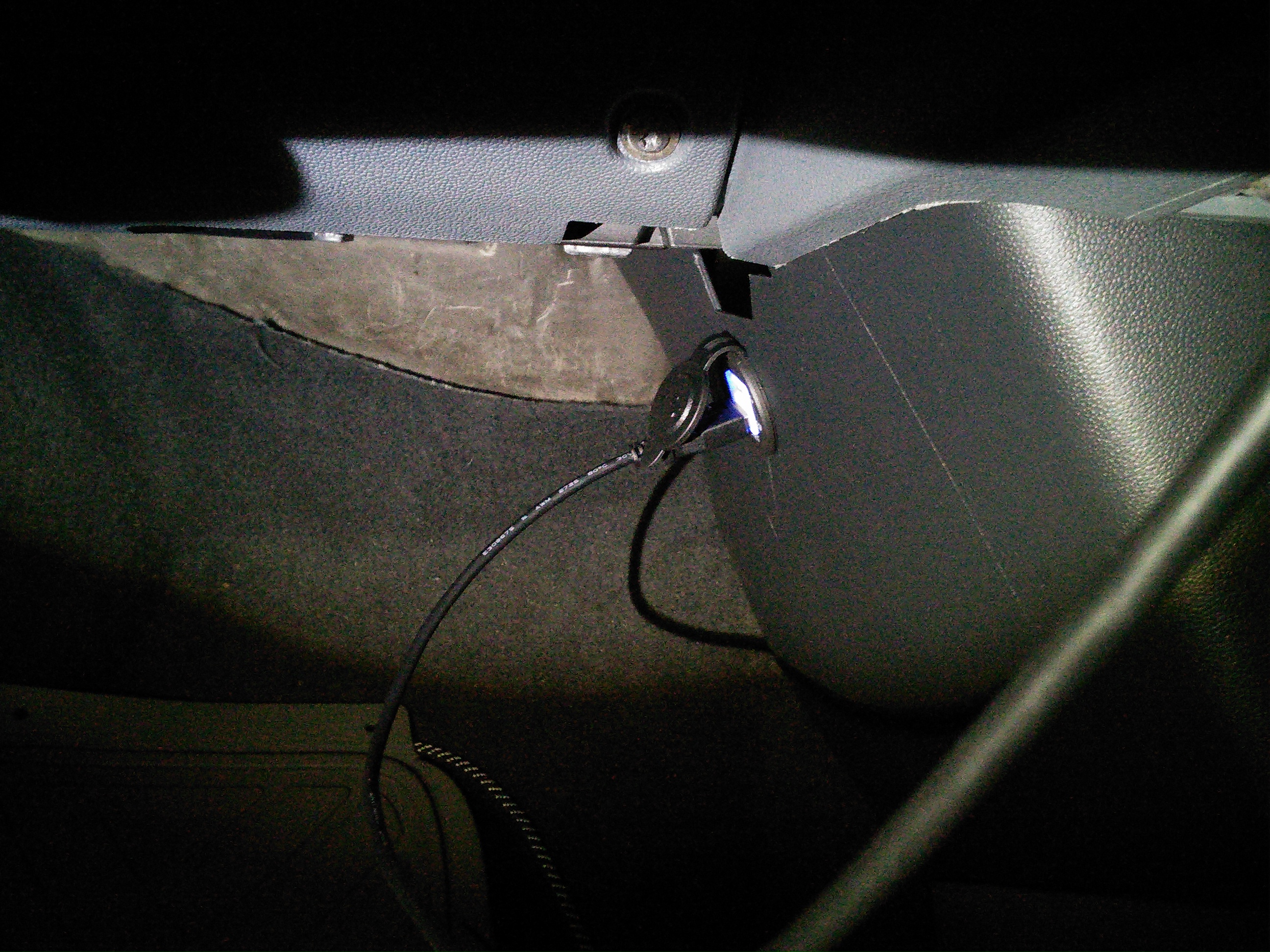

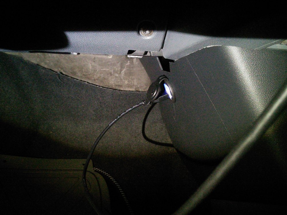

Last weekend i mounted a USB Charger flush into the side of the plastic cowling just below the glove box in the foot well that hide the heater matrix. It's around 58mm deep there so it fit with no issues as the socket was only 47mm deep. I ran the earth and ignition live from the stereo. I use it for my sat have. It has a cover on as well when not in use. Worked for me. If I get a chance I'll post a pick.
Here's mine. Easy fit.
