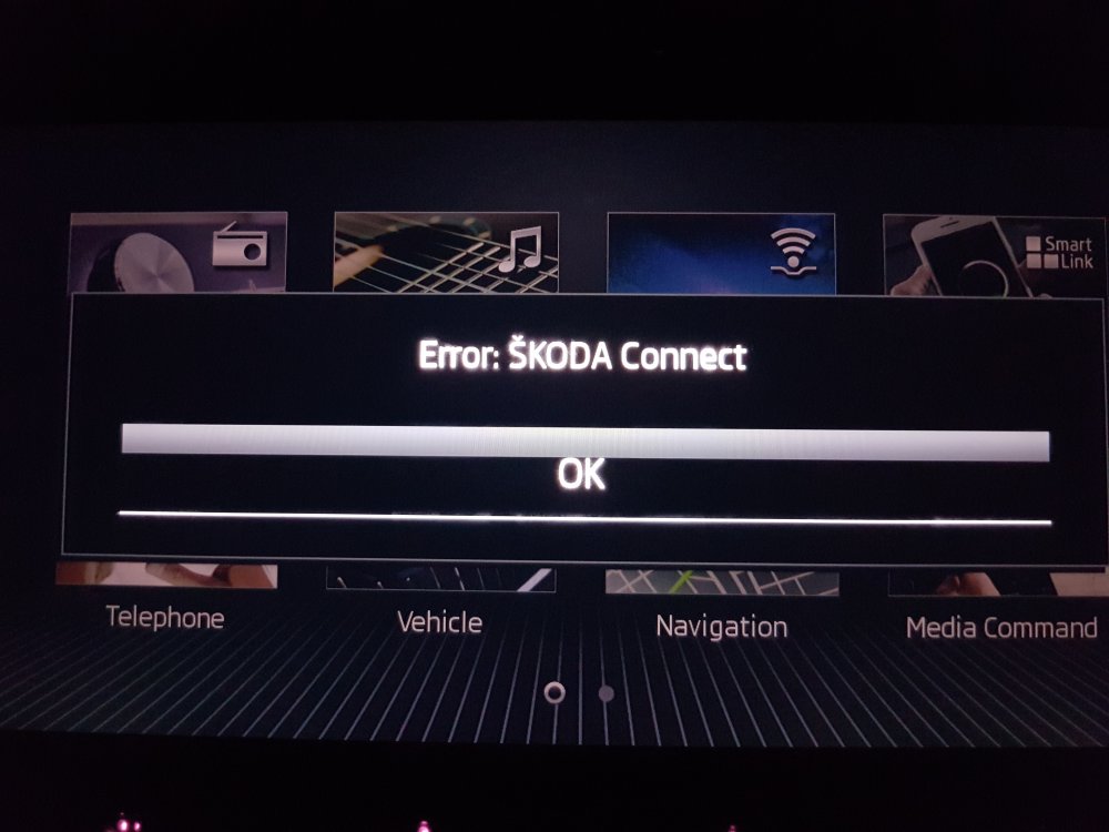

I've had a problem with skoda connect recently which I've managed to fix (I hope), so I thought I'd note it here.
Every time I selected skoda connect in the menu it popped up with "Error: Skoda Connect".
Eventually I deleted my registered user in the infotainment settings, and then reactivated it via my connect app on my phone. It took a while to delete and reconnect but it seems to be working now.

I have exactly the same issue. I did what you tried and it made no difference. I know the car is connecting to Skoda servers because driving data, location, vehicle status, etc. are all being sent.
I have a case logged with Skoda customer services... they haven't suggested anything but their servers did go down yesterday. Could be a knock on effect.
I have a resolution for this from Skoda. I think it's all related to changes on their servers the other day (maybe the weekend). My guess is the Skoda Connect tiles are connecting to published web services from a 'portal' server consuming defined feeds. They might have changed something that means the cached files are no longer matching up with the live web services.
Anyway to get it working, we had to reset the Skoda Connect settings. In the new Columbus if you go to settings -> factory settings you can actually reset individual components. In this case I selected the Skoda Connect option and it then asked me if I wanted to also delete the user and I selected no. Then when I went to the Skoda Connect tile it will have downloaded some files (probably XML) from Skoda's servers and is now working. It remembered the user/registration. Note you need to have Internet connectivity for it to connect but that's obvious ;)

Has anyone else had this problem and not been able to fix it via the above solutions.  I have done the factory reset for Skoda Connect and I still get the error.
I am wondering if I have to delete my user account as well.  If I delete the user - will I lose all my destinations etc?
I deleted the user before I tried the reset option and I didn't lose anything. If these are online destinations then you could download again.

I had a problem that the WLAN-connection worked, but Connect could not find it. Evewn though the connections from my tablet to the car worked fine. It said that there was an internal server error. Ifollowed your advice and reset the Connect settings. I had to re-establish the connection via the connect portal, but the Connect started to work. Thanks for the tip!  with the computers it is always a good advice to boot:-).

To help where the factory reset and other solutions outlined above didn't resolve the Skoda Connect issues. *
I found a Polish site where they had a similar issue with Skoda Connect not working and the solution which worked for me was to disconnect the battery for 90 minutes.
Follow the Skoda instructions to disconnect and reconnect the battery. - You'll get errors on reconnection, but a short drive seems to sort those out OK.
The Polish site is: https://www.kodiaq-klub.pl/forum/viewtopic.php?f=10&t=661
