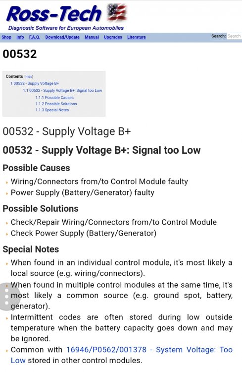

This is what Ross tech brings up with that fault code.
12 hours ago, Beefymilly said:
I tested the battery with a multi meter the other day and it was fine
This "test" only proved the battery holds well a load of around 1 mA or less.
How old is your battery? Your description hints towards a dying battery or a weak charging system.
