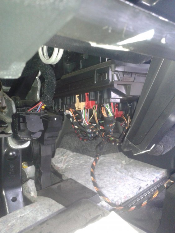

It's just above the accelerator pedal. If you take off the lower dash covering (see this how-to, the first few steps show removal of this panel nicely), you'll see it with all its connectors hanging down.

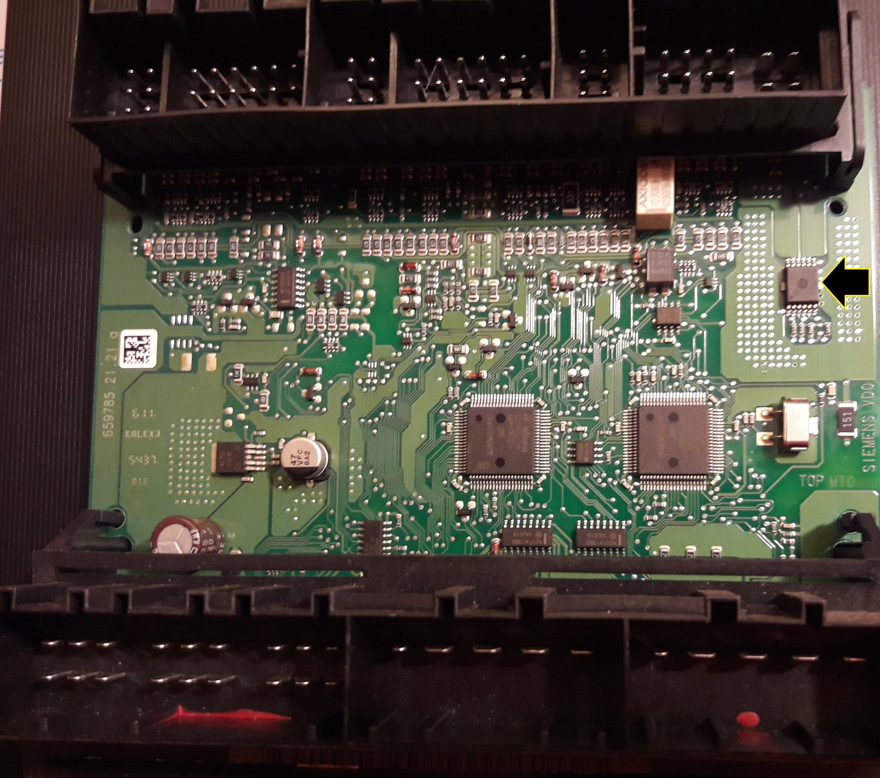

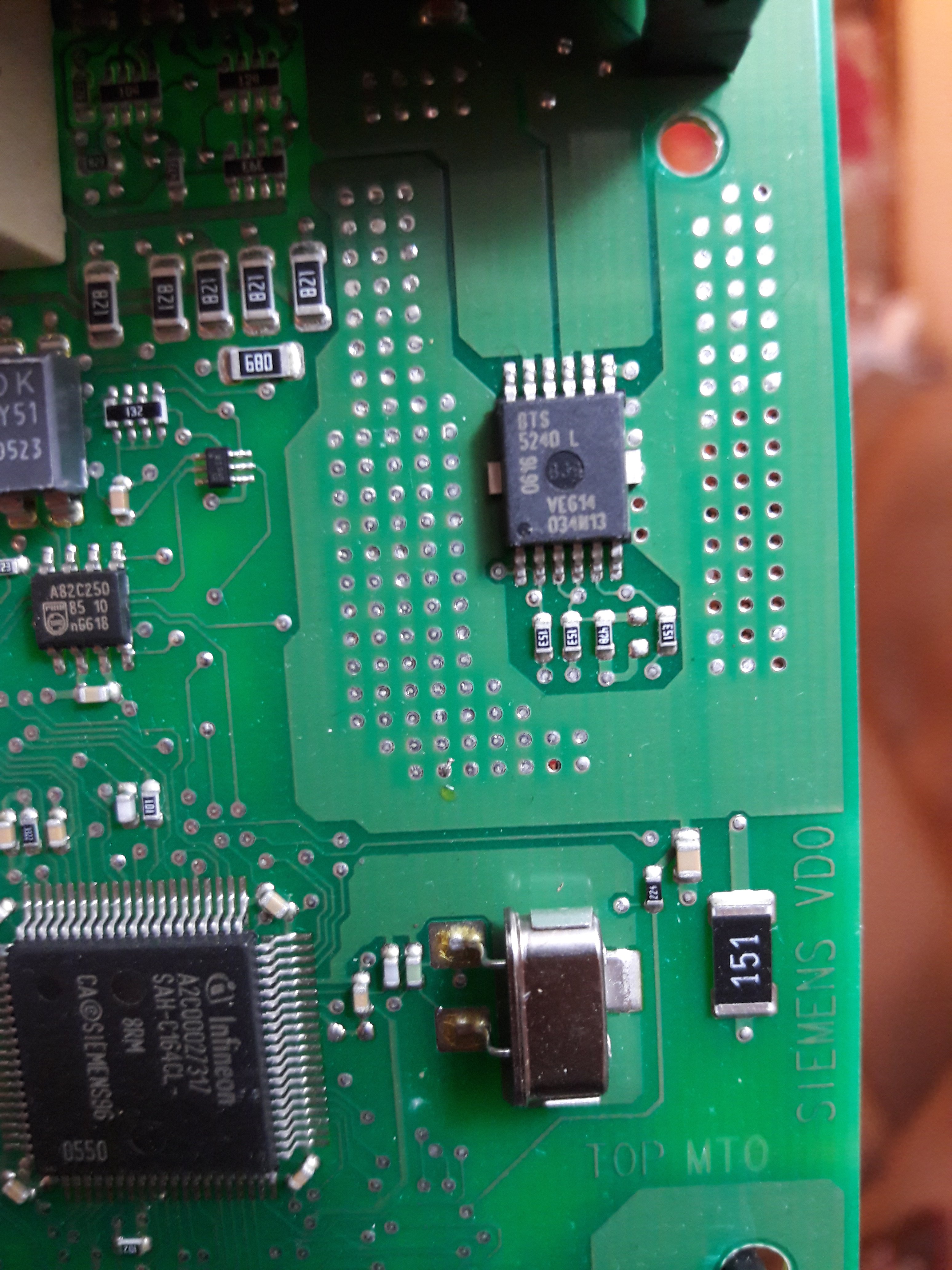

I've just taken a photo or two of the chip inside the control unit which 'does' the indicators, and it isn't straightforward to replace; but if available to buy, I'd happily give it a go.

This is the little fella:
Looks to be obsolete from the usual sources, but ebay has a fair smattering of them at various prices.
I'd still be tempted to try A.N. Other unit with identical part number from a car as similar as possible to yours ahead of the 'surgical' approach, but if you could be without the unit for a few days, it could be a plan that would avoid any coding issues if it worked.

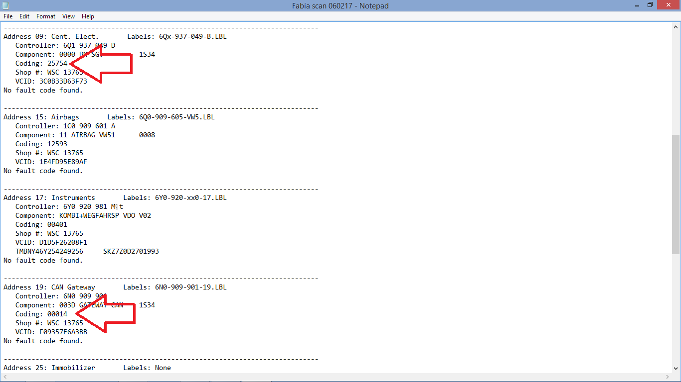

If I do get a unit, is the sequence to use VCDS to take a map of the old unit, then re-programme the new one when in situ - assuming the right indicator show willingness when plugged into the replacement BCM?
  • Sponsor
I think the VCDS stuff is as simple as reading (with a VCDS scan) the existing coding of the unit and its sub-unit which is the 'gateway' and then - as you say - putting the new unit in the car and altering the coding (as necessary) of those two to be the same as what they were in the original unit.
Here are examples of the coding on our car, do you have an existing scan you could look at? Likely to be different codes.
There are three different types of central electrics modules (also known as Boardnetz), technically not a BCM.
6Q0 and 6Q1, these are interchangeable and will work on any MK1 Fabia.
6Q2 is a lowline unit and won’t operate things like cruise, electric mirrors and a few other things.
The five digit code code code from the old one will be enough to get most stuff working the same. There are a few adaptions you can set. Getting a module from a post 05MY car (if memory serves) will get you the three flash comfort indicators (lane change).
