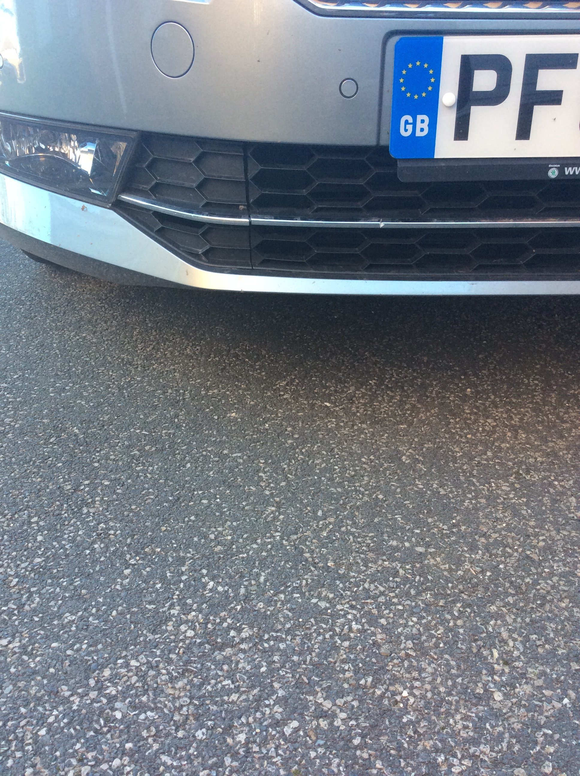

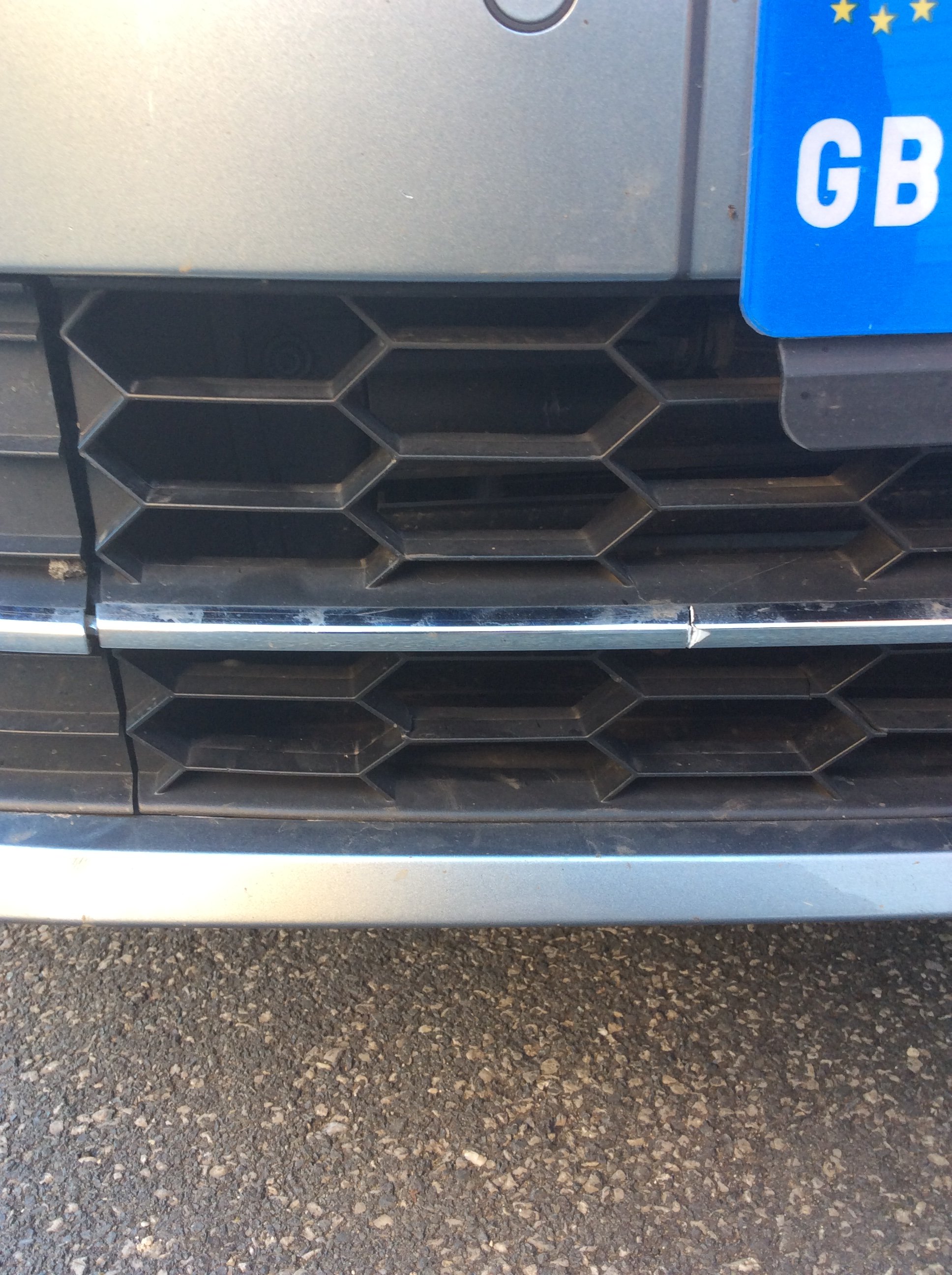

Hi all, unfortunately I hit a fox a couple of days ago, it died. The lower middle section of my grill has been snapped and pushed back so I wondered if anyone knows where I can source one complete with chrome trim? Also any info or diagram for the removal and assessmbly would be helpful.
Its a lease car and due to be handed back at the end of December, I'd imagine it'll be cheaper for me to repair than be charged for the repair at the end of the lease.
Has it all gone, or is it just the chrome trim, I cannot really tell from the photos.
either way here are the part numbers.  There is also the Superskoda website links too.
honeycomb grill   3V08536779B9    http://www.superskoda.com/Skoda/SUPERB-III/Superb-III-original-Skoda-front-bumper-grille-CENTER
Chrome piece  3V0853551A2ZZ   http://www.superskoda.com/Skoda/SUPERB-III/Superb-III-original-Skoda-front-bumper-center-grille-lid-CHROME
Many thanks for that. It's just the chrome trim that has snapped, typical that's the most expensive bit! The black grill is just pushed back and I couldn't pull it forwards, hence asking for any assembly diagrams to work out how it clips together
