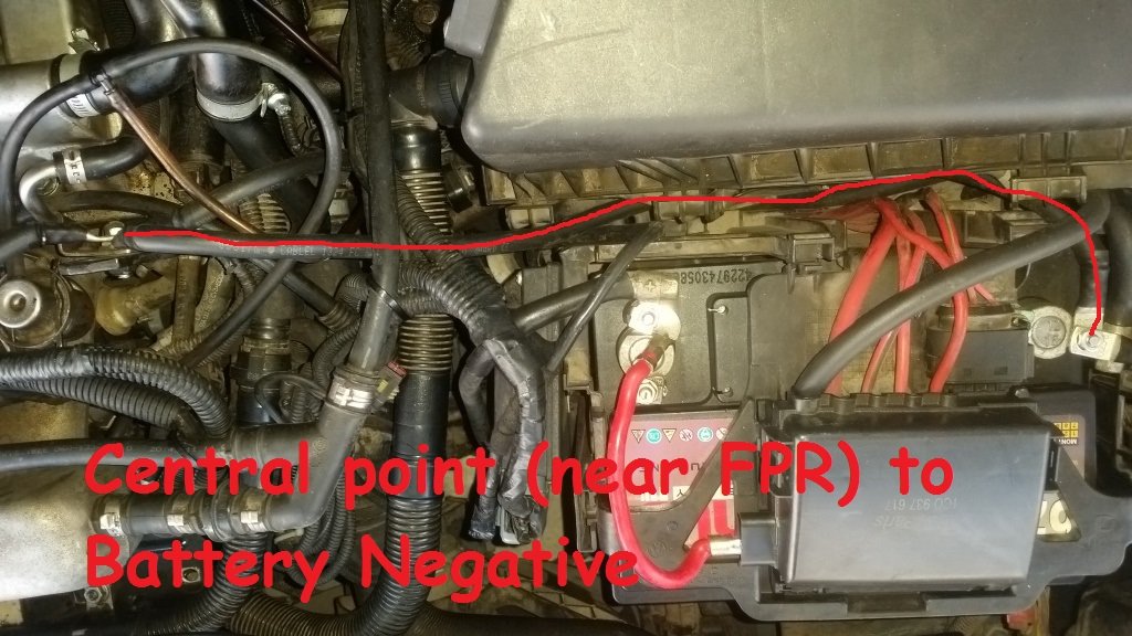

After experiencing some electrical issues, I decided to do the grounding mod-see the full DIY here:
https://diy-vag-20vt.blogspot.gr/2017/10/ground-wiring.html

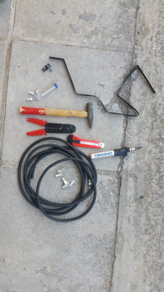

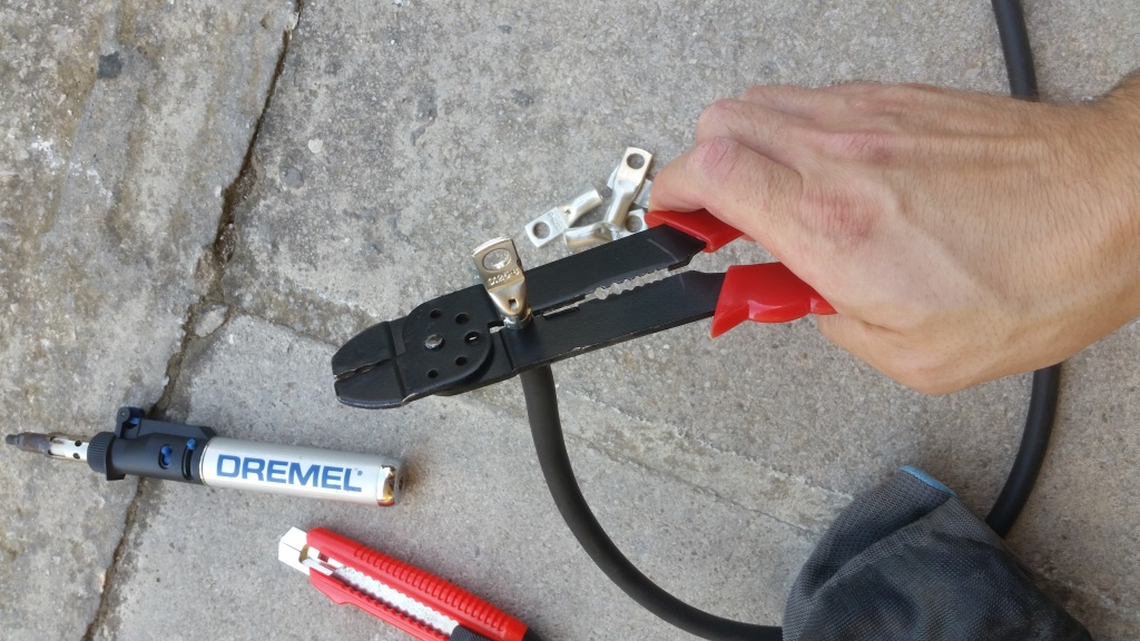

I used about 2 meters of 4 gauge wire as in the following links (scroll down to find the tab ''ΣΥΝΟΔΕΥΤΙΚΑ ΑΡΧΕΙΑ''to see their specs):
wire

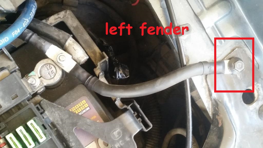

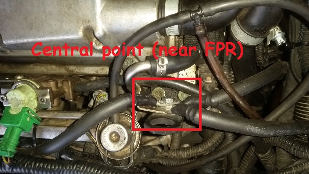

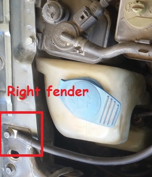

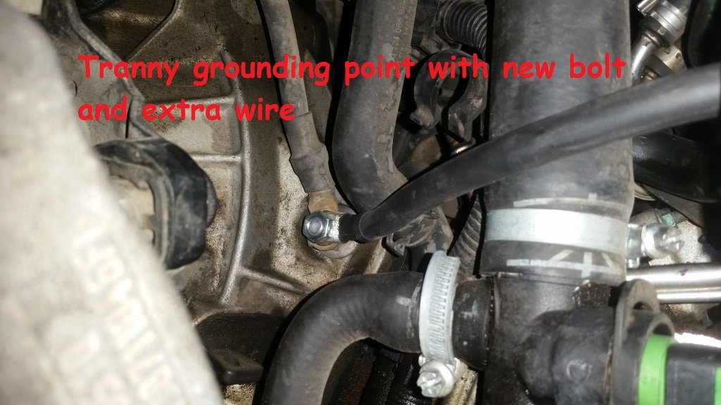

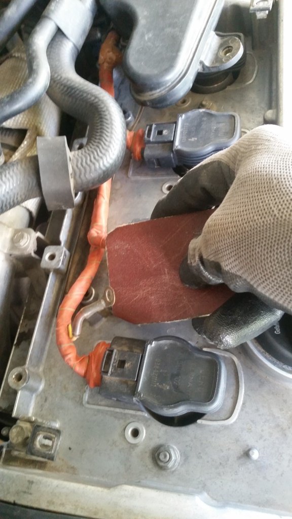

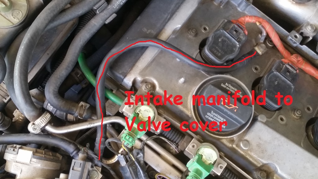

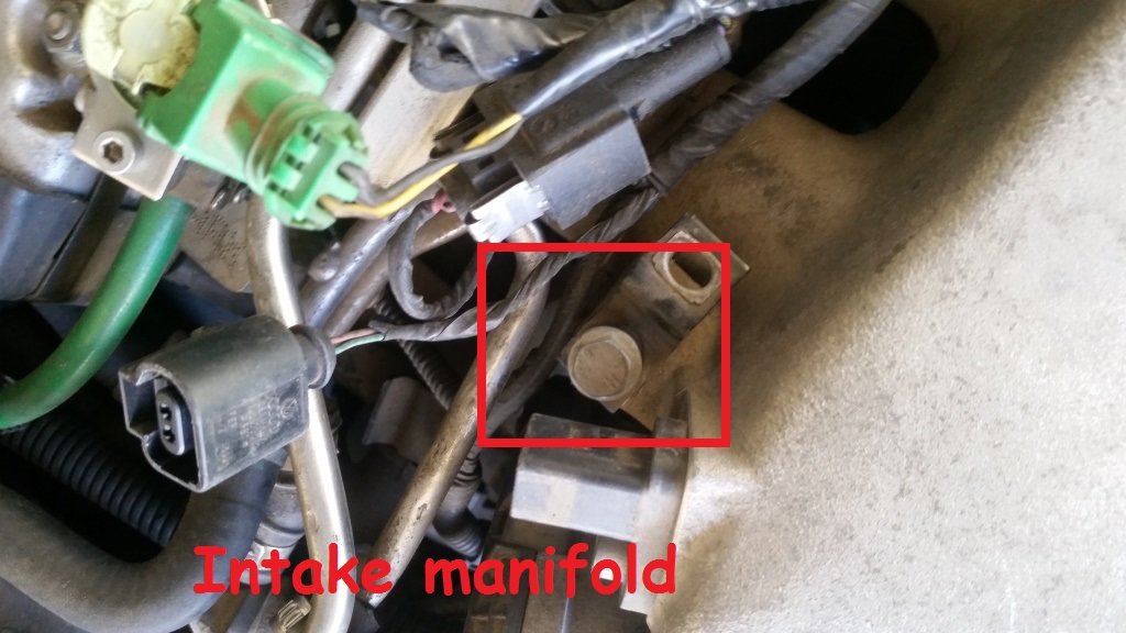

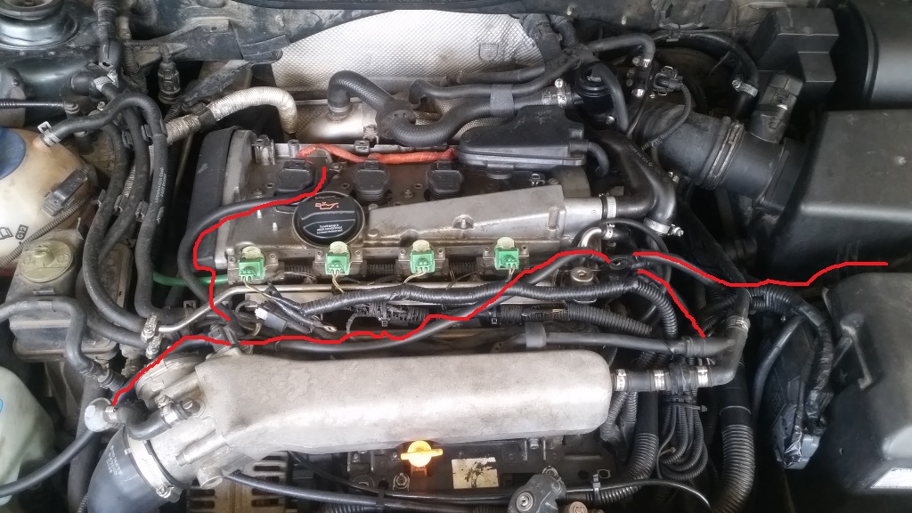

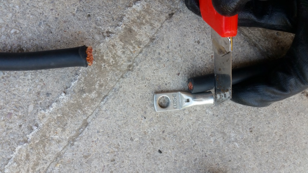

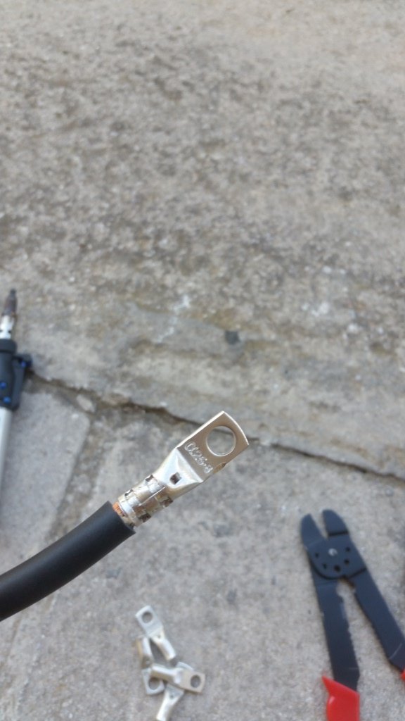

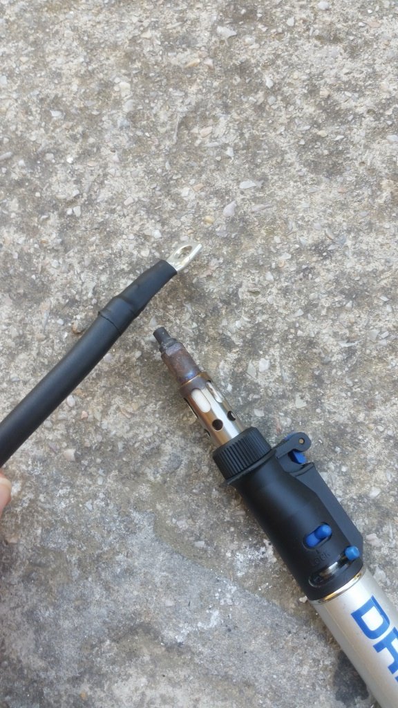

I built the following wires (length is not standard as there are different ways to do it):

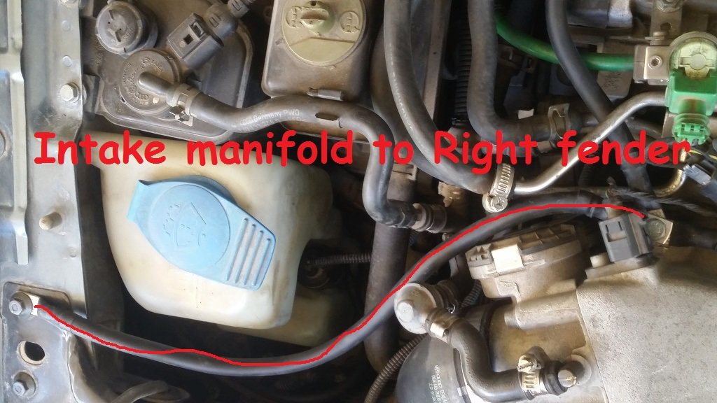

Intake manifold to Right fender

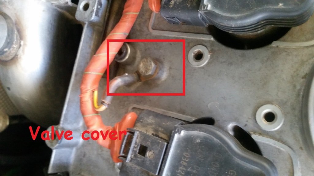

Intake manifold to Valve cover

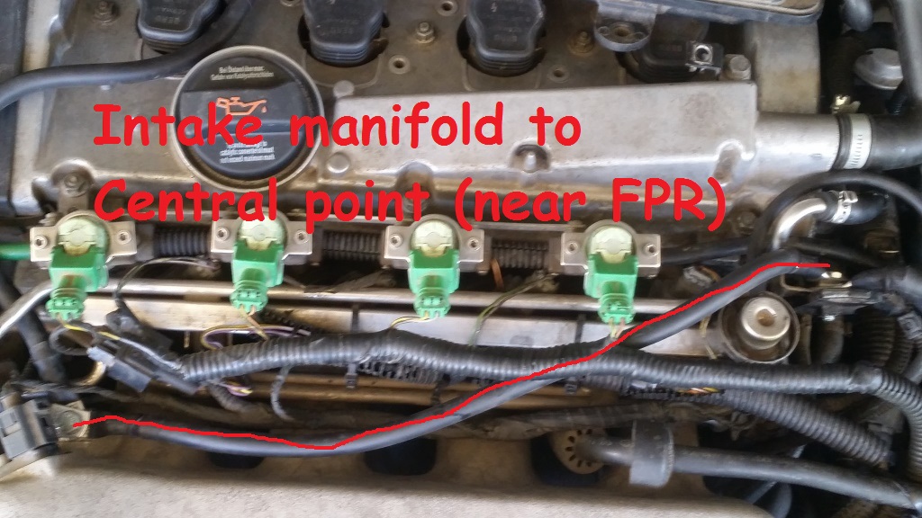

Intake manifold to Central point (near FPR)

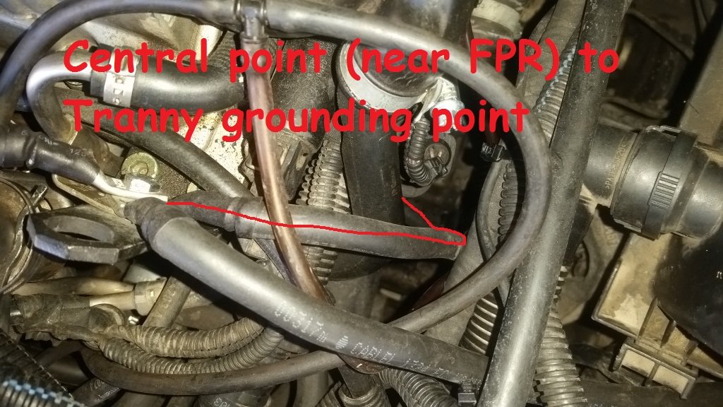

Central point (near FPR) to Tranny grounding point

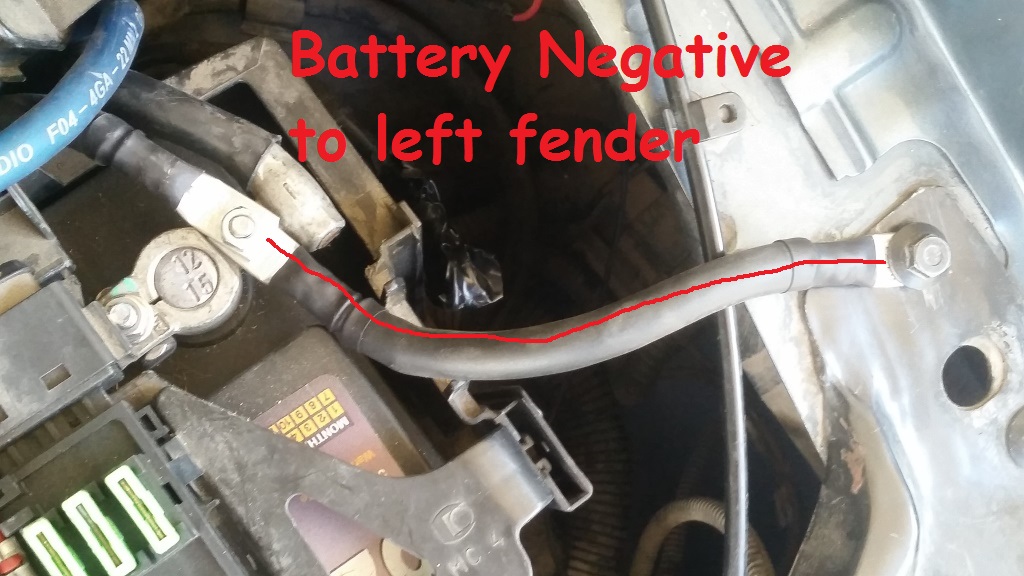

Central point (near FPR) to Battery Negative
Battery Negative to left fender
After installing I noticed a slightly smoother operation of the engine (mostly on idle), slightly better radio reception and higher charging voltage (my Scangauge now saws 13.8-13.9 compared to 13.2-13.4 volts before).
