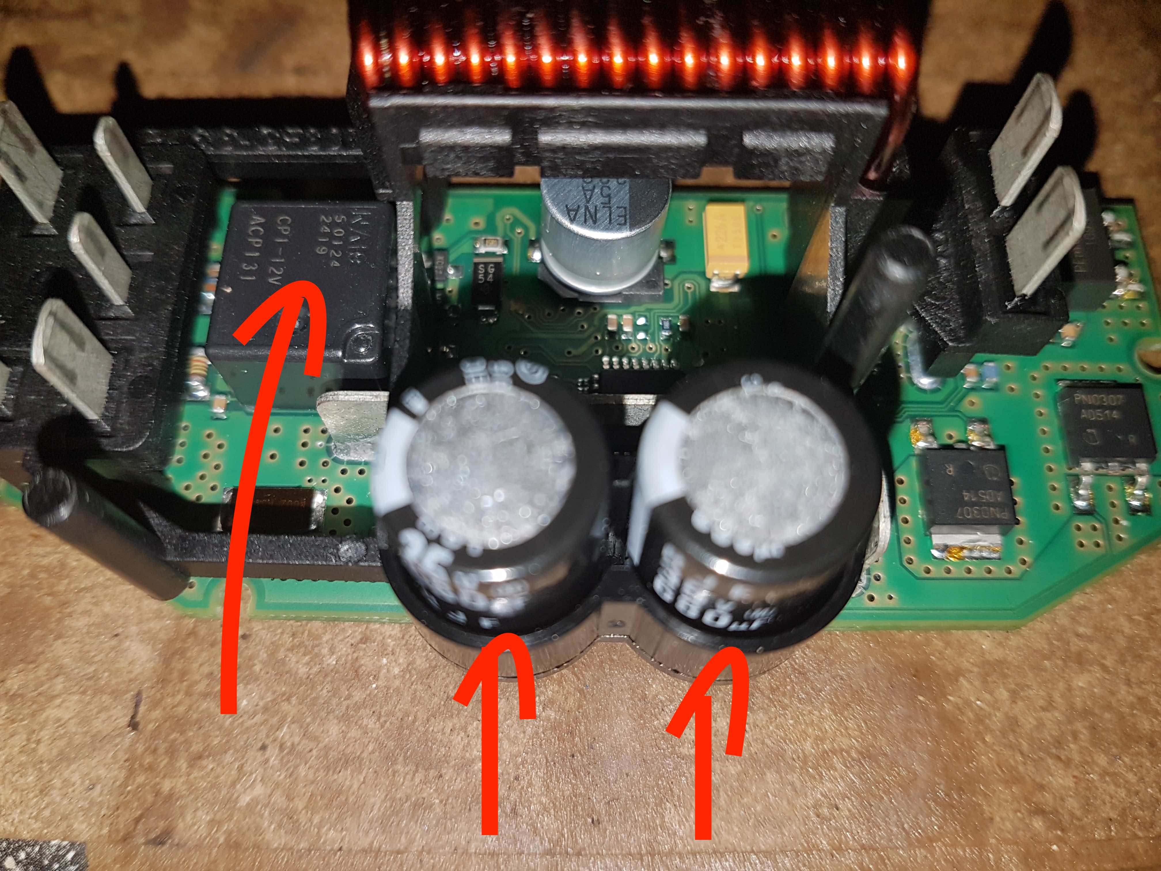

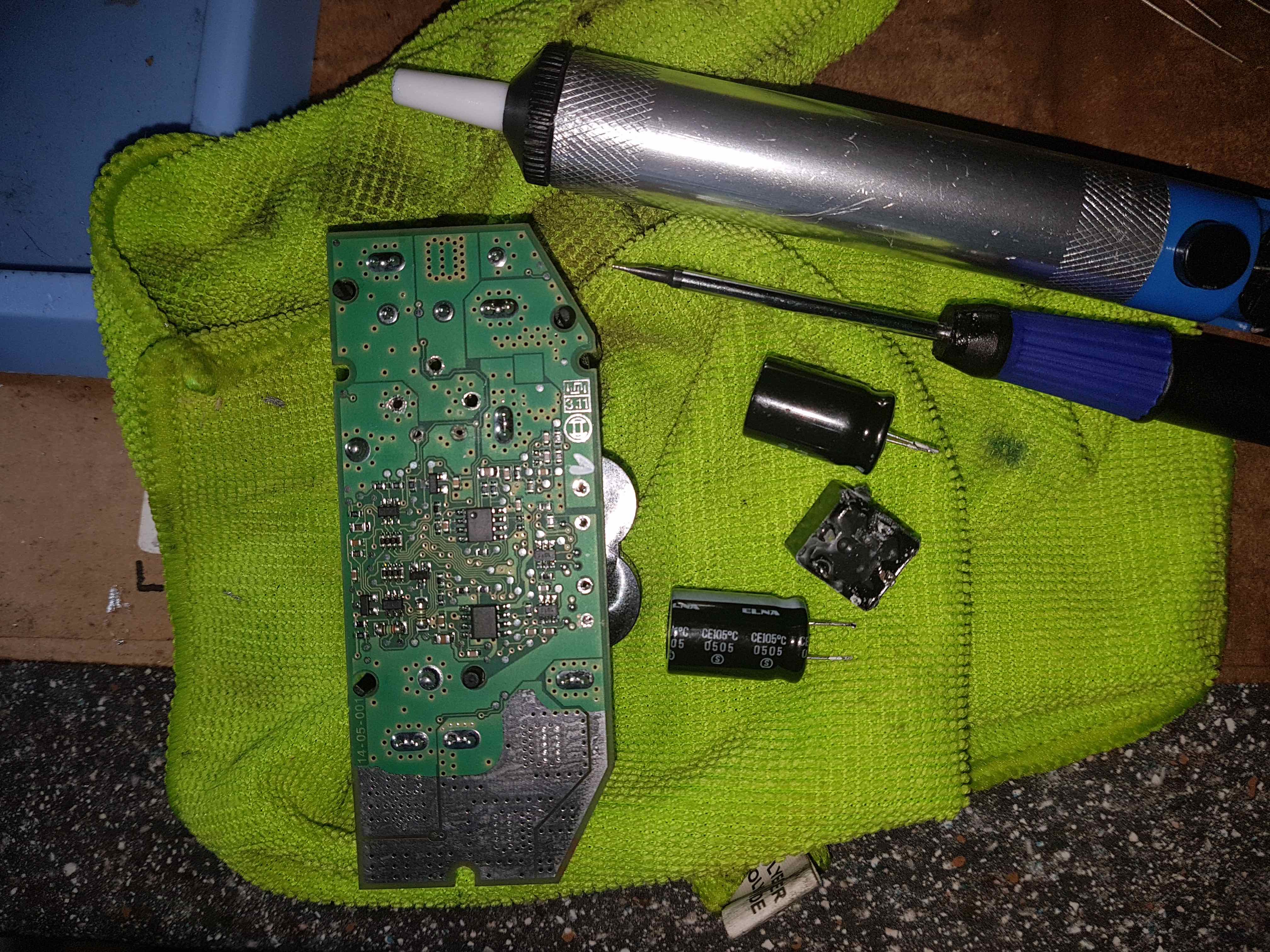

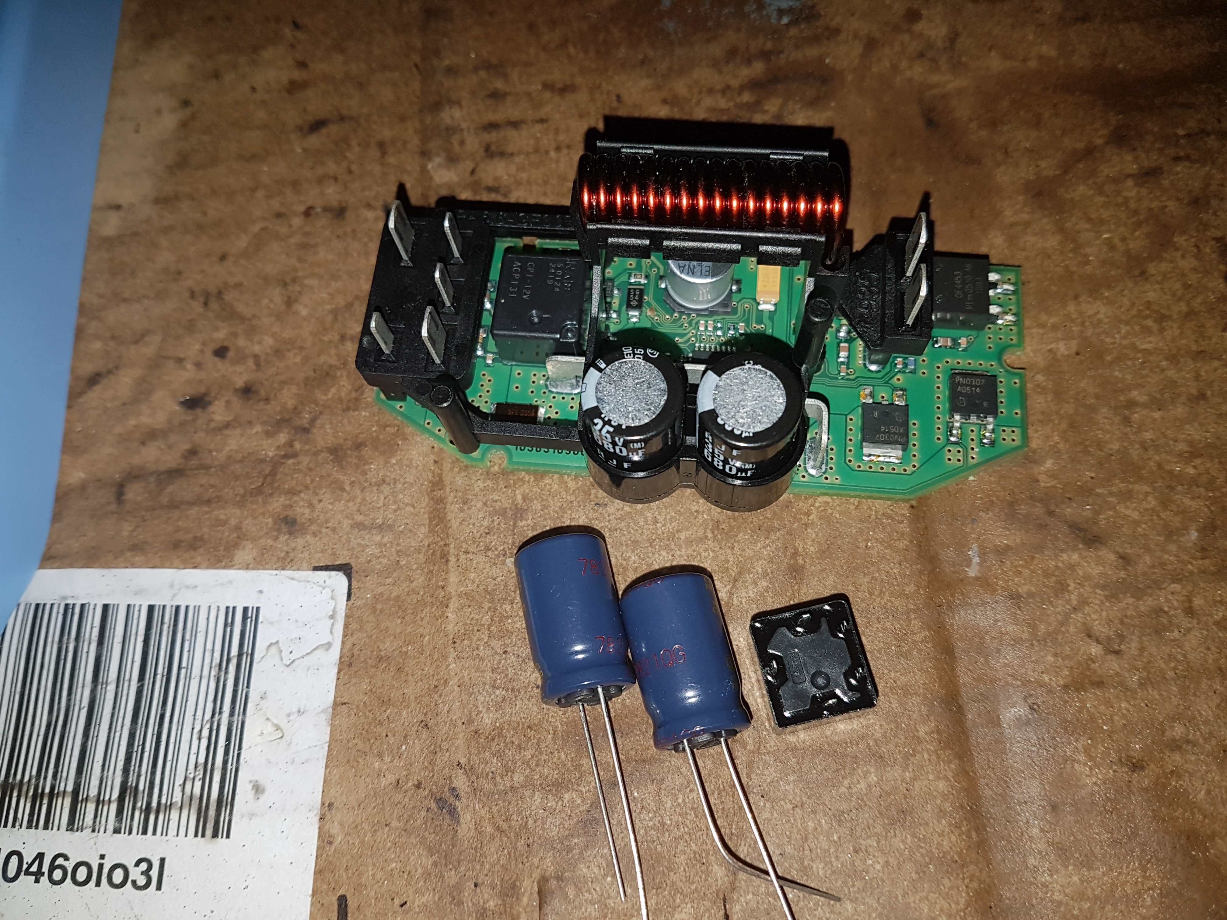

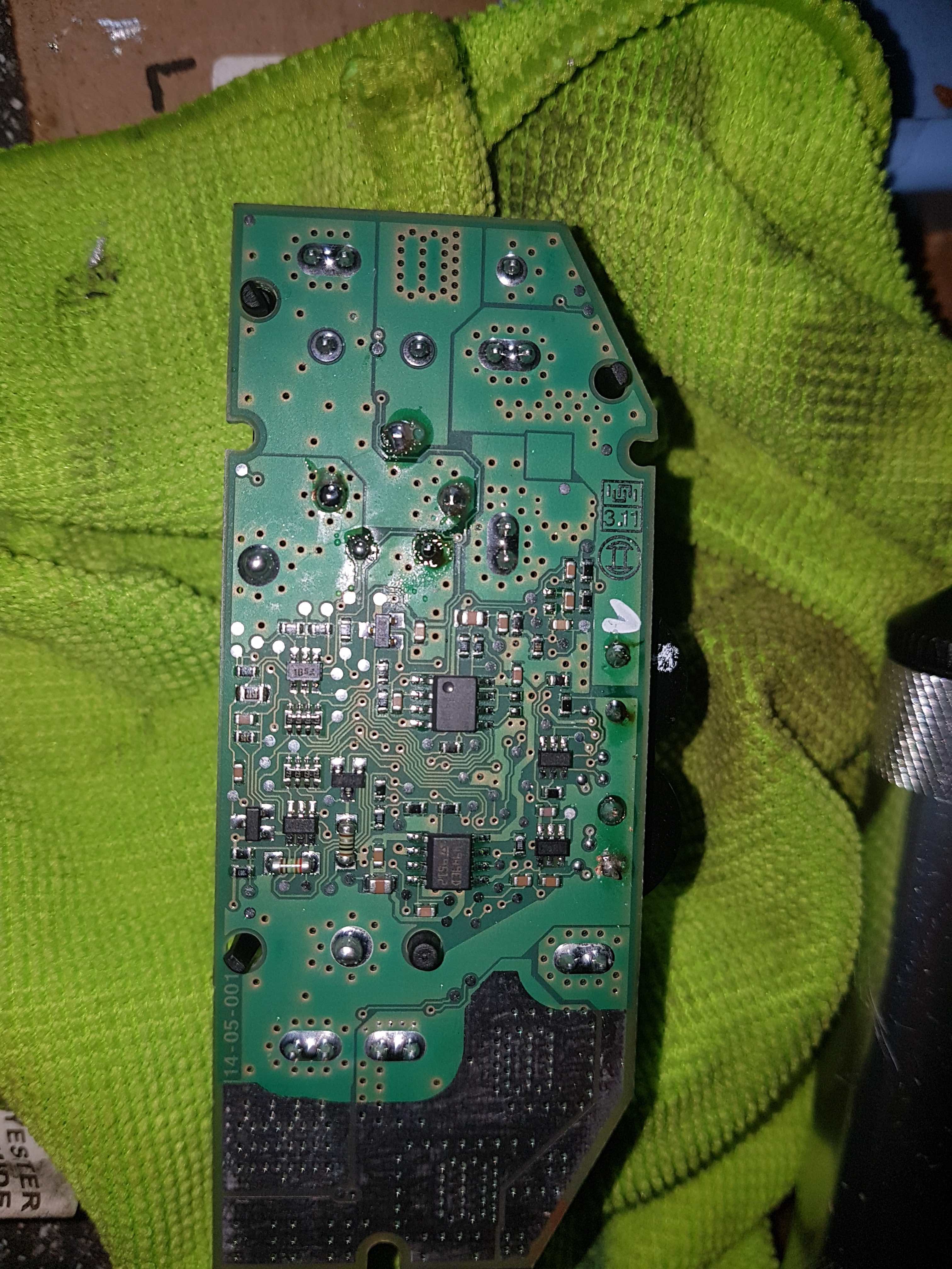

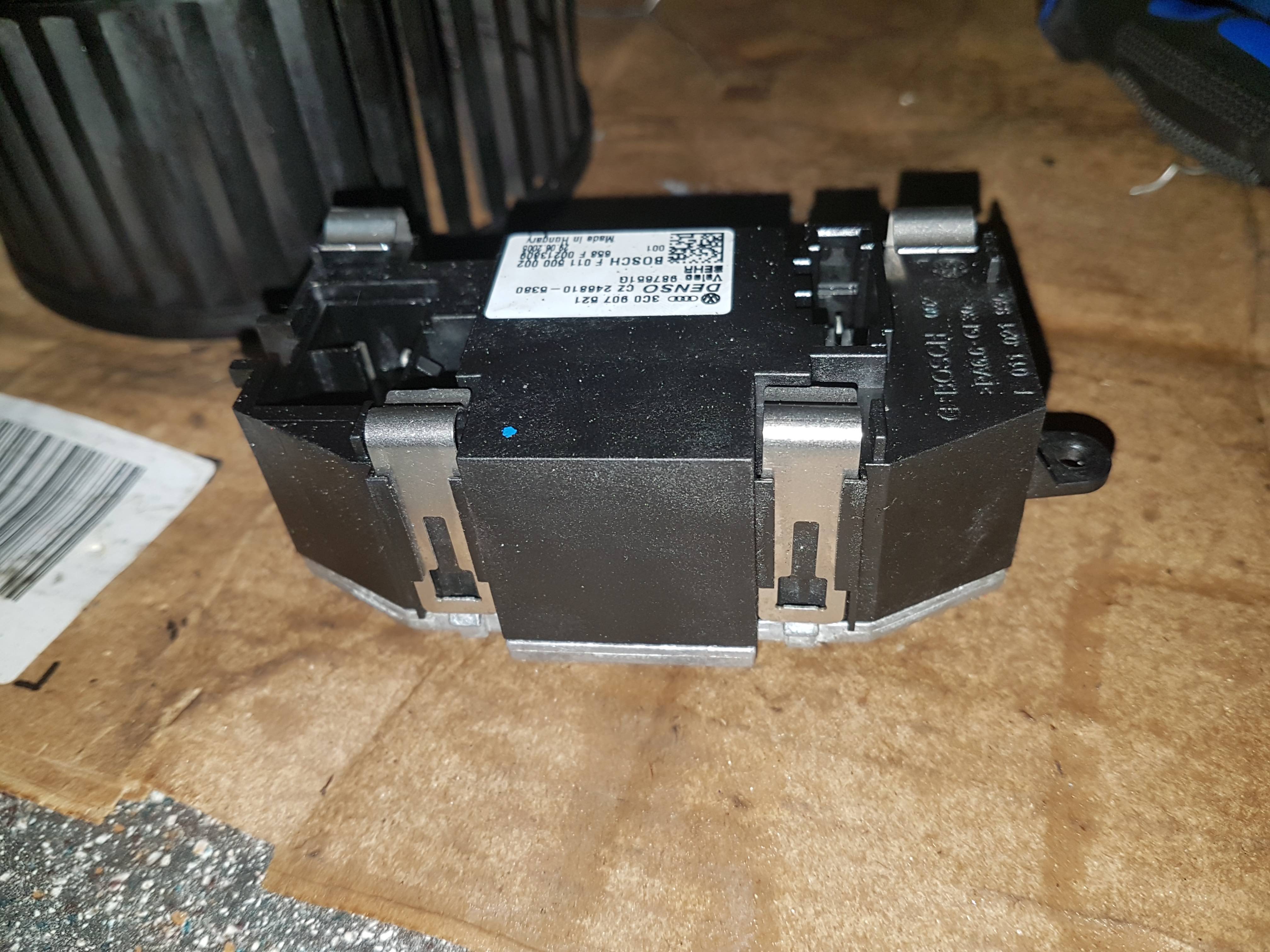

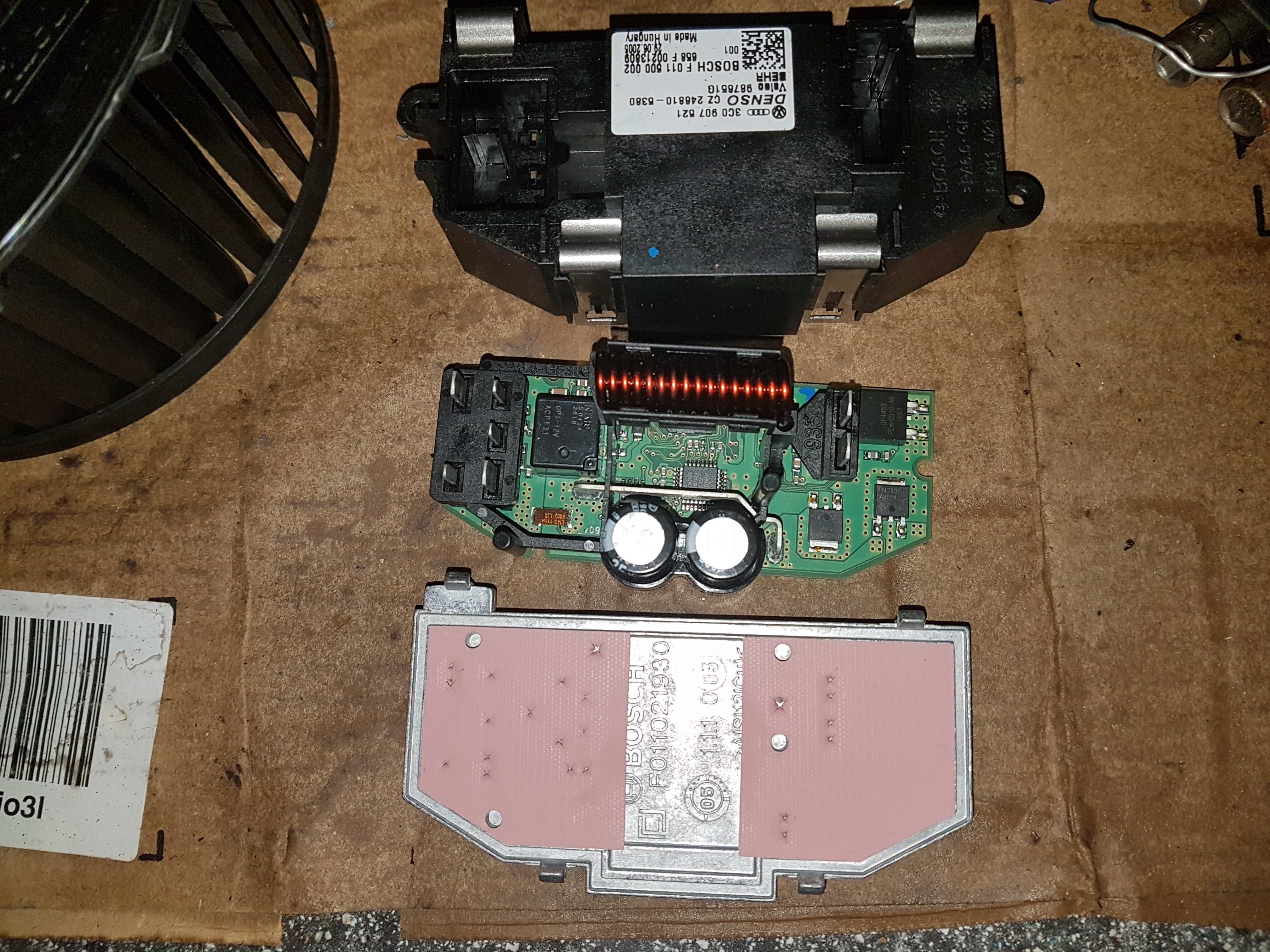

Right, so coming from an electronic engineering background, after testing the fan ,holding it while my son changed the console settings, I noticed a little click, then it seemed to work -  so back on the bench.
Opening up the speed controller unit I spotted a sub-minature relay. After checking for dry solder joints I looked it up in Farnells electronics catalog and ordered a new relay along with the two electrolytic capacitors, as these can be problematic especially when higher currents are involved. I also found a company online willing to repair these units, so I guess it must be something simple like a relay worn out...
So I desoldered the caps and relay ( not for the faint hearted as its on a very small scale ) and reinstalled the new components. All back in the car and working ( although it's done that to me for a day or so previously and stopped again ) - I will post back if it holds up.... I have also ordered the console climate control panel off eBay so if all fails again, I will replace that..
Pics :- 1) starting point   2) speed controller unit off    3) case off speed controller   4) circuit lifted off heat sink     5) Showing components I changed    6) New components ready to get swapped
7) desoldered components and tools used    8)  New bits soldered in ( not great soldering job - but copper starting to lift from board )

Great work if it stands the test of time.  Anything visually wrong with either cap? Not seeing obvious bulging, or leaking.  Wonder what the relay does?
No Visual signs, but these are vented at the PCB end as they are not scored on the tops and were not visible as they sit in plastic holding structures They were only 90p each so I thought why not...The relay is a 20A unit at 12 - 14v and when I put it back in testing I could hear it click once the ignition was turned on. My guess is that it powers the whole unit based on the ignition switch. The spec for it, I believe states that they are silver plated contacts, so after a certain amount of time, they get arcing related oxidation problems on the contact surfaces. Again, this fits the intermittent failure behavior. I could be wrong, but everything else on the board looks semiconductor pieces and usually when they fail, they're gone.
Fingers crossed, I should know by the weekend as when I took it out to clean it and then took it out again to change the motor brushes, it always worked when put back for a day or so before stopping..
