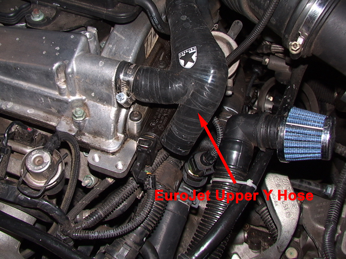

This is not my engine but you can see a silver disc thing just under the pipe thats what is leaking under it any ideas
That is the combi valve for the SAI system. There is a gasket under the valve, there is also a gasket under the timing chain tensioner that lives just above that. The 1.8t has a cambelt to the exhaust cam on the drivers side of the engine, but a camchain between the inlet and exhaust cams on the left of the engine that is oil pressure driven. That is left and right as you sit in the car or reversed when looking in the engine bay.

Well the oil is under this so it must be the gasket is it easy to change
Are you sure it is coming from that gasket or running down from the tensioner and ending up under the combi valve?. the combi valve is not to sifficult, but the tensioner gasket requires a special tool to compress the tensioner to release the chain from the cams to enable the tensioner to lift out of the way - not so simple, but well within the scope if you have had an engine to pieces before. If you haven't, I would let a pro do that one.
The thing about oil is it can be almost invisible to the naked eye unless it is leaking a fair quantity, and fairly old oil. It has to run about 3cm from the tensioner to the combi valve so could easily look like it is coming from it. Have a good clean, cross your fingers and hope you are lucky.

looks like its your tensioner gasket then, pcv wont leak like this from the cam cover breather unless the bucket splash caps were not installed. its easy enough to change but you need a good few tools
Have a look here at my project thread, page 7:
For a long time I was convinced it was the cam cover gasket and changed it twice to no avail.  The oil was covering the top of the gearbox and everything else in the vicinity.
Off came the chain tensioner once the inlet cam was removed and 4,000 miles later and it's still dry.  My work was made easier by previous deletes around that side of the engine, took me a morning of working slowly.  Having done it once, I could probably do it in half the time now.
