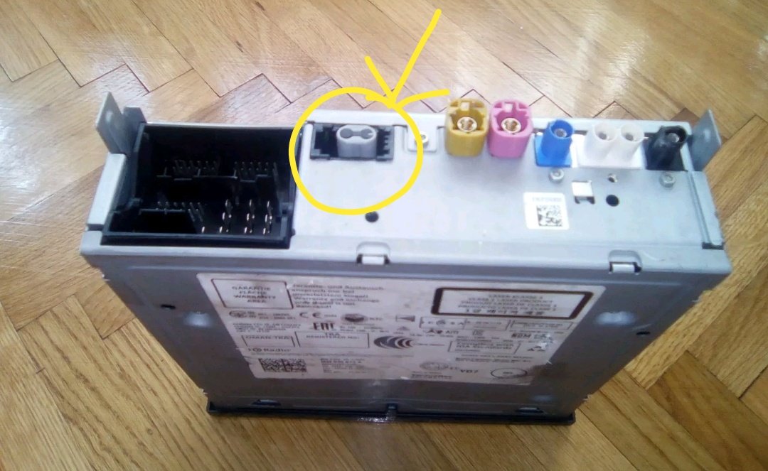

@SashaGrace found a unit 5Q0035874A but there is a connector I don't recognise. See attached.
It’s the plug for the CANTON amp. If you don’t have it, there is no need to worry about it :)
