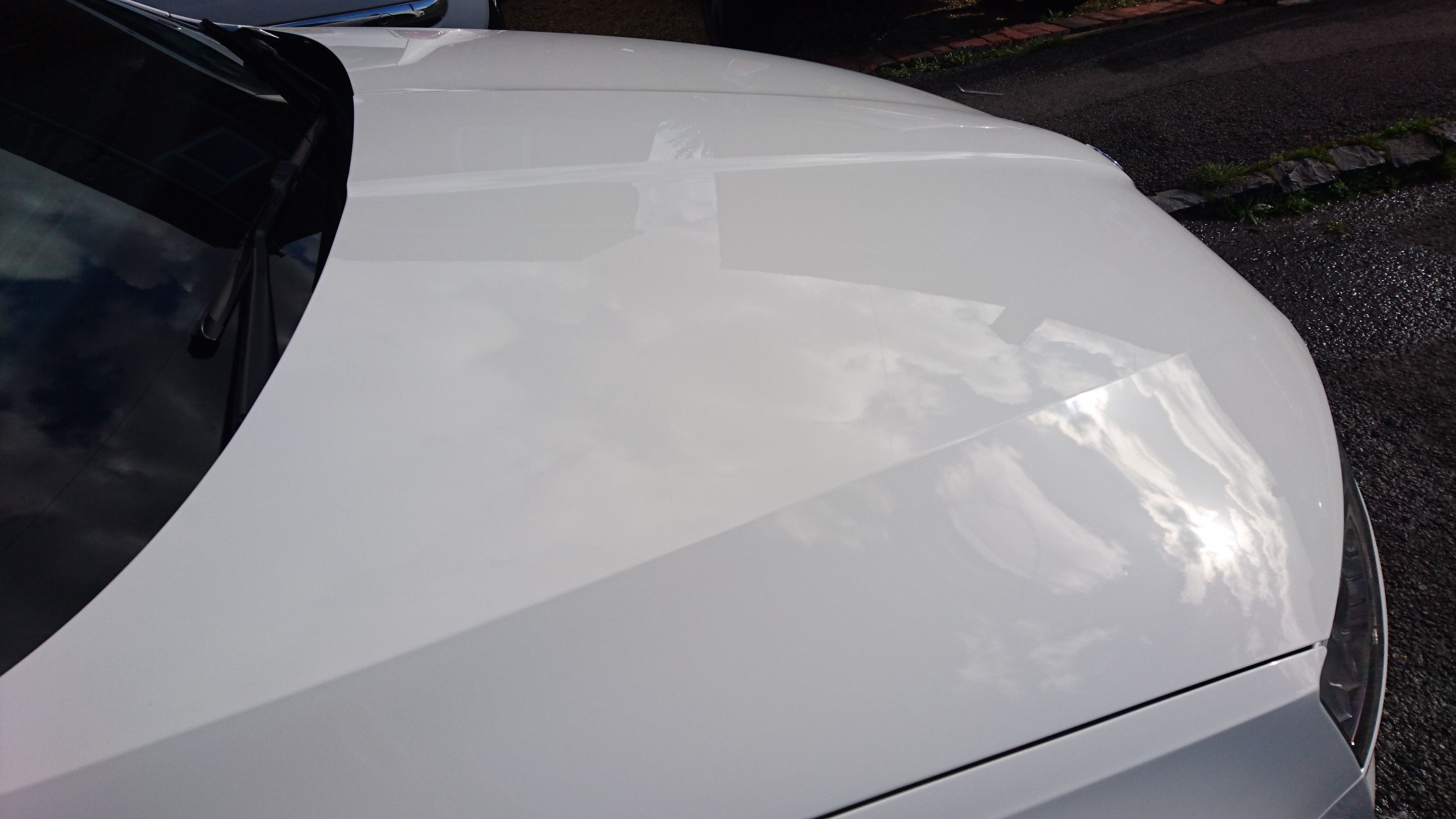

It got good results on my Quatrz Grey Superb but there are still some light scratches, spider webbing and some deep (clear coat) scratches that I want to take care of before I apply some Ceramic Coating Coating I recently got on a deal. (Sonax - CC36 Ceramic Coating)
Its pretty obvious the last owner used a 'hand car wash' or a sponge and you can defo tell a silicone blade was used to dry the car due to the long straight abrasions on the bonnet and roof.

If your struggling to remove the deeper scratches with the polish you have I’d probably step up to the compound and then polish and then refine.  Once you’ve done that I would wipe the panel down to remove any polishing oils and then apply your coating to the nice corrected paintwork.
I wouldn’t bother with the glaze after polishing as ceramic coatings usually need to be applied on bare paintwork to maximise there effectiveness

Thanks for the tip about the glaze :), it hasn't been specially bought for this and will be fine until its needed again.
I was thinking of going down the compound + Polish option..
If I wet the scratches they cannot be seen so that's a good sign that they are all in clear coat and not through it..

Deffo don't bother with a glaze if coating.
Have a look at the DK range of polishes along with Uro MF pads at In2detailing, just been testing them out and have had some great results.
Also don't get too hung up on the whole 'Hard' paint 'Soft' paint scenario, whilst in some cases the old addage that a German paint for instance is rock hard whereas a Japanese paint is soft as butter are true its only half the story and is in alot of cases not correct. Its more about the individual paint but always start with the least aggressive combo 1st.
Sounds like you'll need to carry out a two stage correction as Pee81 says. Scholl concepts S17 on a CG orange pad should do the trick mate, but like Pittsy says, every paint is individual. This worked well on a BMW X6 for me, but will need refining with a finishing polish afterwards, and I would say Men's 2200 is a little on the harsh side for refining for me, but with a finishing pad it will do the trick. Enjoy!!
