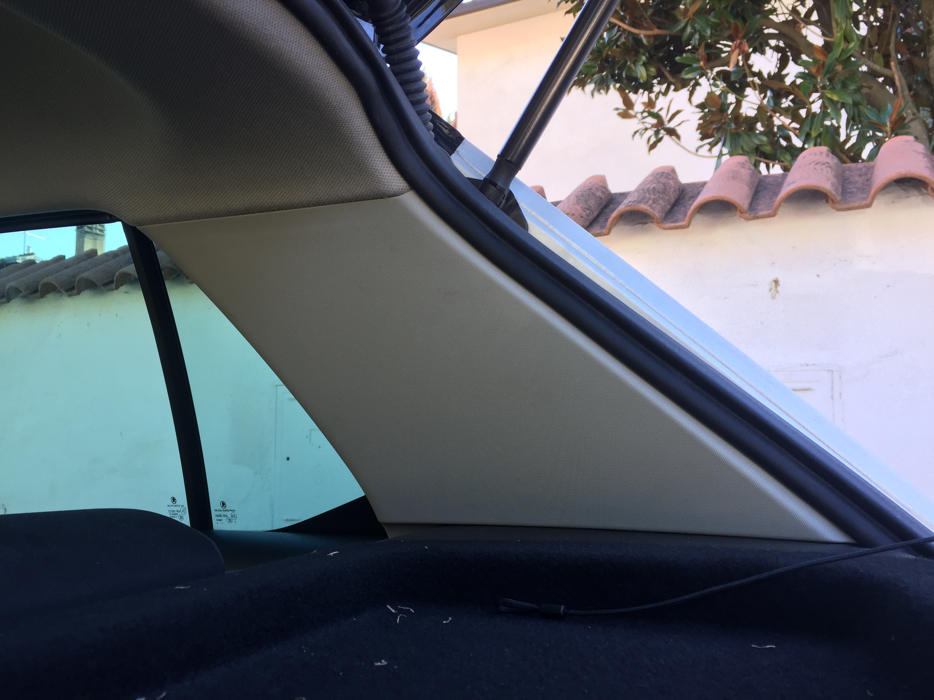

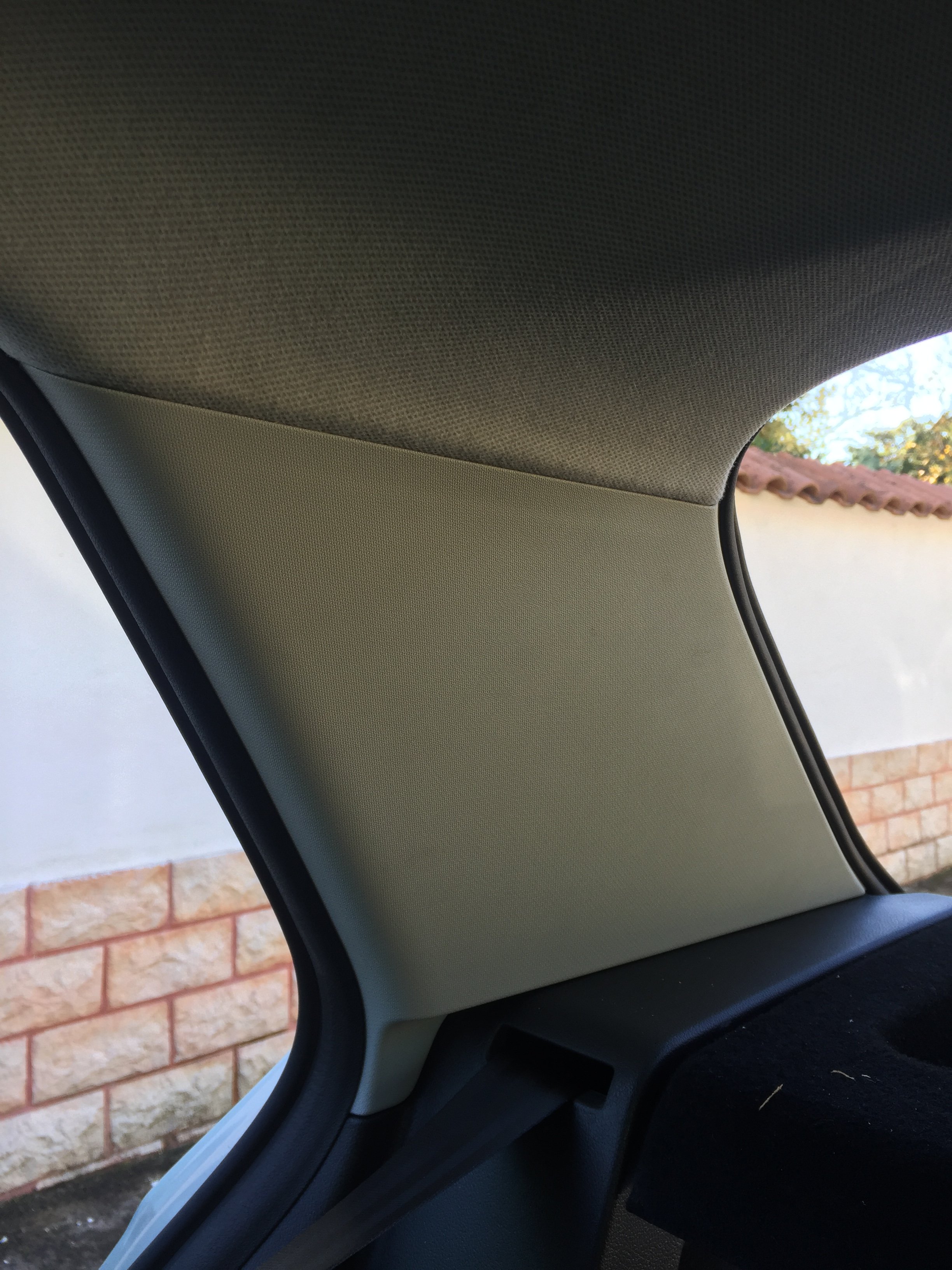

I need to remove the roof headliner and I guess I have to first remove the two C-pillar trims.
Does somebody know how to do this or is there a guide, workshop manual (I don't have access to erWin)?

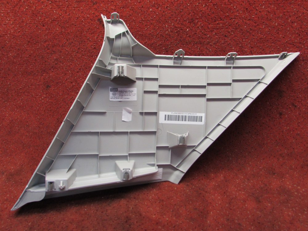

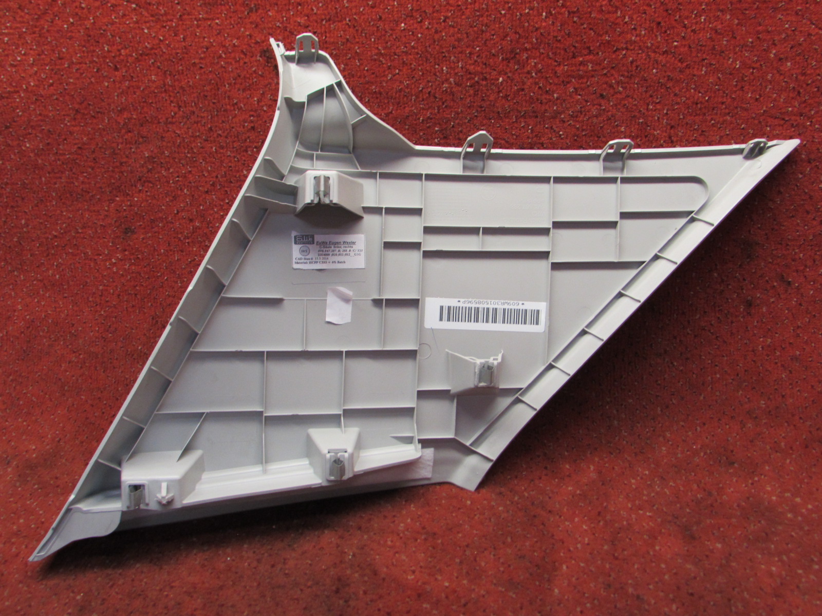

IMG_2356.thumb.JPG.2bb131ac7355c070632fd590dcfbd405.JPGIMG_2358.thumb.JPG.eec6aececfa9abf428db50b7a2a4be32.JPGIMG-9491.thumb.JPG.0c6d9a9c3168f4b92885e56f3ce26980.JPGIMG-9492.thumb.JPG.0715de6d73fa559f7e936205664395a2.JPG
Out of curiosity, their part numbers are 6V6867287C and 6V6867288C

I am not qualified to make this statement as I've not got a Fabia, but, from looking at these pictures, I'd reckon that the first thing that you need to remove is the hard grey wheel arch trim then take it from there. If you look at the upside down picture of the inside of that trim panel, you will see 3 sprung steel clips/grabbers/retainers at the top (bottom on the picture) and 1 sprung steel clip/grabber/retainer near the bottom (top of the picture) - these clips will take quite a bit of effort to remove that trim panel from the car body.
Maybe I'm playing safe here, but I'm sure that you will not want to mark the roof lining.
Edit:- it may well be possible to just grab it near the top and pull it away from the car body then carefully remove the lower end to avoid breaking these plastic clips without taking anything else off?
