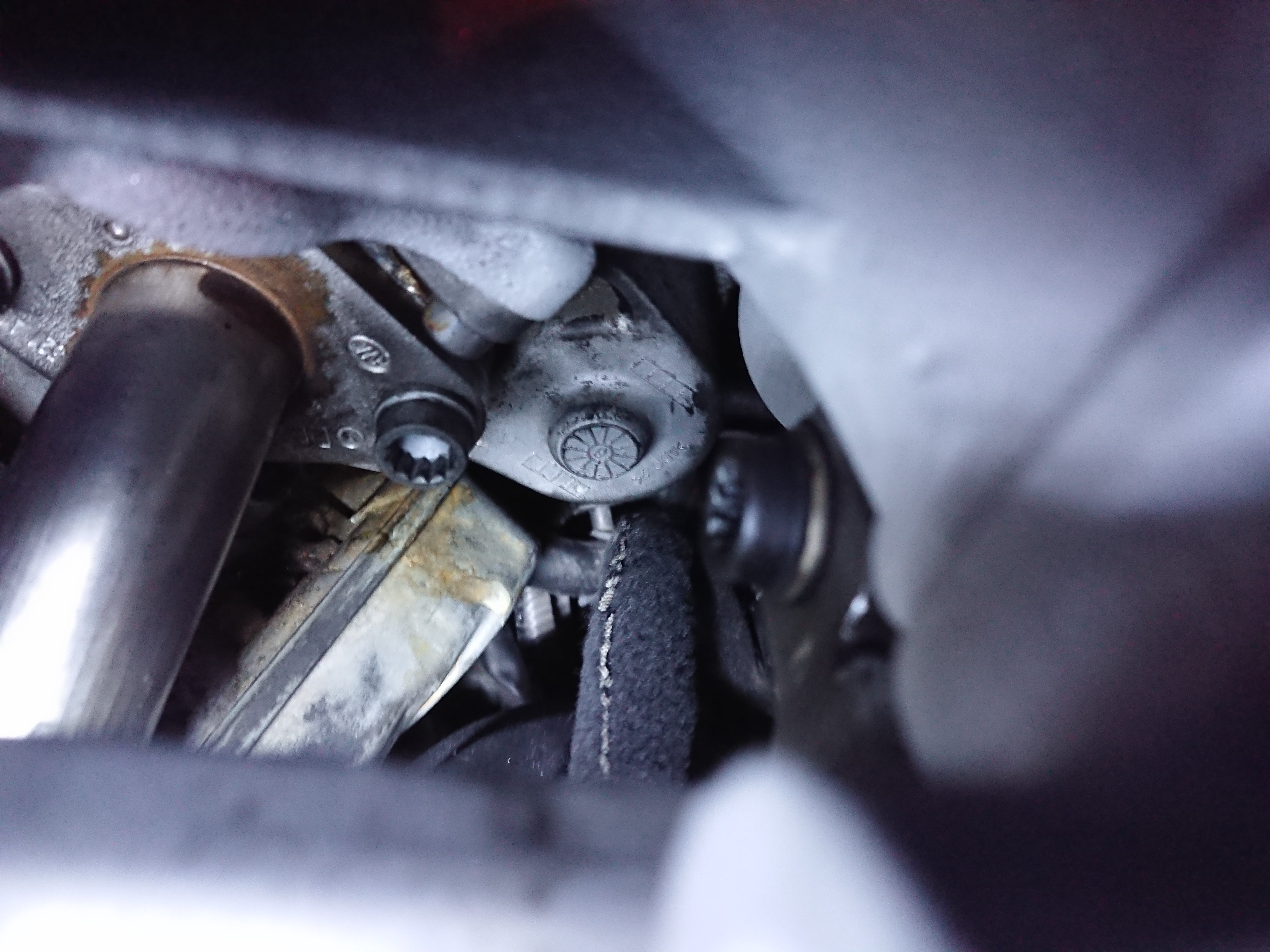

Iv had another look now its light no sight of coolant anyware but there is a slight staining on the egr valve at the front Ware the exhaust gas is pumped into the valve possibly egr cooler fault?
Could be the EGR. There are reports elsewhere of corrosion of the aluminium in the cooler causing leaks between coolant and exhaust gases.

Hopefully my picture uploads showing the coolant staining

On another (closed) forum there is a new report of soot in the coolant caused by a failed EGR cooler. As you have not reported soot then perhaps it makes EGR corrosion less likely.
