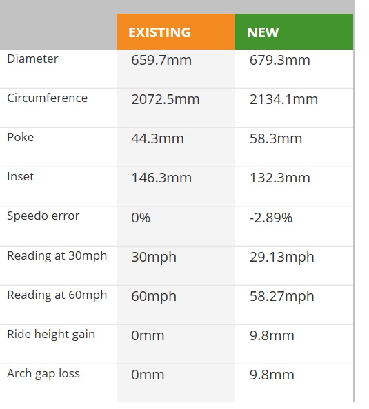

yes they will fit, having them sit further out in the arch at et37 is fine  ( I assume you can take your spacers off?) if not then no they wont fit and will also put too much strain on your bearings.
do you have maxidot? if so there should be a function in the menu to select winter wheels and adjust the speedo but this shouldn't be a problem on this wheel size.
i've done a check below:
long and short, yes they will fit but you may need spigot rings as already advised

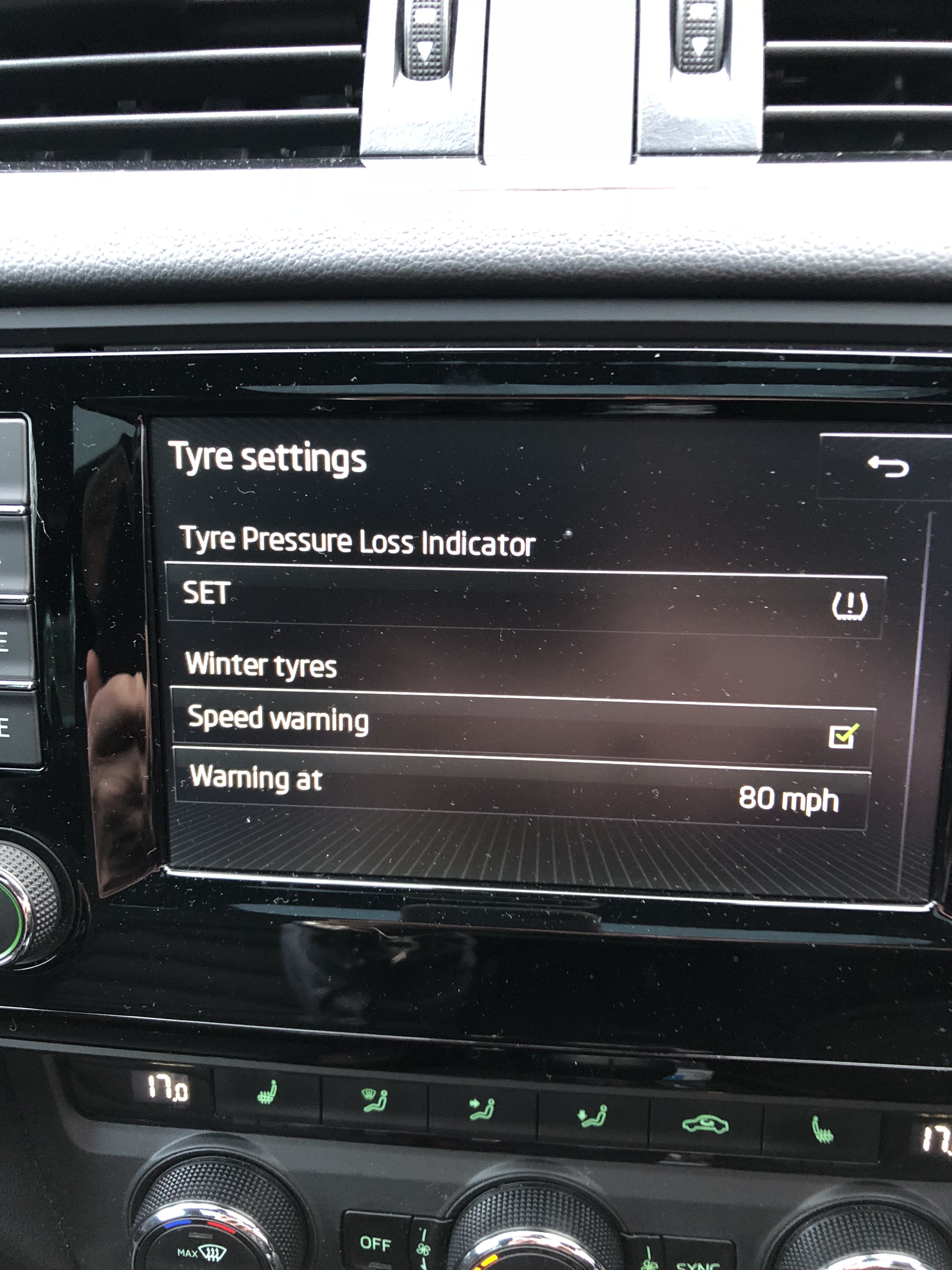

I don't think you can adjust the speedo, the winter tyre warning in Maxi Dot is only  an  " over speed "  warning. You can set it to remind you when you reach a speed you have set it  too. It warns you that you have winter tyres on.
hmm I have an option of 'speedo+/- 1mph' on mine, I'll have a play with it later and see what happens
Strange, I have only the option to set a speed warning on my 230. I too will have a look later and investigate. I'll let you know the out come
Have you had your car from new ? perhaps someone has enabled this function. Making a mistake on resetting the Speedo could result in a speeding fine
Edited by Auric Goldfinger
no, second owner, but the guy before was a enthusiast and had VCDS so enabled everything he could needle sweep, oil temp etc.
THis is all I've got under tyres in the Car settings
