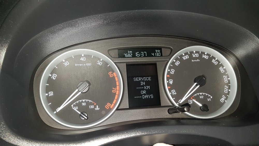

...Hi everyone, i took my fabia to the local dealer for normal service and they set the maxidot as usual after the service but this time i already made 413km and its still appears like this usually after around 300km it will set its self. Does someone can help please?
