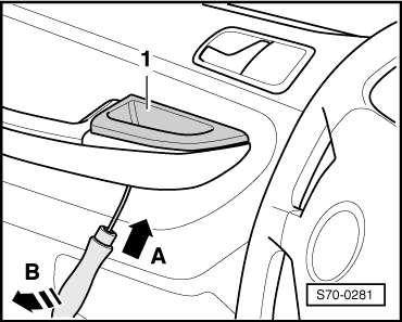

The plastic grab handle has to come off, and you need to shove something up the hole in the bottom of it to release the catch

You can just yank it off. That clip that needs releasing from that hole hardly affects the refitting of the handle if you destroy it.

You might be able to use a thin screwdriver to remove the clip that secures the trim closest to the door card (see #1 below).  I used a trim removal tool to lift the front edge of the trim away from the handle, although I snapped the clip on mine for not following the procedure. As @TMB states it doesn't affect the refitting if you snap the clip, but it doesn't engage quite as well without it :speechless:

I've not seen Wino's method before. I always use a thin tool to lever up the "outside", then, with a torch and thin screwdriver, you can poke the tab to release the inside clip.

The big one needs pushing towards the door. Teh cover can also be a little sticky require a bit of a pull or pry once the big clip is released.
