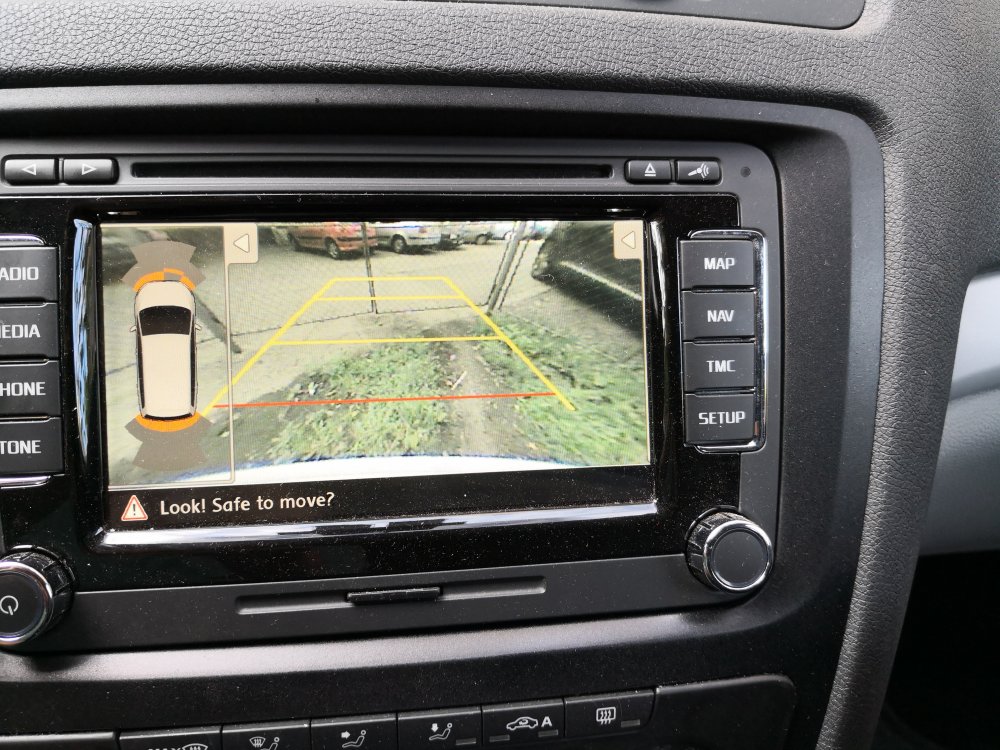

Update:
Finished with:

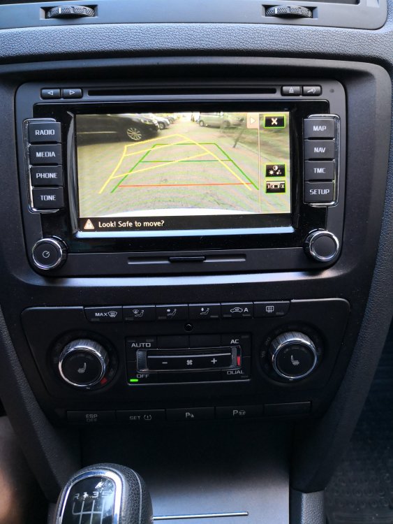

- MFSW. I went and installed original MK2 wheel, as the new MK3 required me to buy new airbag. To expensive for me. Few buttons, but I can live with that.
- Highend RVC. Lot of work for some yellow moving lines. :))
Next... PLA 2.0
Picture with RVC:

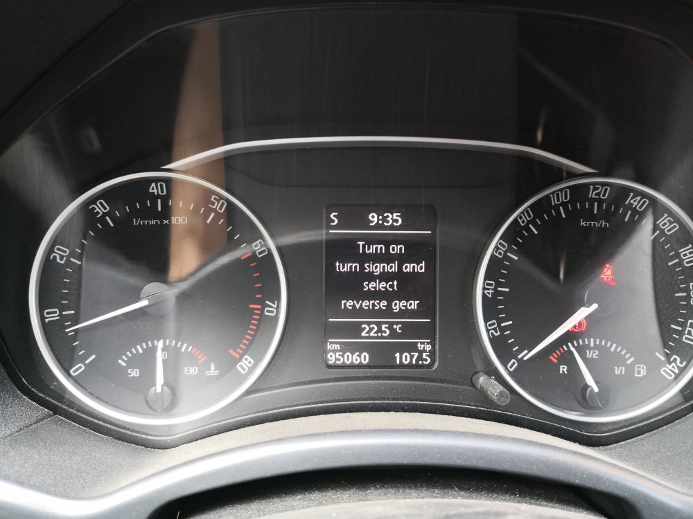

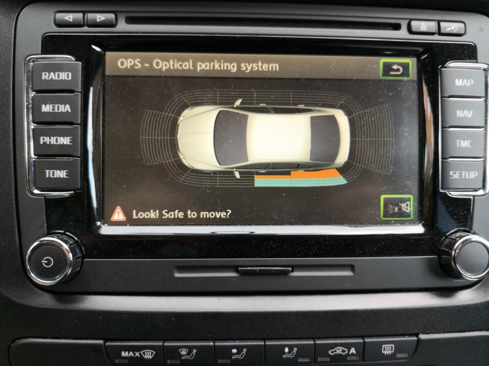

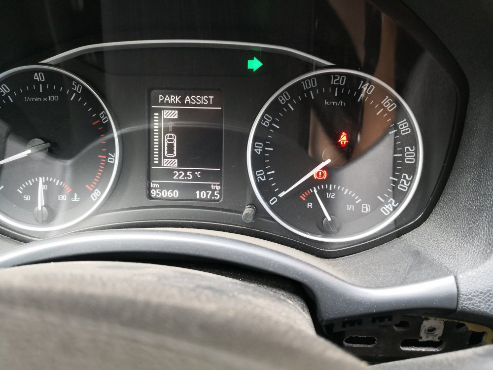

Update:
I'm done with PLA 2.0. Huge amount of work for one person. Removing and installing back the front and rear bumpers are taking lots of time and a bit difficult if you do not have someone to help you. Especially the rear one wich is bigger and difficult to manouver. I'm glad I'm done with it but I would not do it again all by myself.
Glueing the sensors is easy, the bumpers have already marked the places for 8 sensor, you need to figure it out the PDC sensor location.
You need 2 type of hole cutters, 18mm and 28mm.
I have 360 OPS, this will turn on automatically when an obstacle is detected on either side of the car, otherwise it will display only 8 sensors.
Uffff. Done with this.

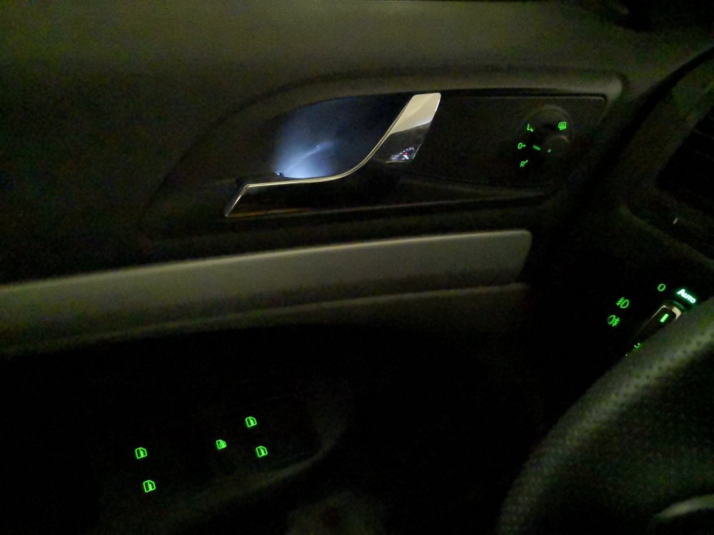

Update:
L&K door handle illumination

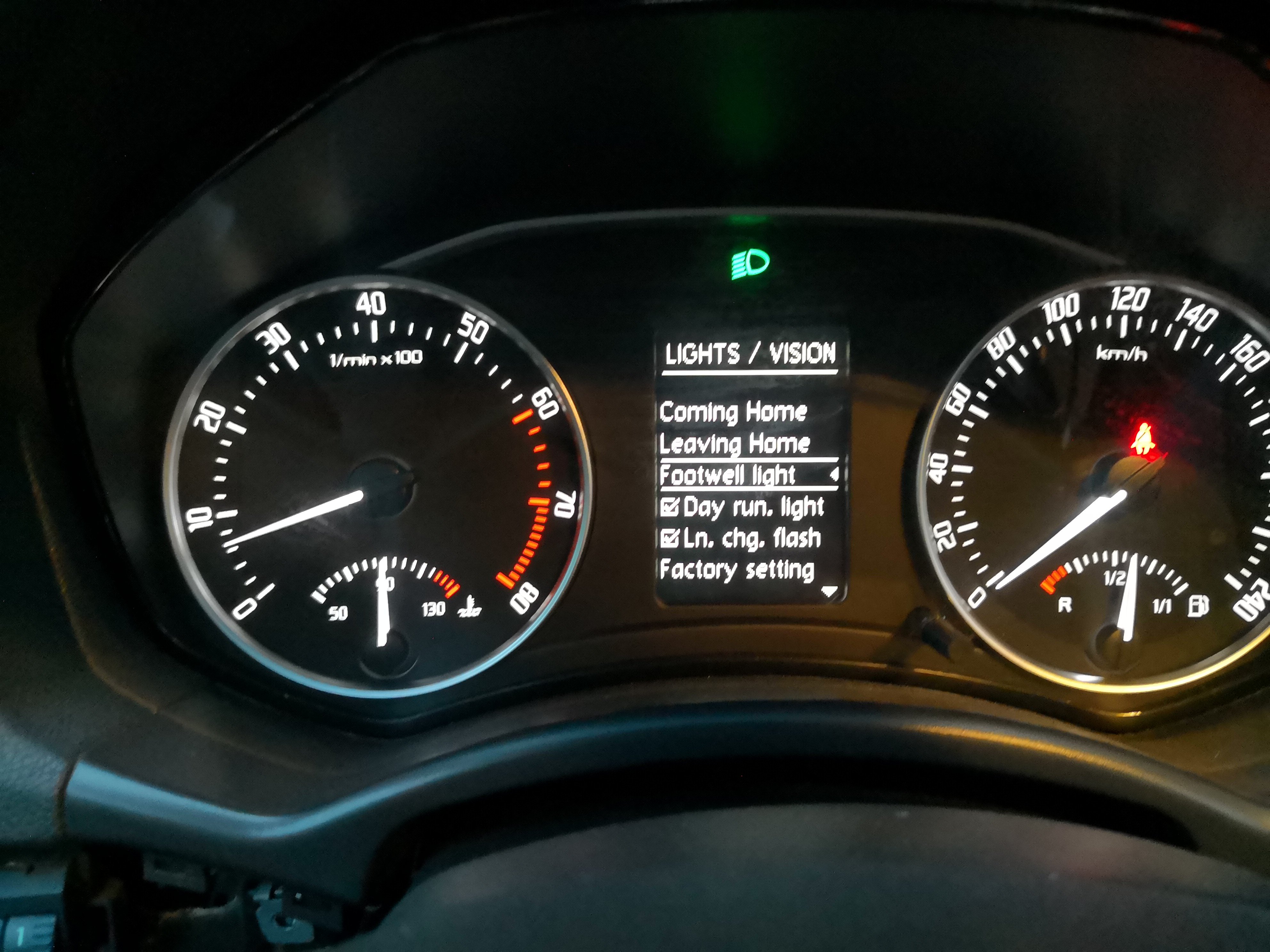

Update:

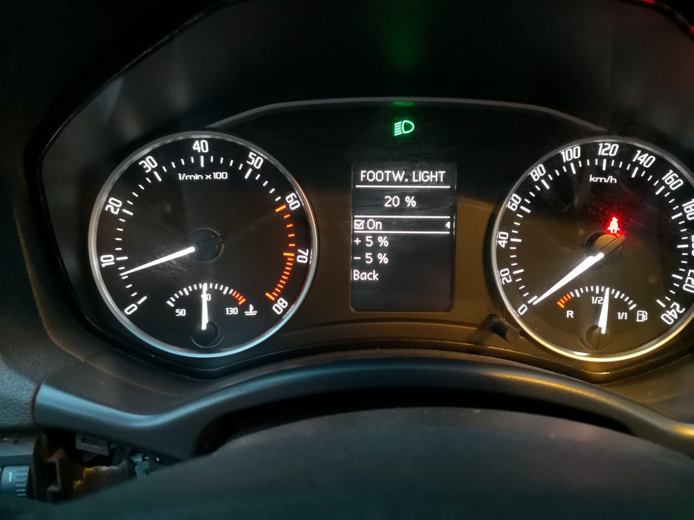

Done with footwell lights.

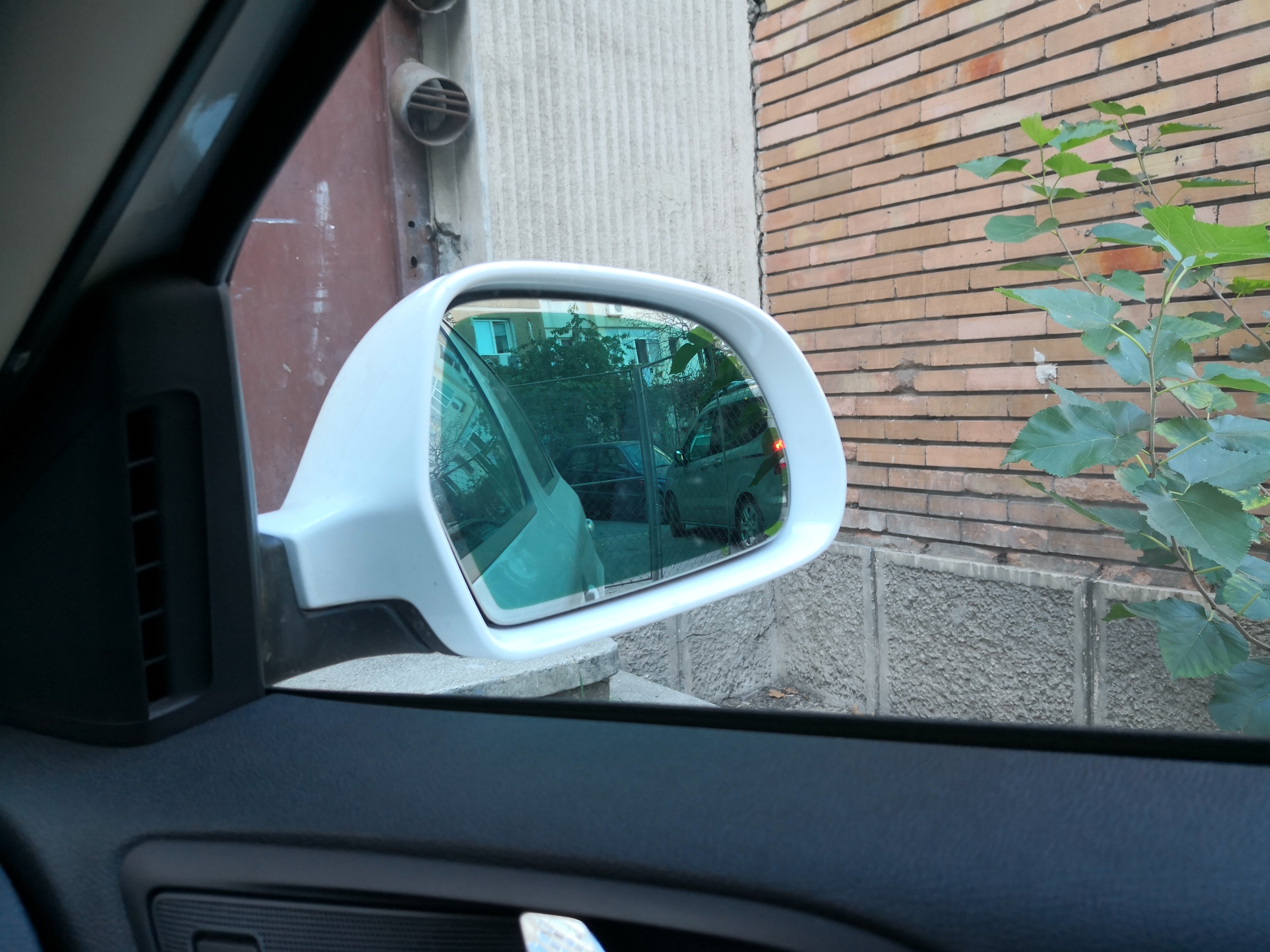

Update:

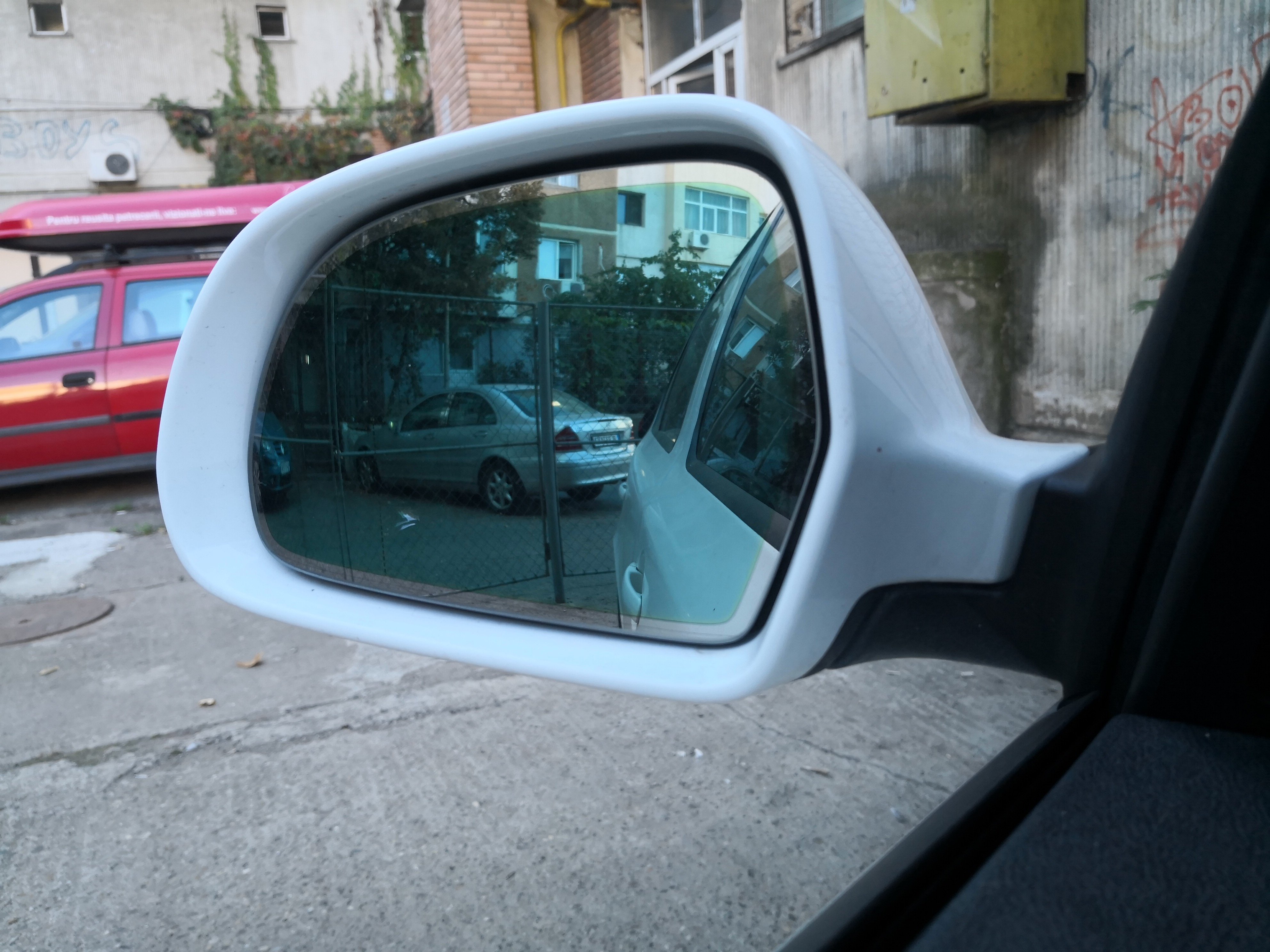

Now I have auto dimming side mirrors. Pretty happy about that.

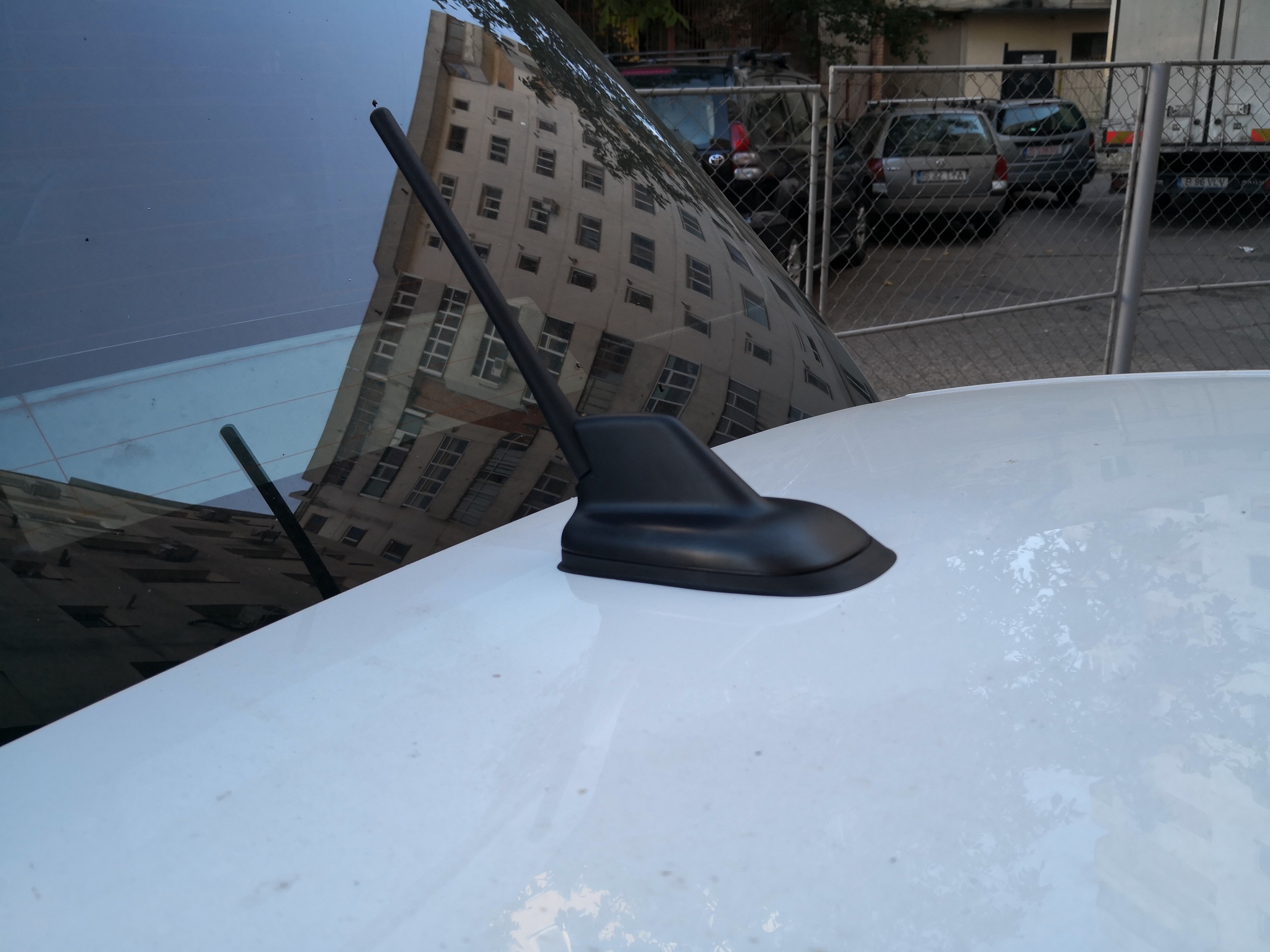

New quadruplex antenna.
After updating to Columbus nav system I install some AM antennas, but had errors with VCDS. So I decided to upgrade antenna too. A bit tricky to run the wiring, but totaly worth it.
