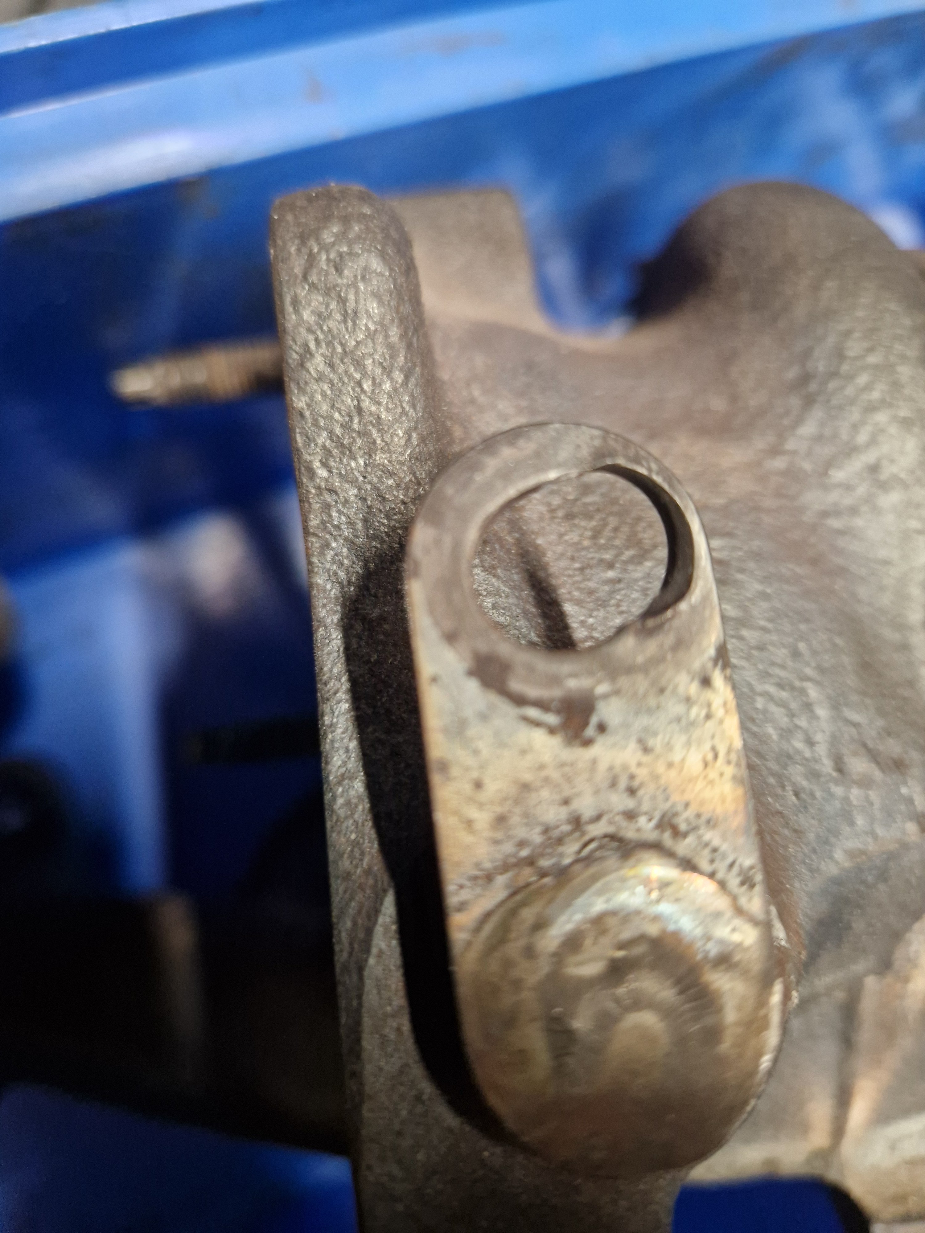

Took a pic just now of the elongation in the hole that the wastegate actuator attaches to on another manifold. A really extreme example I expect.
I think the one on the car isn't as bad as this, but it's easy to imagine the electronics/electrics having a hard time trying to position the wastegate accurately with this degree of slop in the system.
