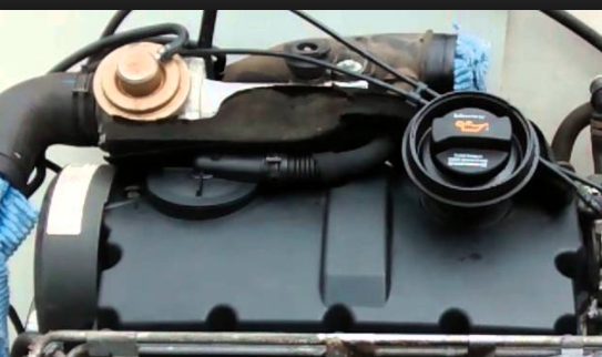

to rule out any egr issues, you can remove the vac hose from the valve which will stop it operating. It may also throw a fault code but at least you will be able to see if its the egr causing the issue
its the top left on this photo the 'silvery/gold' coloured part with the hose on it.

If its the EGR it is likely that disconnecting the rubber/silicone hose to the far left of that photo will allow you a glimse (with a torch) of the EGR.
