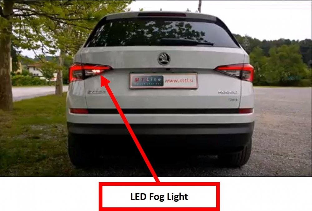

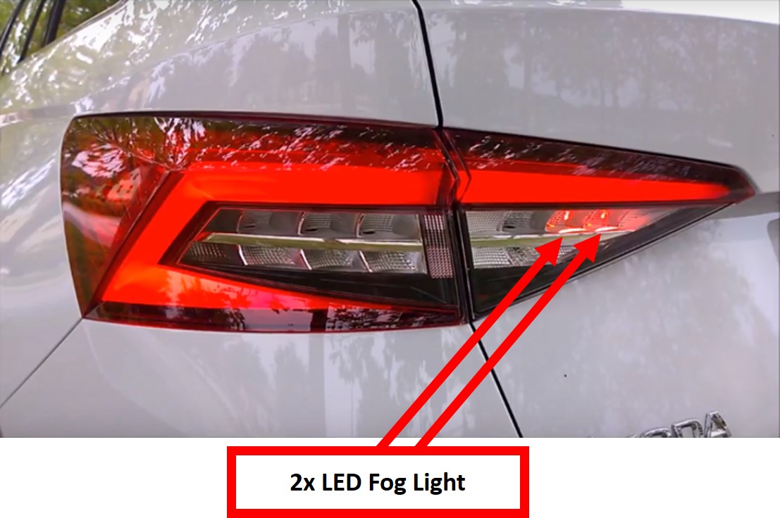

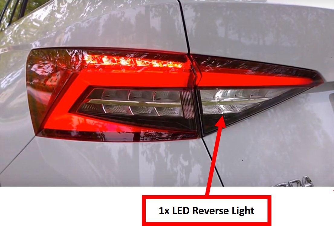

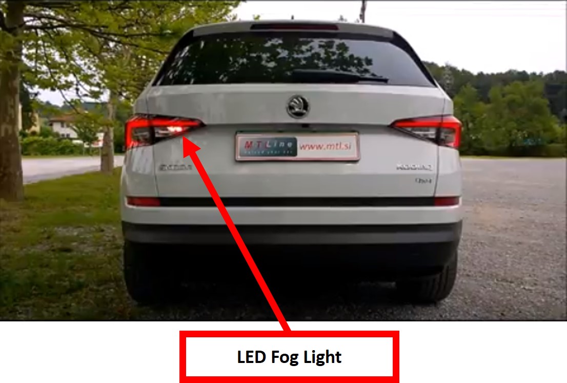

You can see from this video that of the three 'inner' LED's on the boot-lid only one of them is assigned to the reverse light function, little wonder they don't light up much behind you!

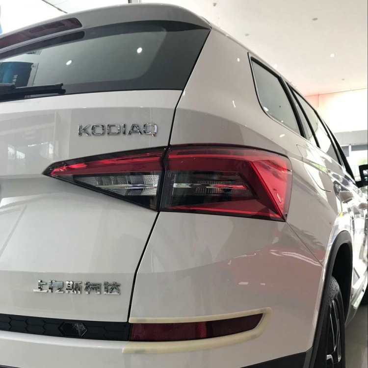

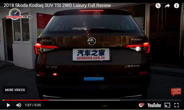

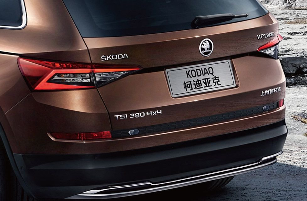

Appears models for china market have additional rear reversing lights in bumper trim below the TSI 380 4x4 Badge between the bumper reflectors?
Wonder if the trim can be purchased and fitted to uk spec cars?

Good spot, I've just been on the skoda.cn website and they are indeed additional LED reverse lights.
Clearly the Chinese also viewed the European reverse light set-up as wholly inadequate!

I notice the video clip above show a pair of reversing lights (#Silver1011)

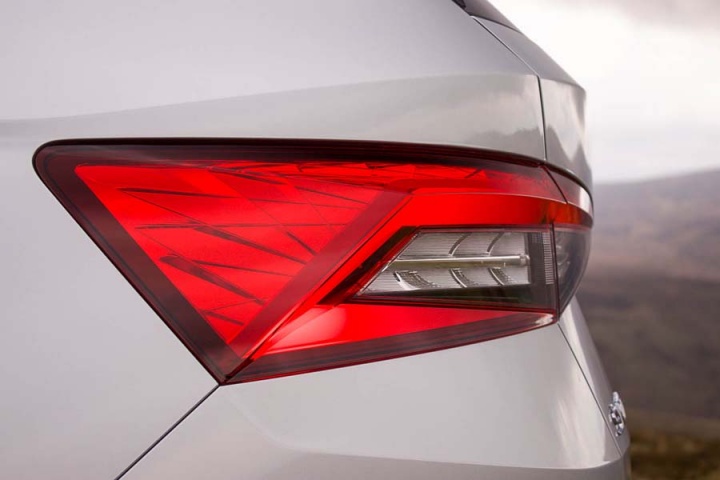

The 'S' and 'SE' models get what Skoda refer to as the 'low functionality' rear lights which I believe are made up as follows:
Tail lights - LED
Brake lights - LED
Fog Light - LED
Reverse Light - LED
Indicator - non-LED
This is what they look like, you can see the regular incandescent indicator bulb behind the integral chrome strip on the main (not boot lid mounted) cluster...

All models though should have twin rear LED reverse lights, although they are pretty poor in terms of light output (1x LED on each side).
(Incidentally you can see above the additional factory fitted LED reverse lights in the honeycombe section found on the Chinese Kodiaq).
Here are some images of the reverse light set-up you should see on all UK models...
5a64abe108c09_SkodaKodiaqLEDReverseLight(1).thumb.jpg.388498650b27d63c7ca379c2f5a28b5f.jpg
5a64abe70e51b_SkodaKodiaqLEDReverseLight(2).thumb.jpg.513a94235a55c8c4b9dc5523f88cbe27.jpg
And the single rear fog light... (note this is a mainland Europe (left-hand drive) model in the pictures so the single fog light is on the left, on UK models it would of course be on the right (offside)...

Just seen that those extra LED's on the Chinese models aren't reverse lights, they're the fog lights...

Pleased to note that the 'High Functionality' LED rear lights (SE L, Edition, Scout & SportLine) have symmetrical reverse lights, i.e. one LED on each side.
The 'Low Functionality' LED rear lights (S & SE) make do with one side, the wrong side (UK).
I also noticed that the S and SE don't get the fancy 'jewel' effects on the side flank, although I couldn't find a picture, this image shows the effect that's missing on the lower specs....
