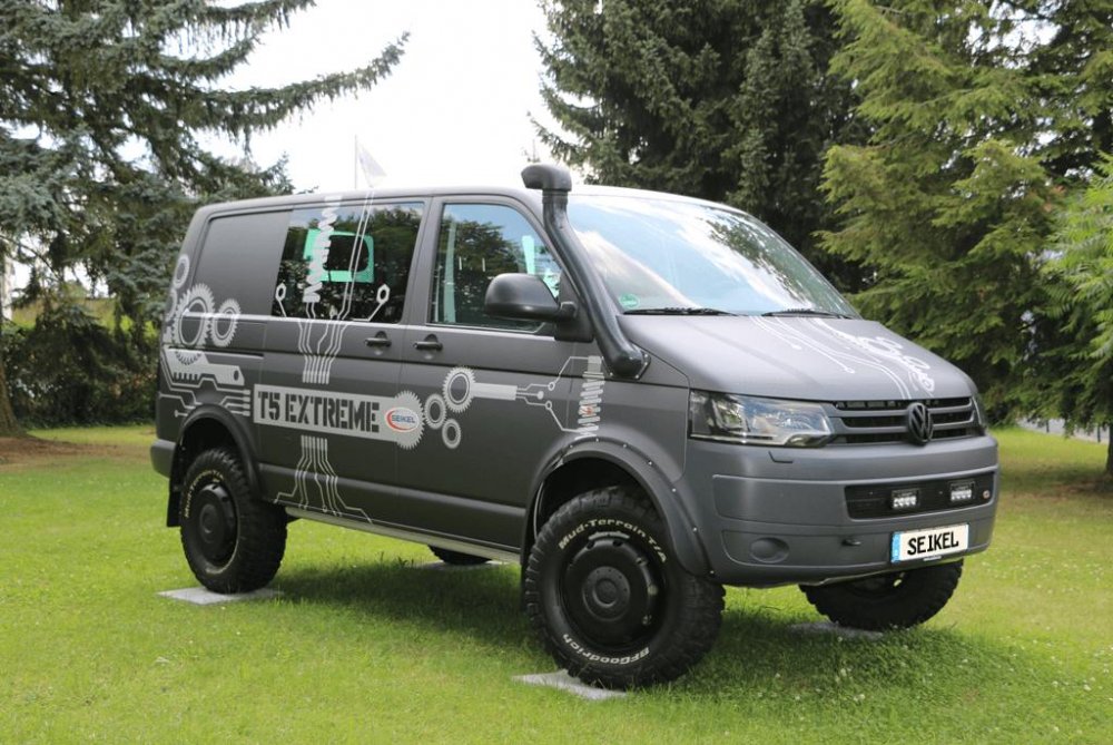

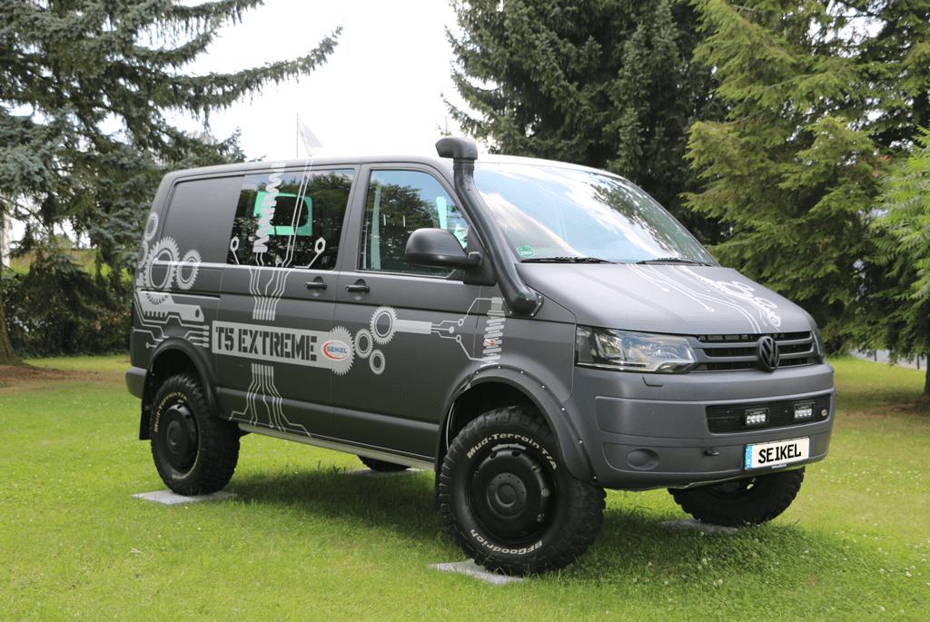

Where do you think proper off roaders would be if you did not change wheels and tyres on some, totally legally.

You ought to see the outrageous 4WD devices on our roads that take on our mountain tracks and then park beside you in the supermarket car park.

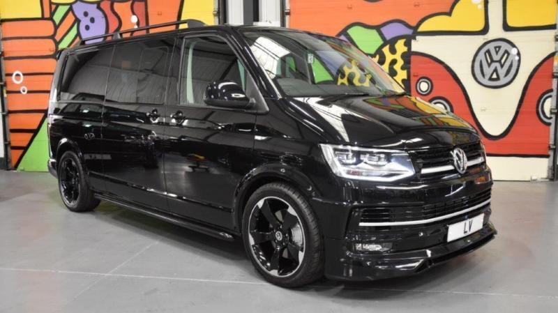

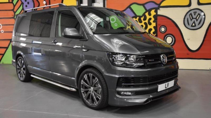

How ABT Sportsline Models are running the Factory fit Wheels & Tyres.
http://abt-sportsline.com
http://oponeo.co.uk/wheels-for/skoda/yeti
Maybe how non Factory Fit Towbars or sold by them or their dealers but which are EU Approved / TUV ones can not be fitted because they were not an option fit at the car manufacturers factory.
How lowering springs or lift springs were not type approved or the Dealer Fit option ones so illegal.
The ones that Skoda Fleet can supply for Emergency Services Skoda Models in the UK.
