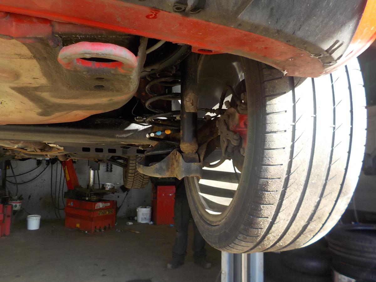

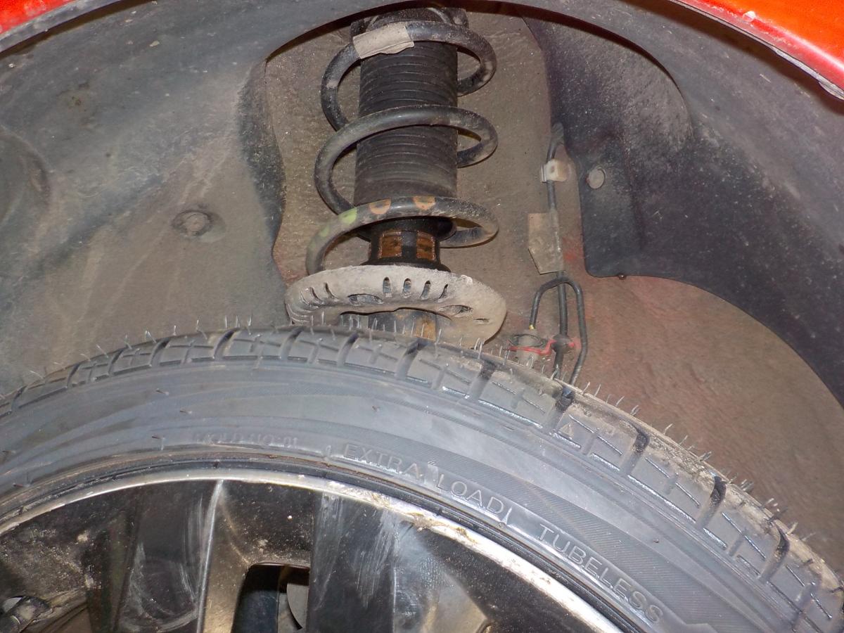

Snapped spring, you can jack up and still not see it, can be top and bottom.
So you need to see if standard springs or lowered.
*Drive very very carefully if you have to use the car.*
Edit.
Sorry, no matter what is on now then if new going on.
I have broken ones at this time of year before, cold and going on or off a kerb parking..... Drivers side ones.
Passenger side standard, and rear standard, more expensive than lowering springs.

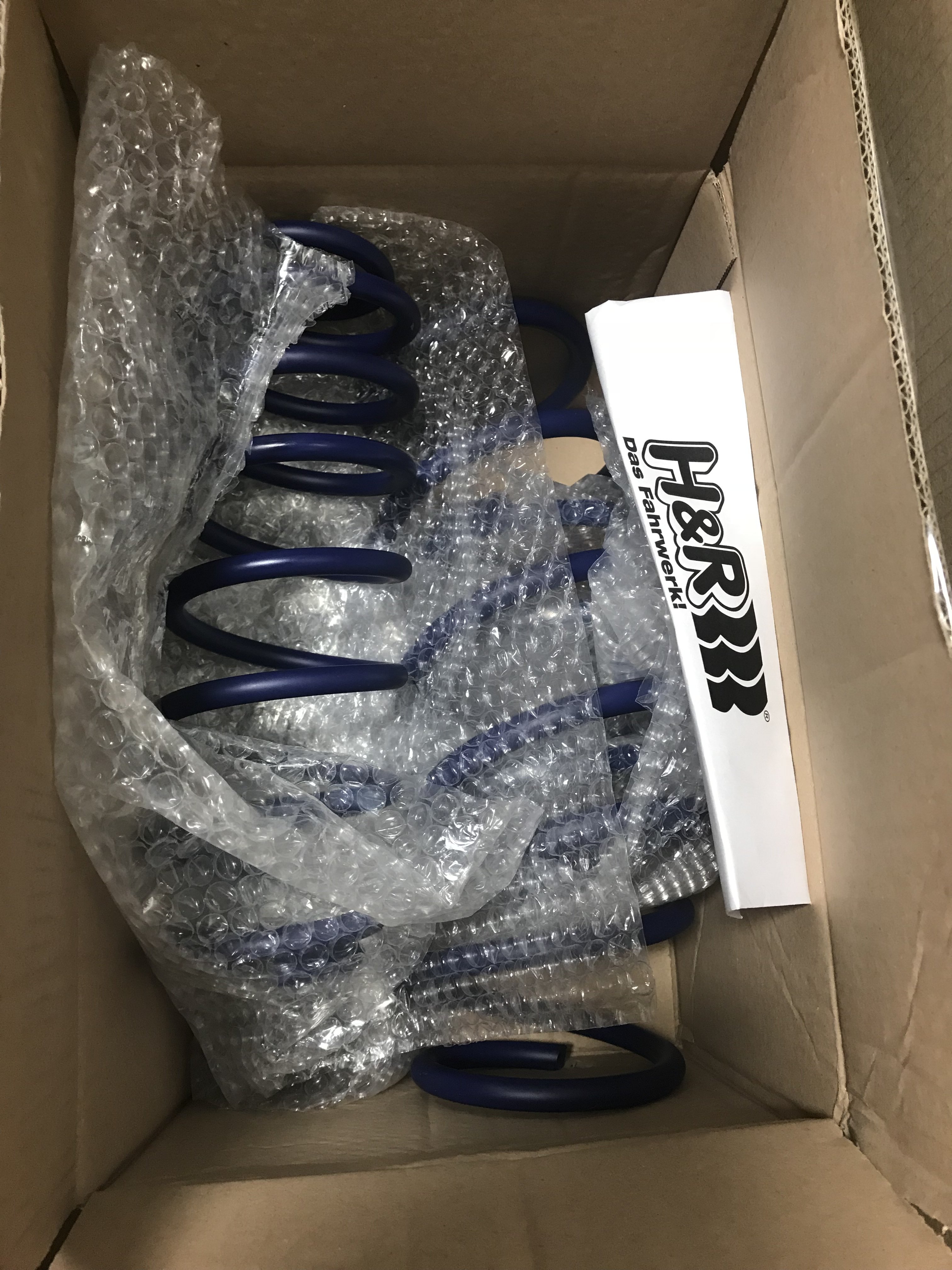

Ive got 40mm H&R’s arriving Thursday, I might just play it safe and replace the top struts as the cars well over 5 years old now.
I had a lot of issues with my old Fabia’s suspension parts, replaced the top mounts and front springs and they were both gone 2 years later albeit they were cheaper parts than OEM.
Your dampers might give up soon than later after those H&R get fitted.
