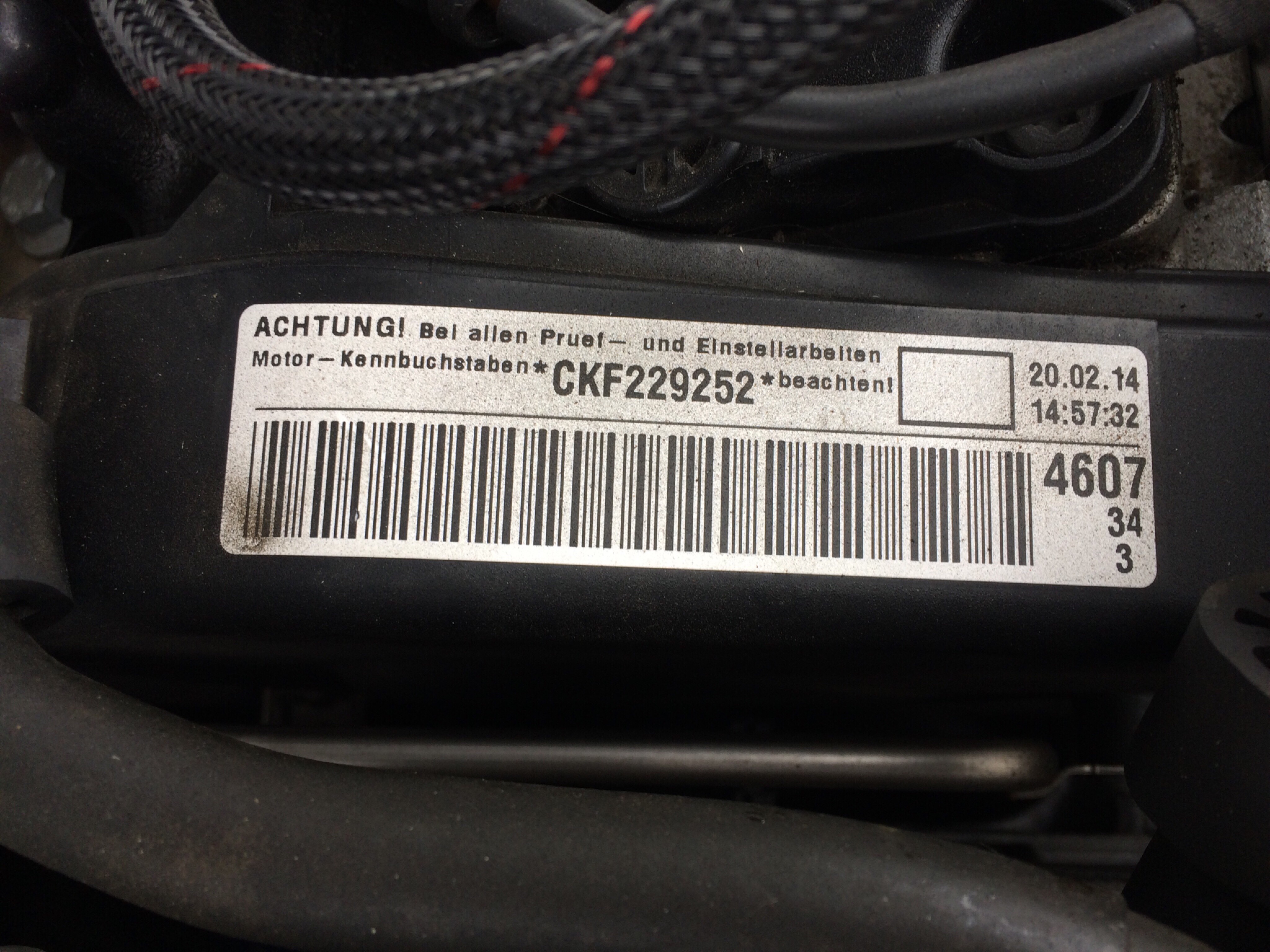

Evening all.
I have the dreaded water pump failure (2014 Octavia)
I e had a dealer tell me it’s an electric pump and another say it’s cambelt driven. Plus 2x independents tell me the same (one says elec, one says Cambelt)
can anyone one tell me what to look/where to look to confirm what it is?
thanks
