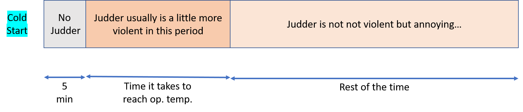

I have an engine judder at idle which can sometimes by anoying...
The reason I am asking is because some time ago when we drove through Germany we topped up with the more expensive diesel from Araal and the judder was almost gone. So I am thinking it might have had some kind of additive that helped clean the injectors.
Now I can't just drive down to Germany to top up with good diesel every time and the Ultimate Diesel is pretty rare at the Danish pumps so I would like to hear if anyone did the above procedure and if it helped at all.
I must say I have eliminated most all of the other possible causes (flywheel, tandem pump, engine mounts, aux belt & rollers) and the last ones are the injectors and although the deviation is not high, the judder can be felt...
Cyl1..........0.4-0.6
Cyl2.........-0.1-0.2
Cyl3.........-0.1-0.2
Cyl4..........0.5-0.7
The picture shows a timeline of how it feels. Can only be felt at idle speed.
It is more violent when braking to a stop while in neutral and when standing still and revving between 1100 and 1300 rpm.
