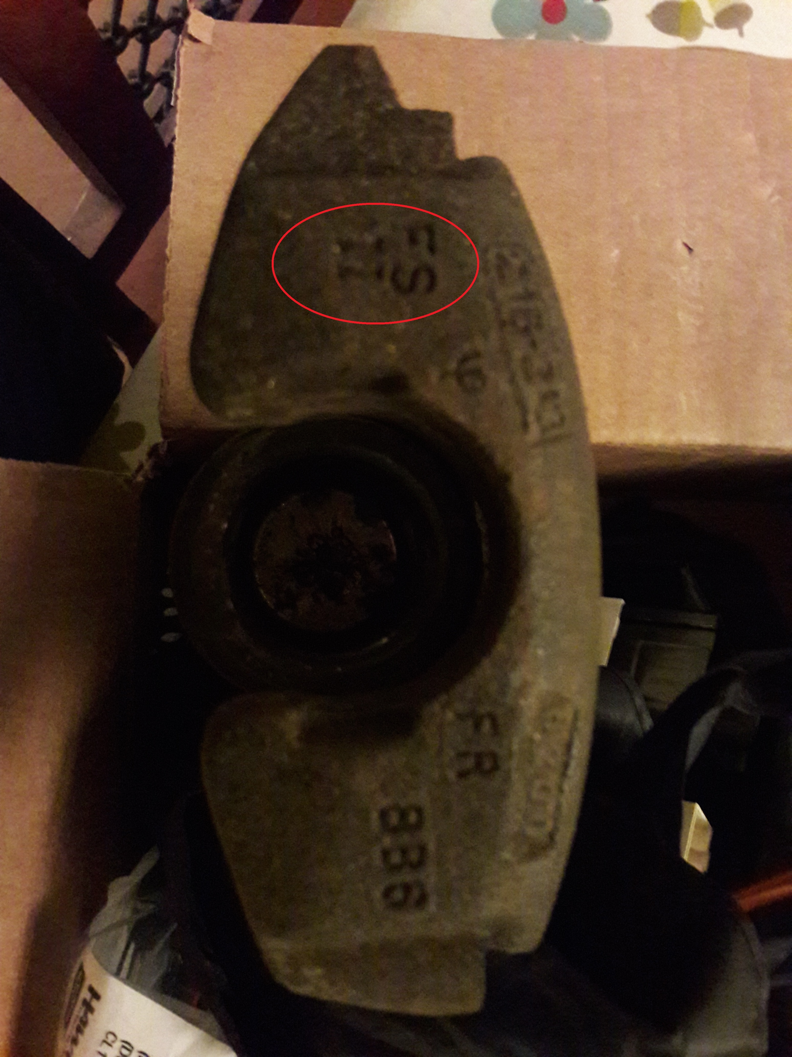

Depends what size discs you have. If they are 256mm, I think the 7mm Allen is correct. If 239mm I think it's a 6mm Allen.
One way to tell which you have is by lettering on the outward facing side of the caliper, FSII = 239, FSIII =256.
The disc retaining screw might be a torx, can't remember the size though, maybe Tx30?
Thanks for that my old discs are 256 diameter, so looks like 7 mm Allen key is the one.
