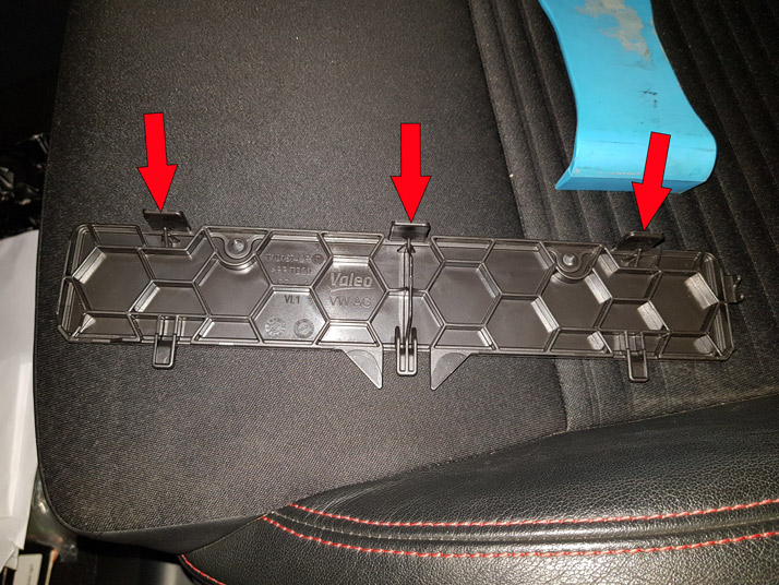

It is behind the glove box so really easy to change.
Remove the glove box and press down on the tabs arrowed, pulling the cover toward you and up.
Just pull the pollen filter toward you and reverse to replace
