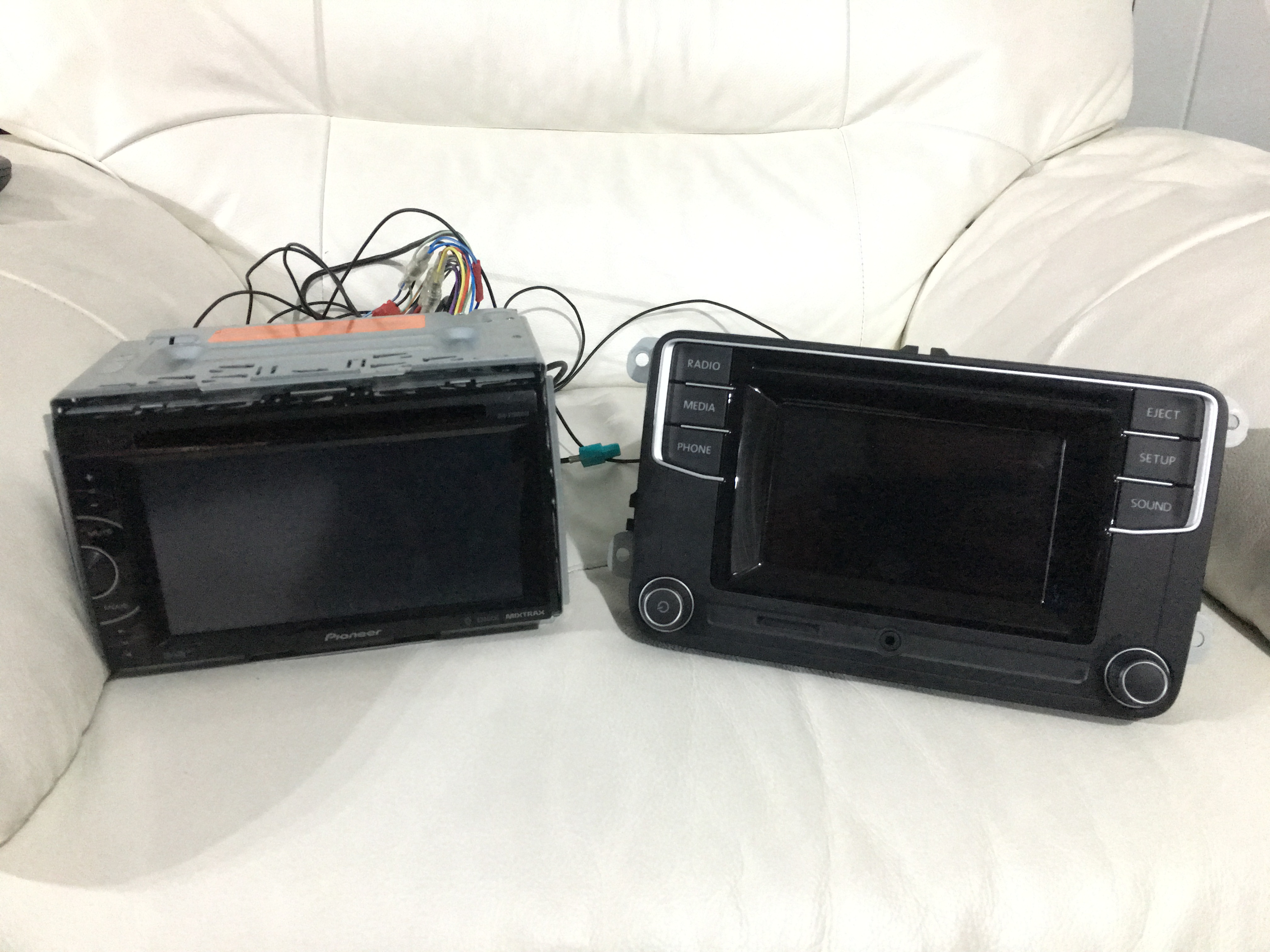

Cheers guys. I’m picking up a Yeti next week and couldn’t make it out from the picture. It looks similar to the headunit I’ve had previously which was DAB.

Fortunately I do have a MIB2 DAB headunit from a 2017 VW Caddy which will fit straight in with an added DAB aerial. I was only reluctant as the back light is red rather than the Skoda green, so I was hoping it already had DAB.

i collected the Yeti today. Absolutely loving it! Just a follow on question from my original post. If I remove the headunit and fit an aftermarket one, will I lose the rear parking sensor sound? Or will I just be losing the visual display from the OEM headunit?
hopefully someone has some experience of what happens when replacing it for an aftermarket headunit.
Thanks again for any help
I still have it, I’m just weighing up on what to do. As the wife likes the old aftermarket headunit which has DVD for the kids, which I forgot about. Since picking up the car though I didn’t realise it had the visual display going through the headunit too. So I’m wondering if the headunit also works the acoustic sensor sounds too

The reversing sound is from a speaker in the rear of the car, not from the head unit.
As regards the MIB unit, have you had Component protection removed for it to work?

No I haven’t, though I have read about this before so I was going to try and see what happens. I presume I’d have to get this sent off to be removed?

Try it and see what happens, and you'll end up with a brick. Some units can be fixed, but it's not cheap getting them done I'm afraid.
Thanks for the advice!! Now i know the parking sensor sound is done separately I'm happy to fit the aftermarket headunit in now. Everyone's help greatly appreciated!
