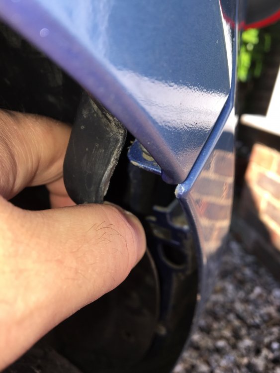

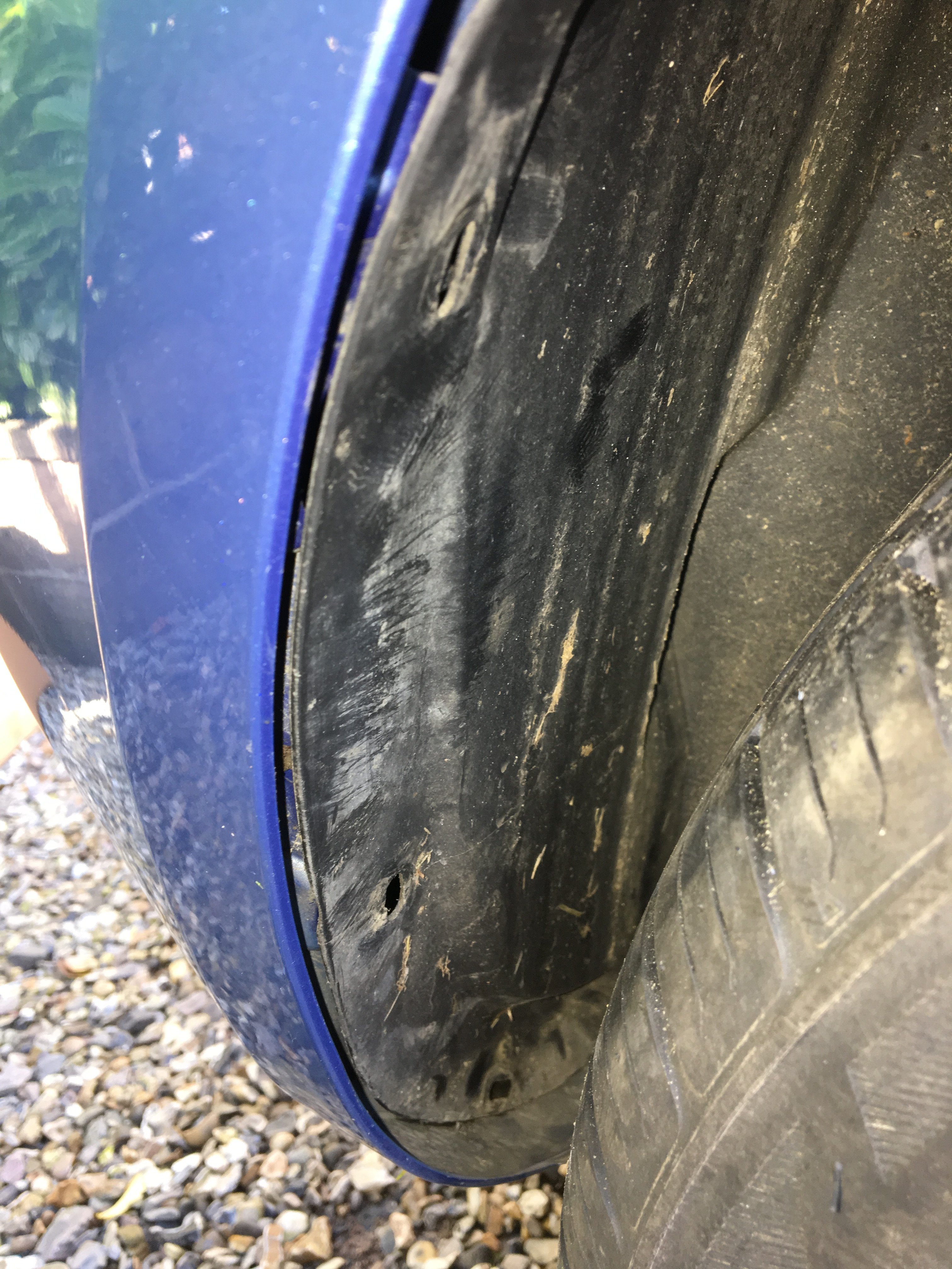

removing the screws around the wheel arch liner. Ratchet/socket for these.

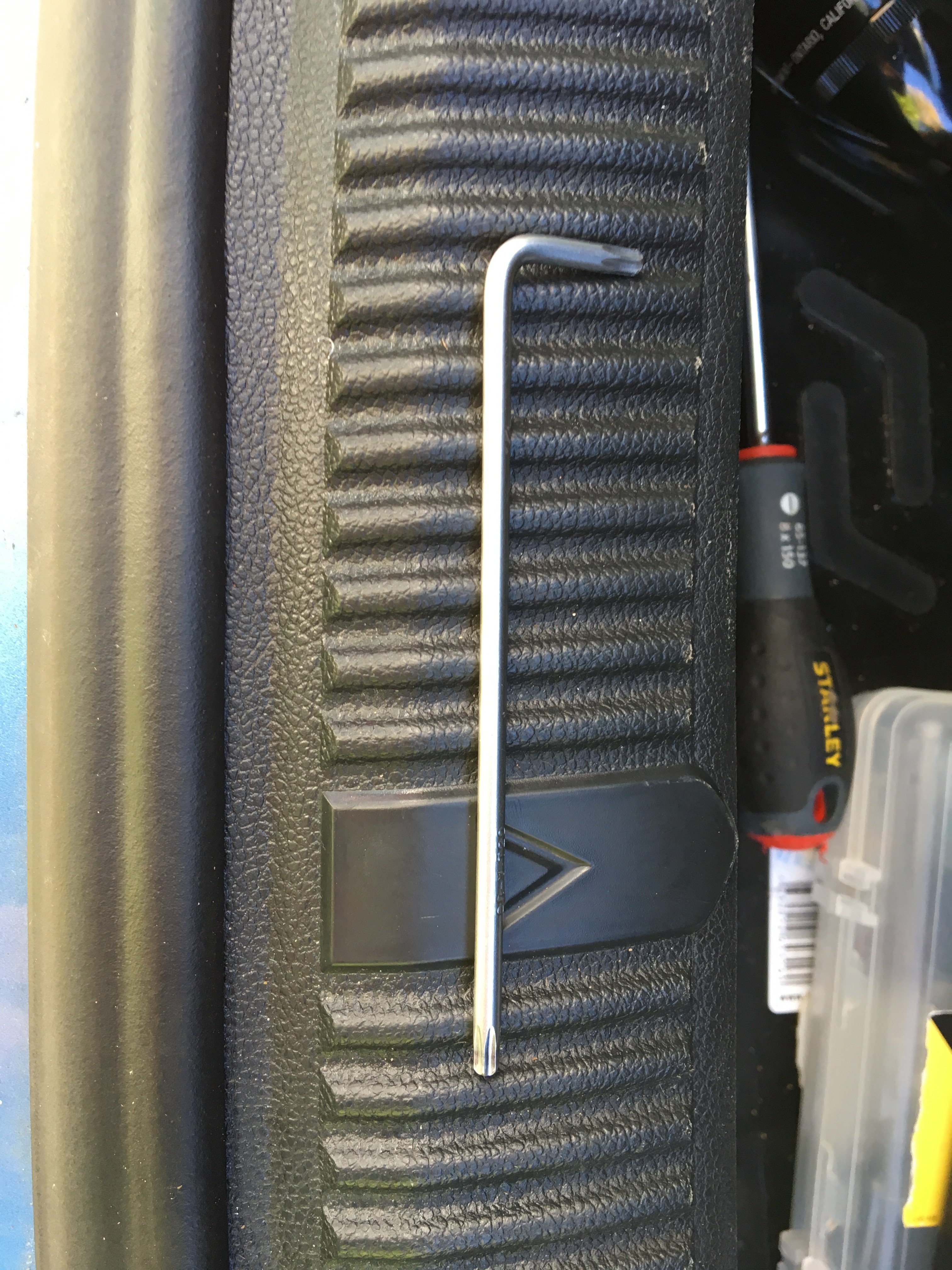

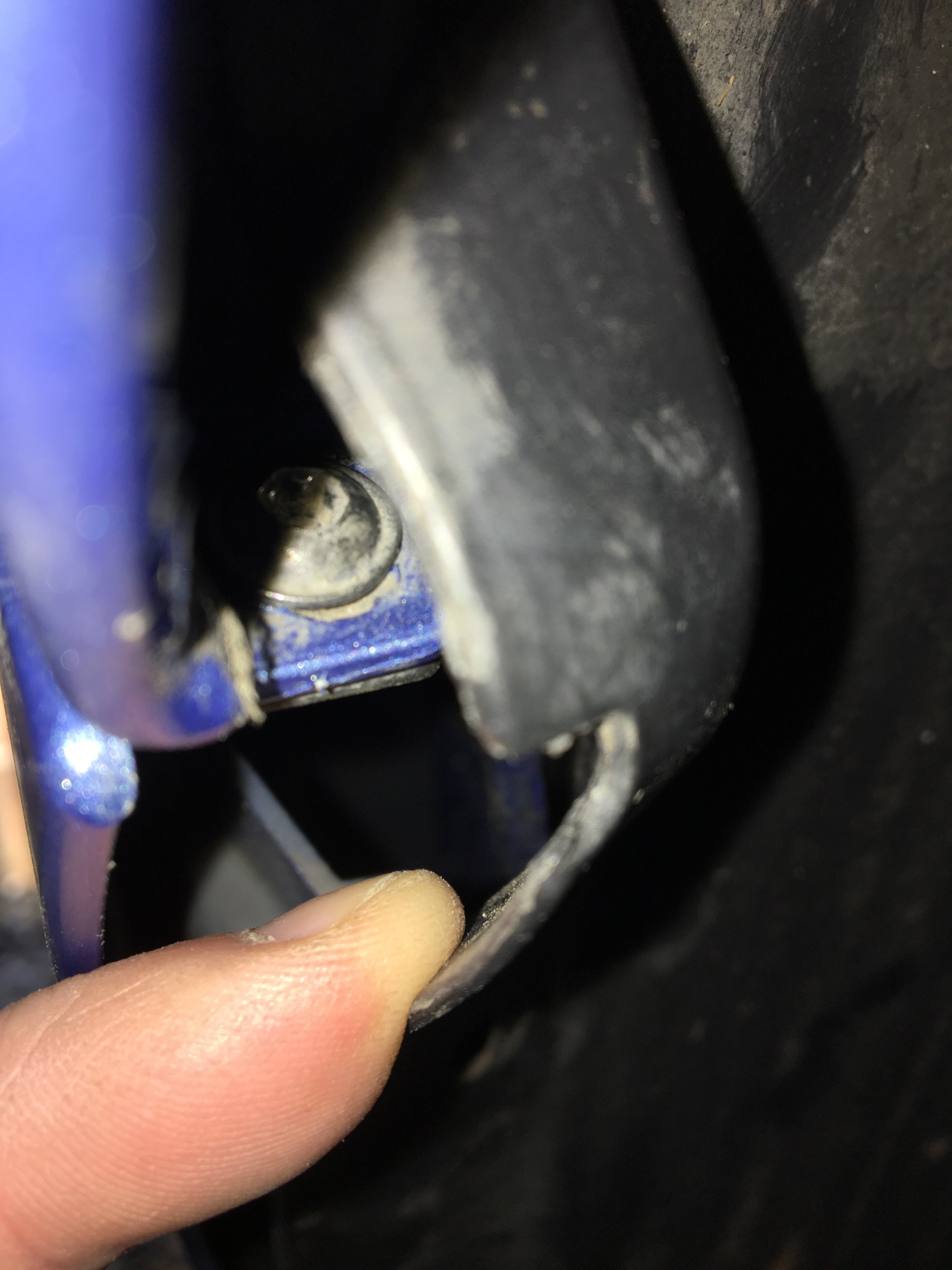

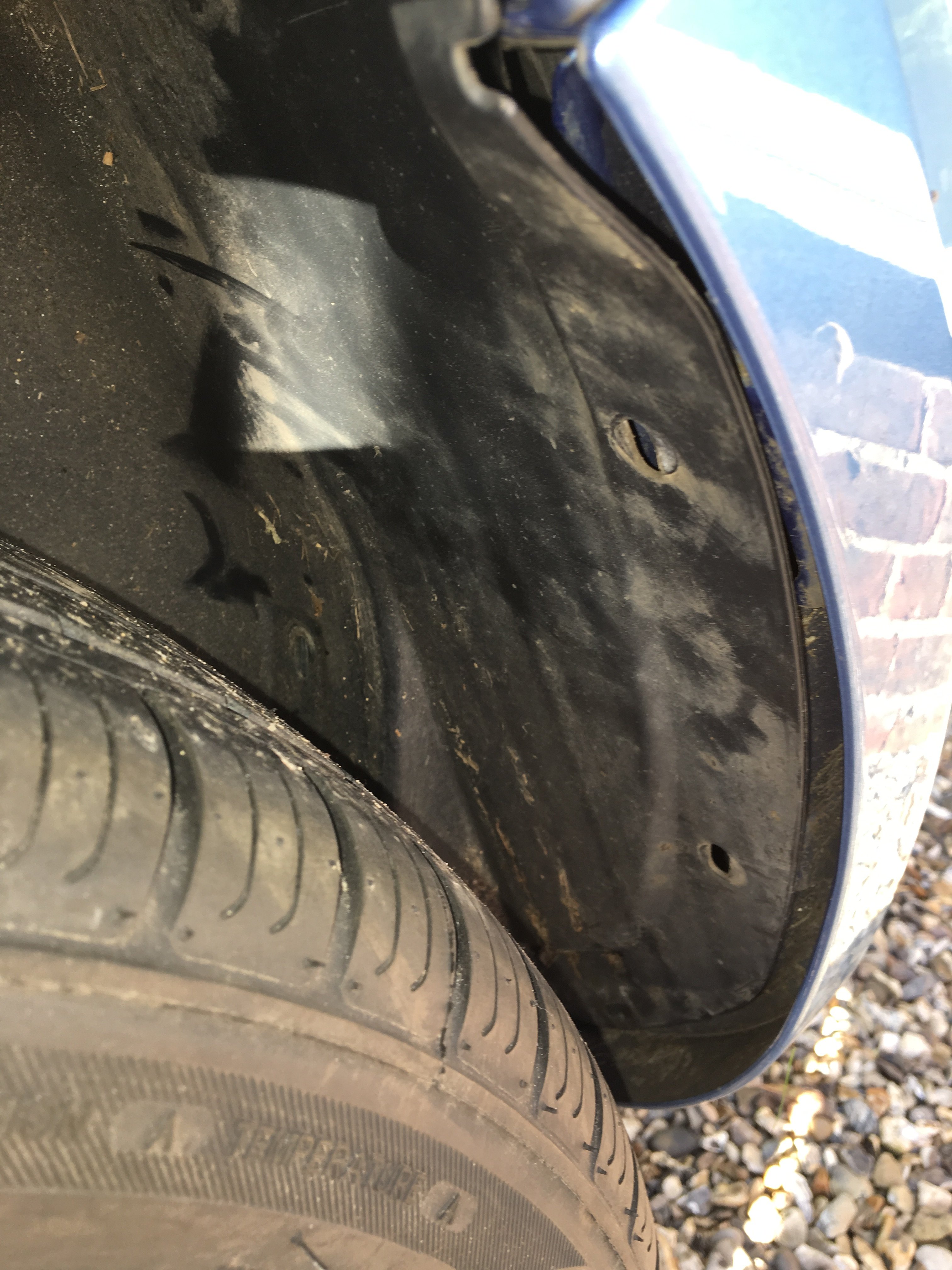

removing the screws inside the top of the wheel arch liner. Ratchet didn’t fit. Torx key did the job. Got enough room by being a bit brutal with the wheel arch lining... turns out it’s hard to damage so being rough with it is alright.

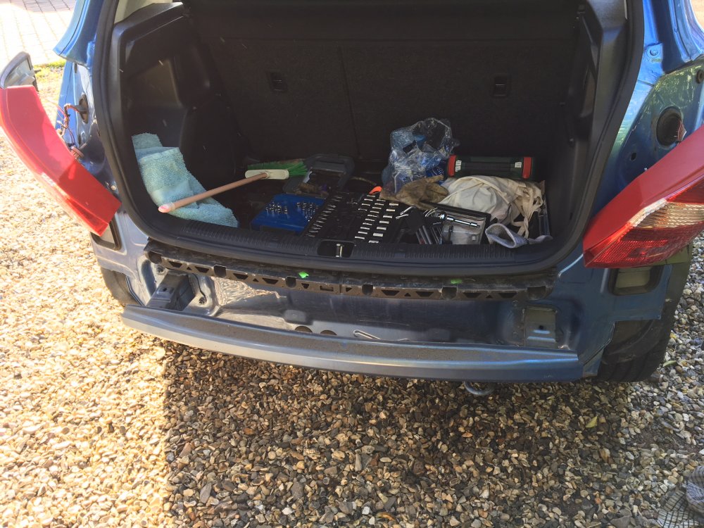

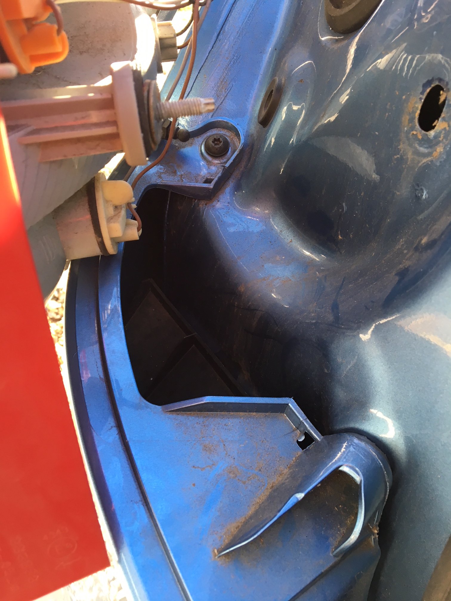

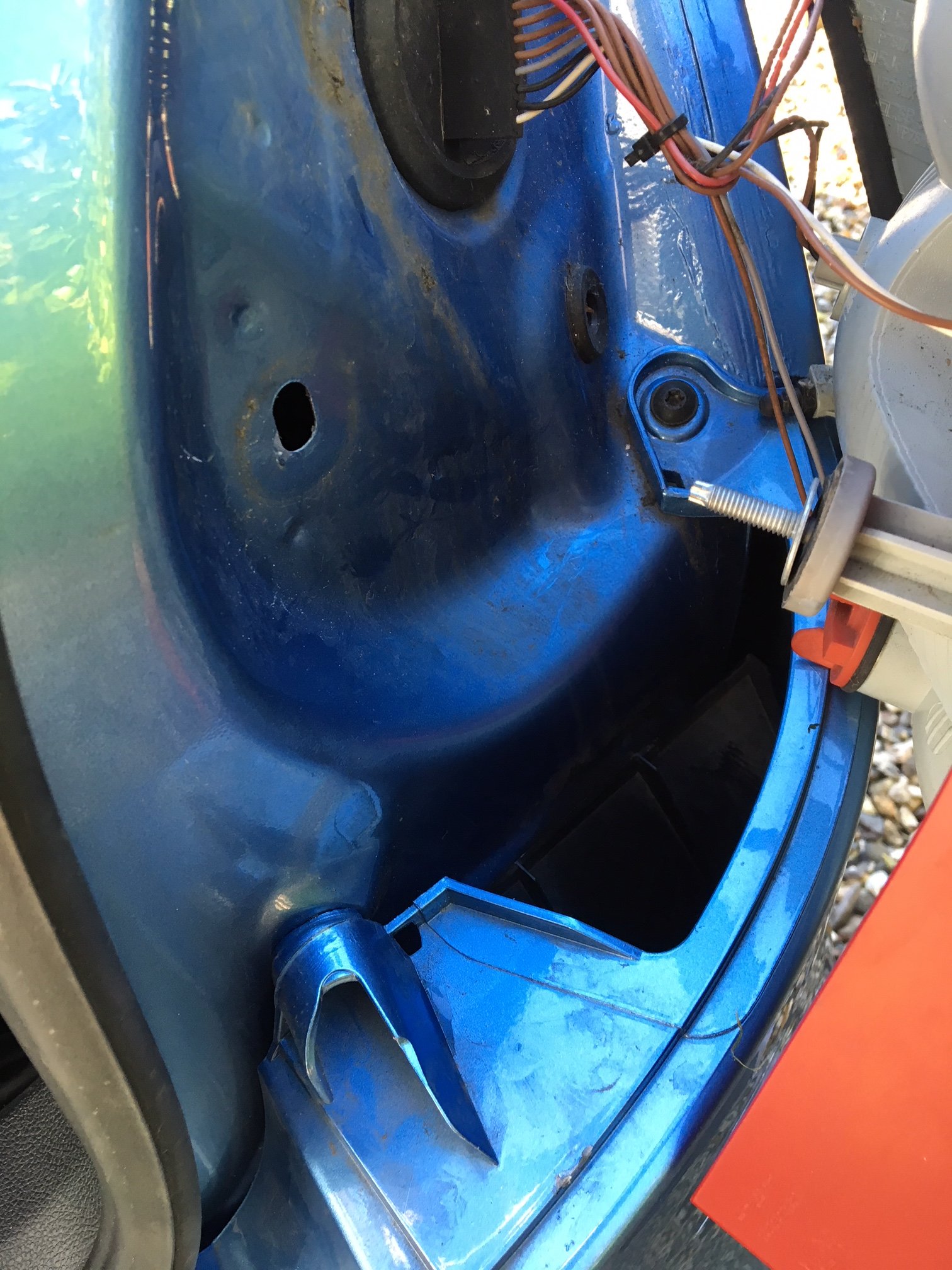

Pull the light clusters out by turning the big plastic bolts inside the boot.

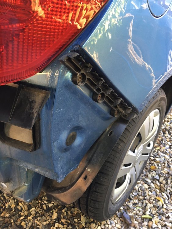

Undo the two large torx screws that normally sit behind the light clusters on both sides.

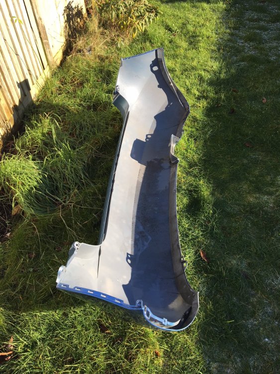

pull out bumper from one side then the other.
done. If you have parking sensors I think you need to disconnect them at this point.
