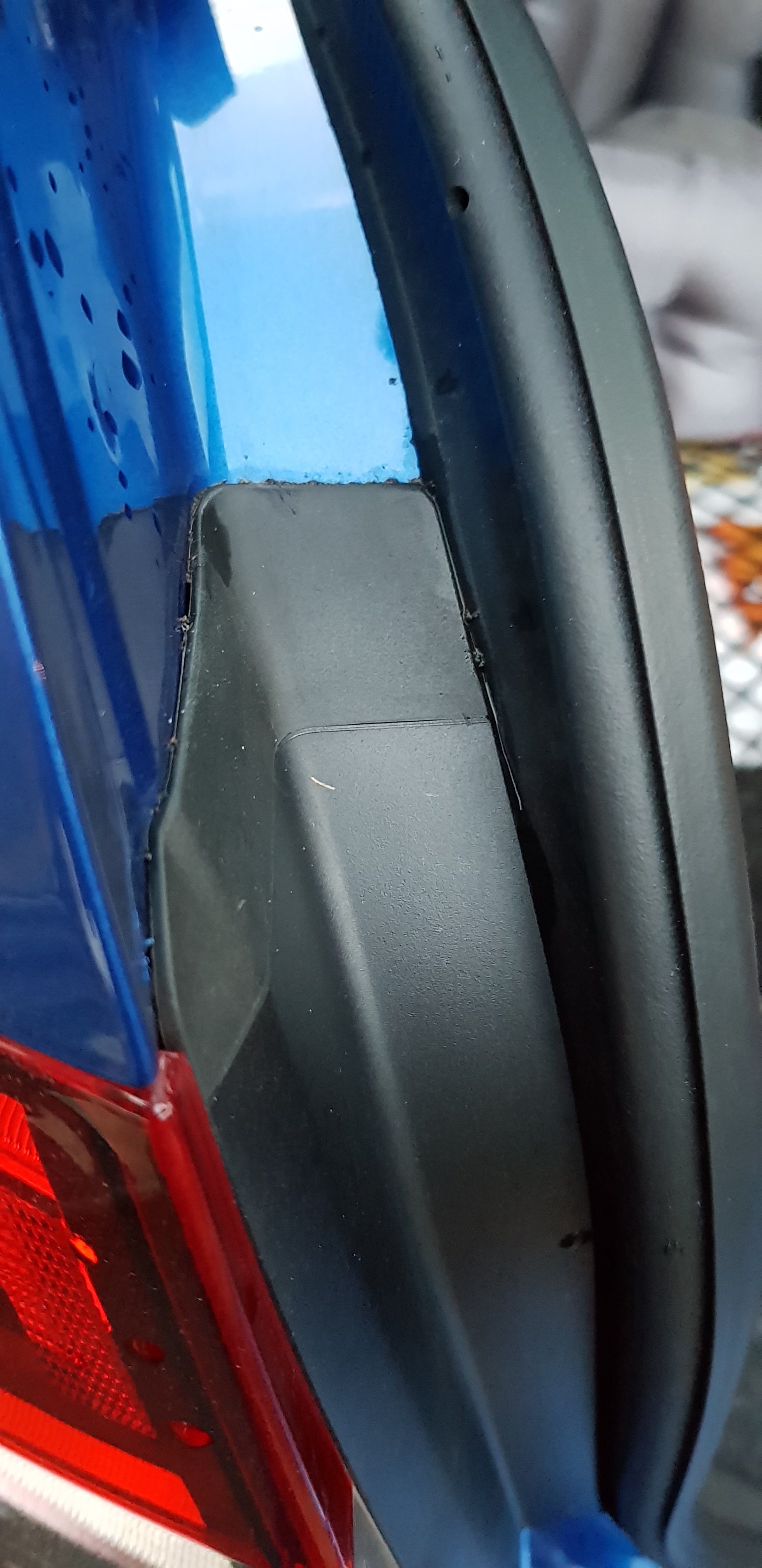

Wondering if a hatch owner could do me a massive favour please and check the black plastic bit that goes between the taillights and the inside of the boot area.
Took mine out a few months ago and not sure if I've put it back the cover correctly. It looks like water can run down the hatch boot edges and underneath the black plastic bit shown in the image. There's also a gap towards the left too.
Wondering if this is right or whether I've done it wrong. Don't want rain water to run into the taillights or into somewhere where it shouldn't.
Many thanks!

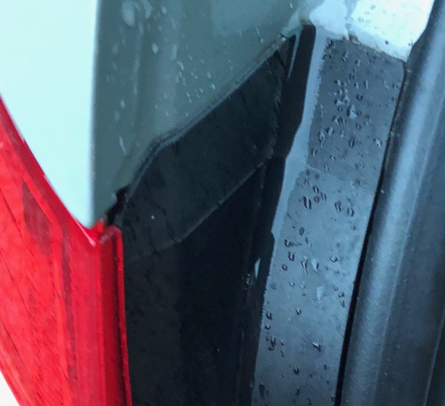

Another angle showing how this is currently. It lines up at the bottom but there is a dirty bit on inside right edge of the taillamp, so it makes me wonder if it's wrong.
If anyone could check and if possible take a picture of the same bit on theirs that would be fantastic and really appreciated!

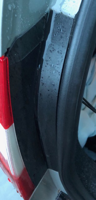

Yes, its like that on mine, poor fitting. Or maybe its intentional, so all the leaves and other garbage can get in and out?

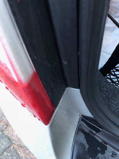

As requested:--
Looking at the shape you can't fit them to the other side or upside down.  In your first photo the top of yours is out at the top, mine seem to be Tucked into a groove on the light cluster. Is that a little lug on the top which fits into a slot in the body work. You might not have the light clusters in quite right therefor not allowing the plastic part to fit properly.
Edited by Auric Goldfinger
@Auric Goldfinger Thanks a lot for that! Really appreciate it! Confirms what I thought, need to have another look as they aren't in correctly! Legend! B)

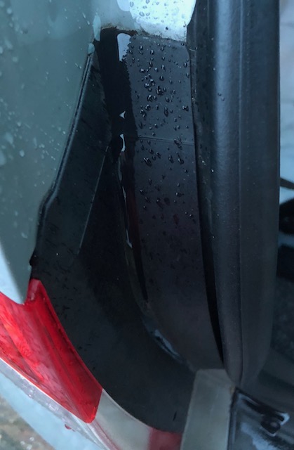

Here's mine. A better fit than yours or Auric's but still not a good fit at the top.
Edited by YMe
Thanks, looks like they might have changed the cover so it goes higher up to stop the gap shown in my pic. In fact if you look the extra plastic is a slightly different colour.

Either way it looks like you haven't refitted it correctly as the cover's edge should sit inside the lens. Why did you remove it?
It’s only a cosmetic finisher in a wet area of the vehicle (Anywhere outside of the door seals). Don’t worry about water getting under it, it’s not a seal and won’t stop moisture ingress in behind it.

The posts and pics from others though have confirmed is that I haven't put them back quite correctly; the plastic appears it should go inside the edge of the tail lamp which I haven't done and there's a bit of dirt gathering in that.
