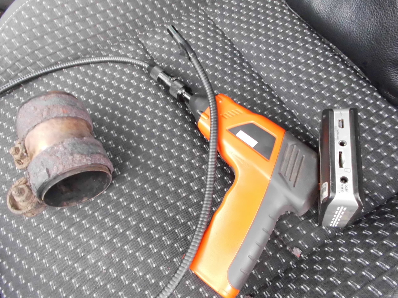

Front Downpipe bracket breaks, and dealerships quote ridiculous price.
Rusted clamp at back of the Resonator box gives up the ghost at 5 years sometimes.  (As picture, £4 clamp)
Exhaust clunks.
Generally many things get loose, you need to look see, have someone look as you rev it a bit.

Ah , brilliant stuff,that sounds highly likely from the sound it's creating. If I put my foot on the throttle a tad, even just 100 rpm above idle  the noise subsides. So maybe the vibration at idle causes this to rattle about a bit. Accessible on jack's you think?
Cheers for the replies guys.
Jack up safely at the front and from passenger side door sill sort of place look across to the exhaust for the clamp.
As to the front down pipe you need under really and a look up with a light to see it.
Some might just get that welded if broken rather than a replacement pipe.
Not saying that is the issue, but worth the checking.
