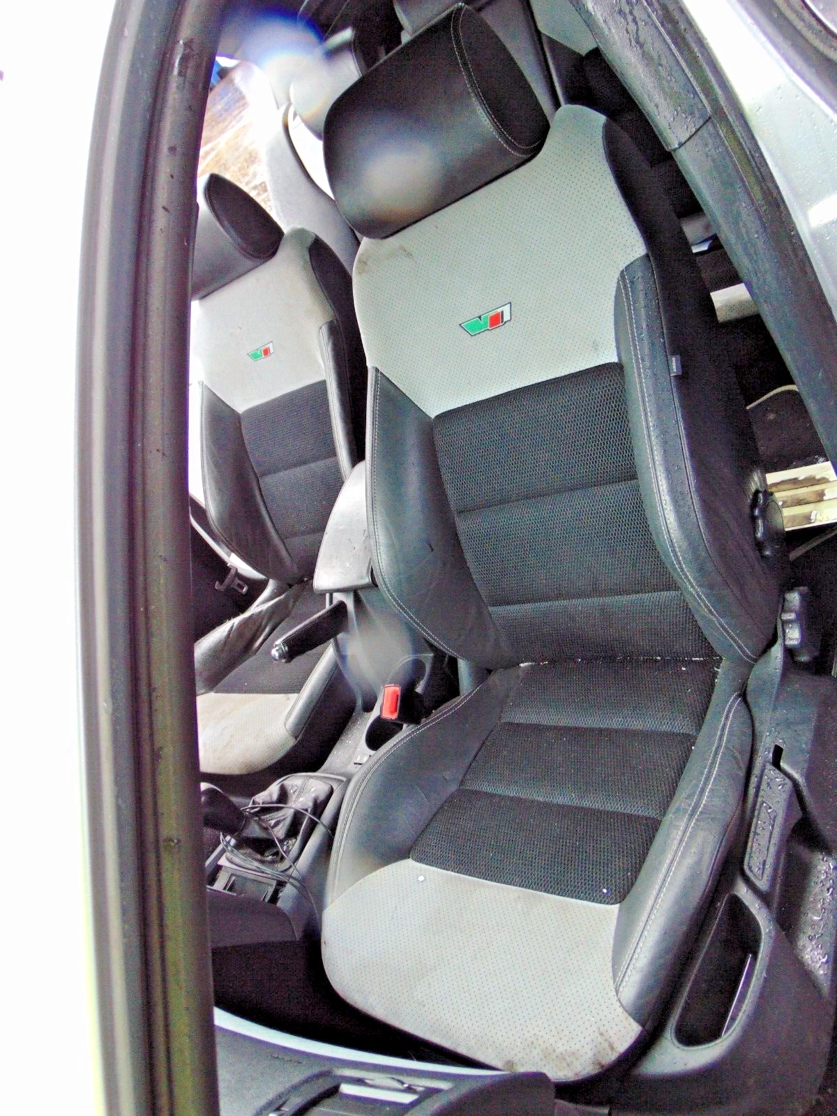

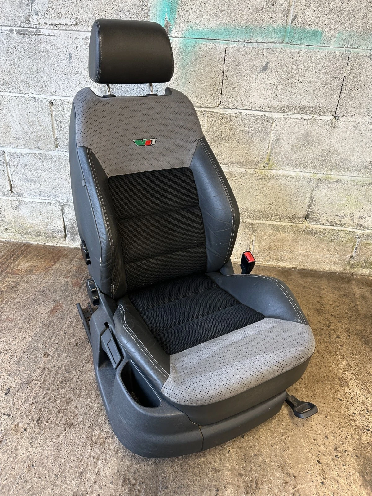

On 05/01/2018 at 13:53, Papez said:
As I've heard, easiest to modify are front Octavia MK2 seats, but even that includes some welding.
The side plastics must be removed.
